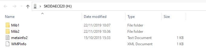

I successfully updated the navigation data on the Columbus from ECE19/20 to ECE20/20 on 11/12/19 as I posted previously. I thought that it might possibly be a help for you, to see the contents of the root directory of the SD card that successfully transferred the data.
Hi Roadbot,
Thanks for the info, I do not have the File WMPinfo, I was wondering if, as the car is 4 years old perhaps it will not update.
Or perhaps I have a virus although computer says NO.  (windows 10 64 bit Version 1909) any help most welcome

Not sure where we are on this topic now but I have successfully updated the map and got it working again. I suspect that the original download which was loaded by the satnav was corrupted somewhere but I shall never know! It was the forum which suggested downloading and trying again so thank-you forum.
Hi All especially Martin B,
Have now successfully downloaded 2020 Map updates (down loading in SD slot one in glove box)
I think the problem was that the card when reformatted was FAT32 and Not NTFS, so I hope that my help others
