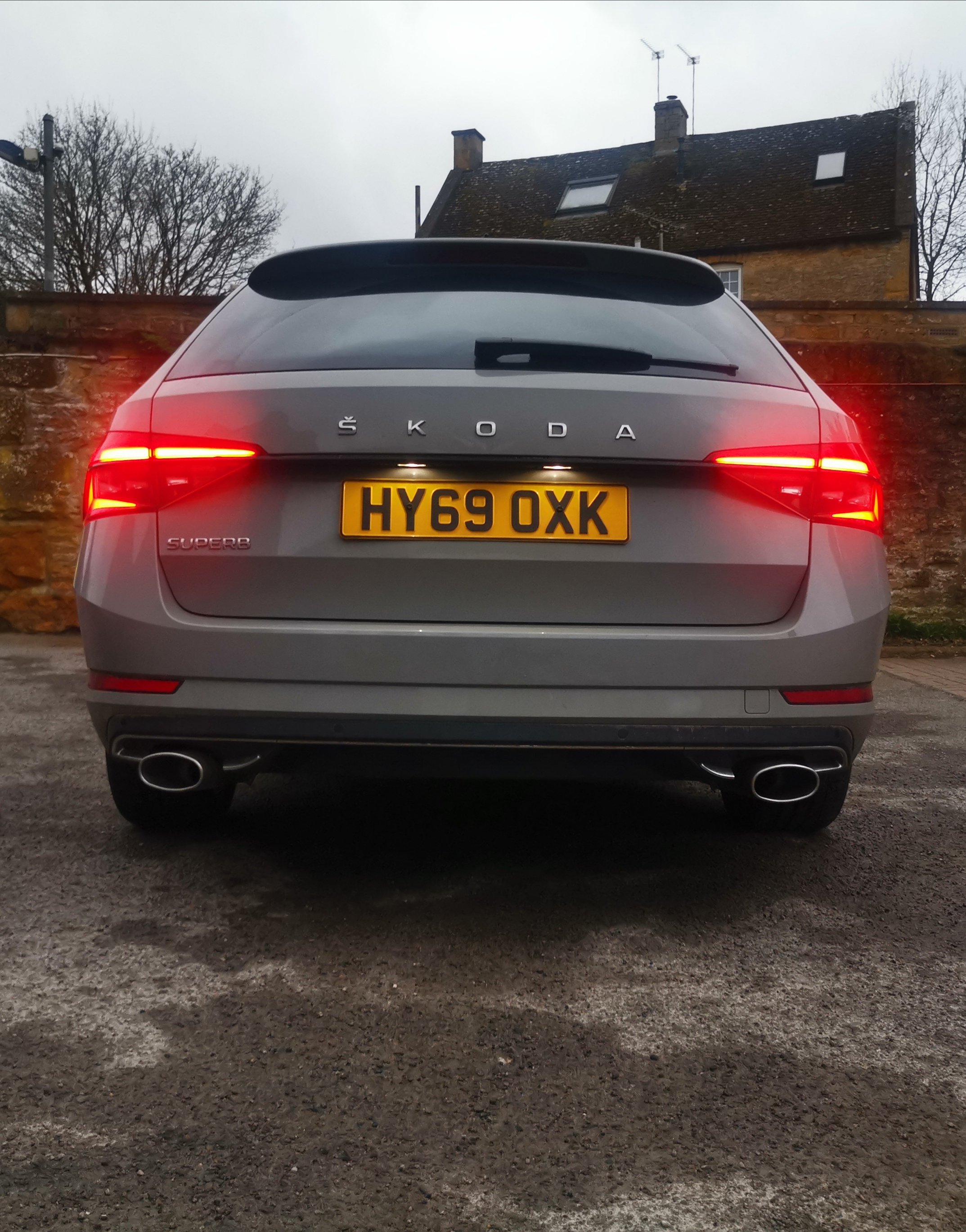

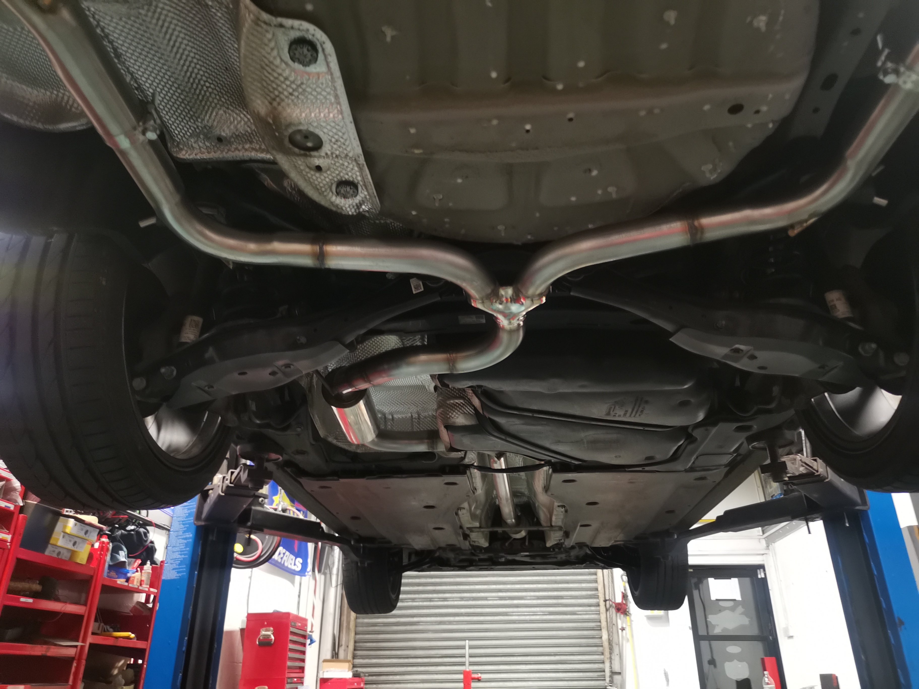

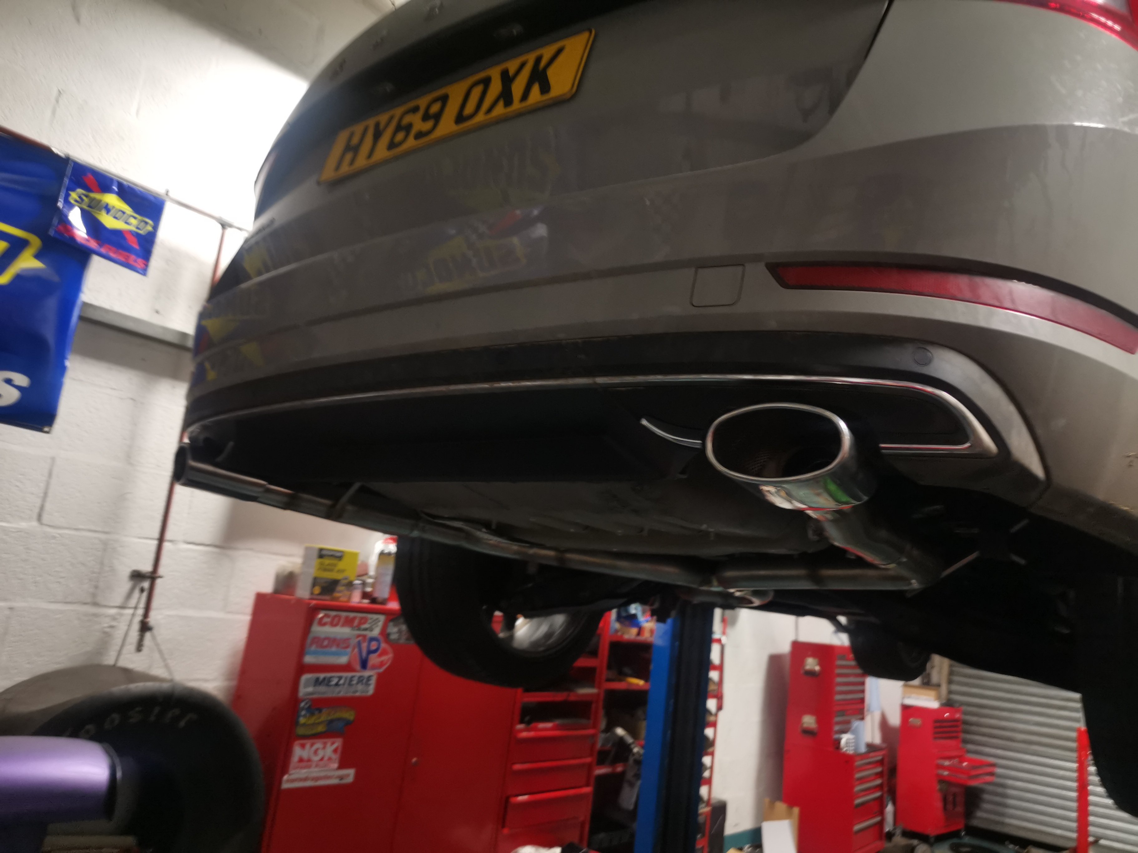

I went for a full custom job from a fabricator near me. I wanted it noticably loud but not OTT and even with no boxes and a tiny res it isn't that loud tbh! It does however drone which I will need changing but thats a job for winter! I went for Rs4 style tips.
Looks great, is that the 1.5 TSI?
Looks great buddy, got video of it at all? How much did that set you back if you don't mind me asking?
It is indeed!

From what I've seen of other custom exhausts, that looks like a very nice job! There's so much space under there to work - especially without the back boxes. Enjoy 😁
