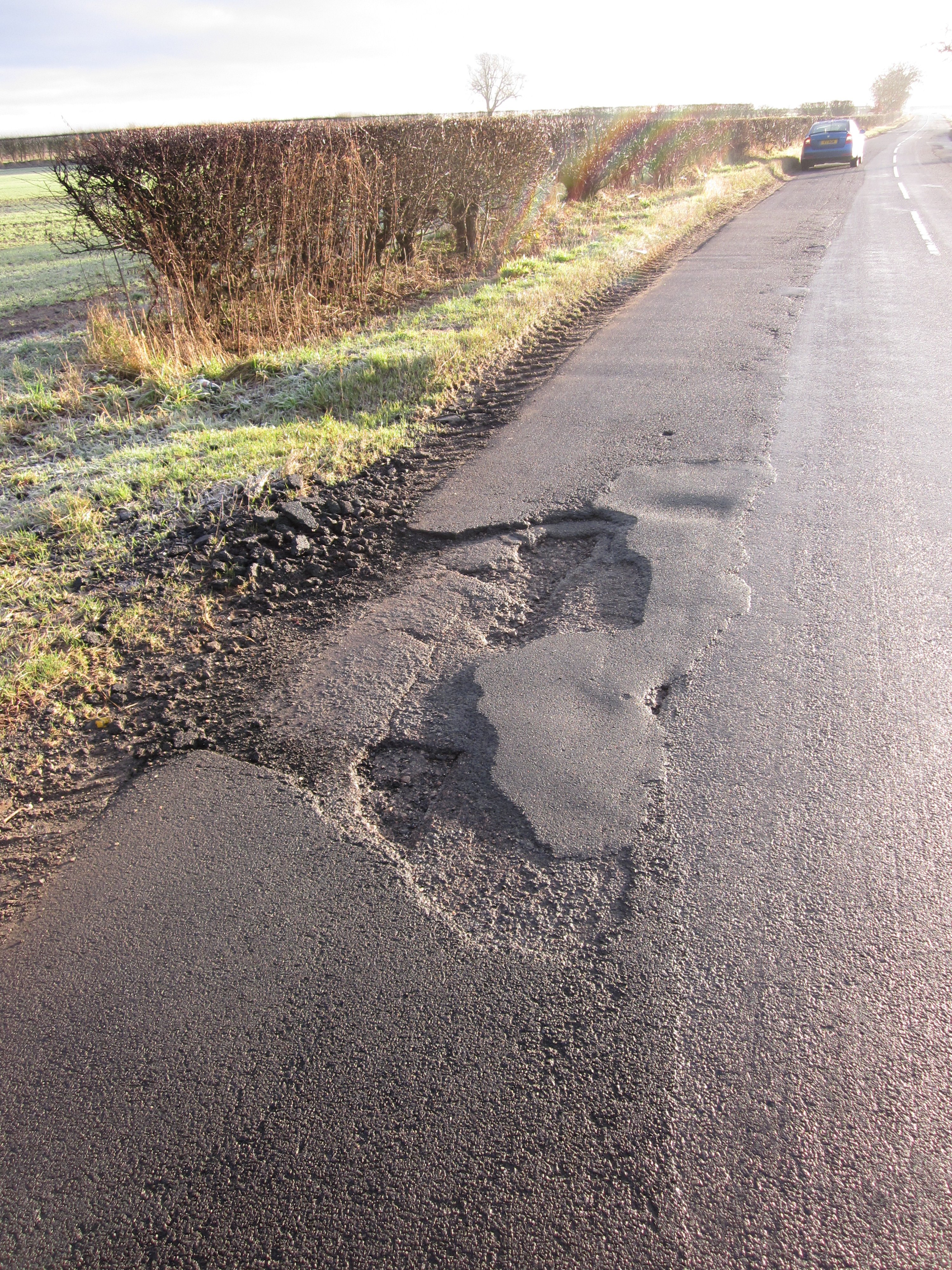

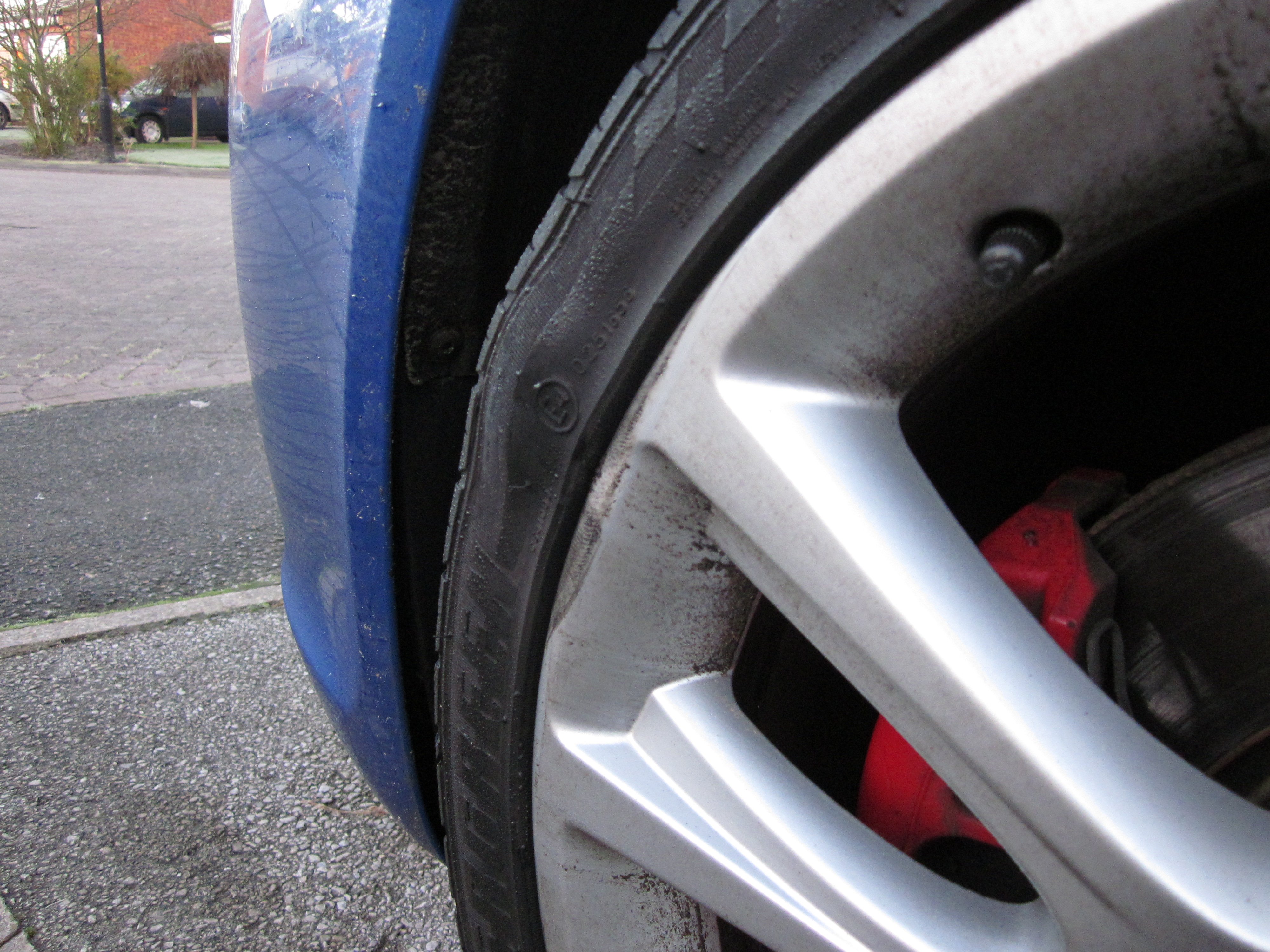

So last night driving in the dark on a country road and hit the biggest pothole ever - massive bang, pressure sensor warning and puncture within about 5 seconds.  Garage inflated the tyre this morning and big hole in the inside sidewall - so no option but a new tyre.
With so many potholes on poor country roads - I'm now worried about the unforgiving 19" Xtremes on the 245 challenge...........maybe I'd be safer with alternative alloys or even a set of steels

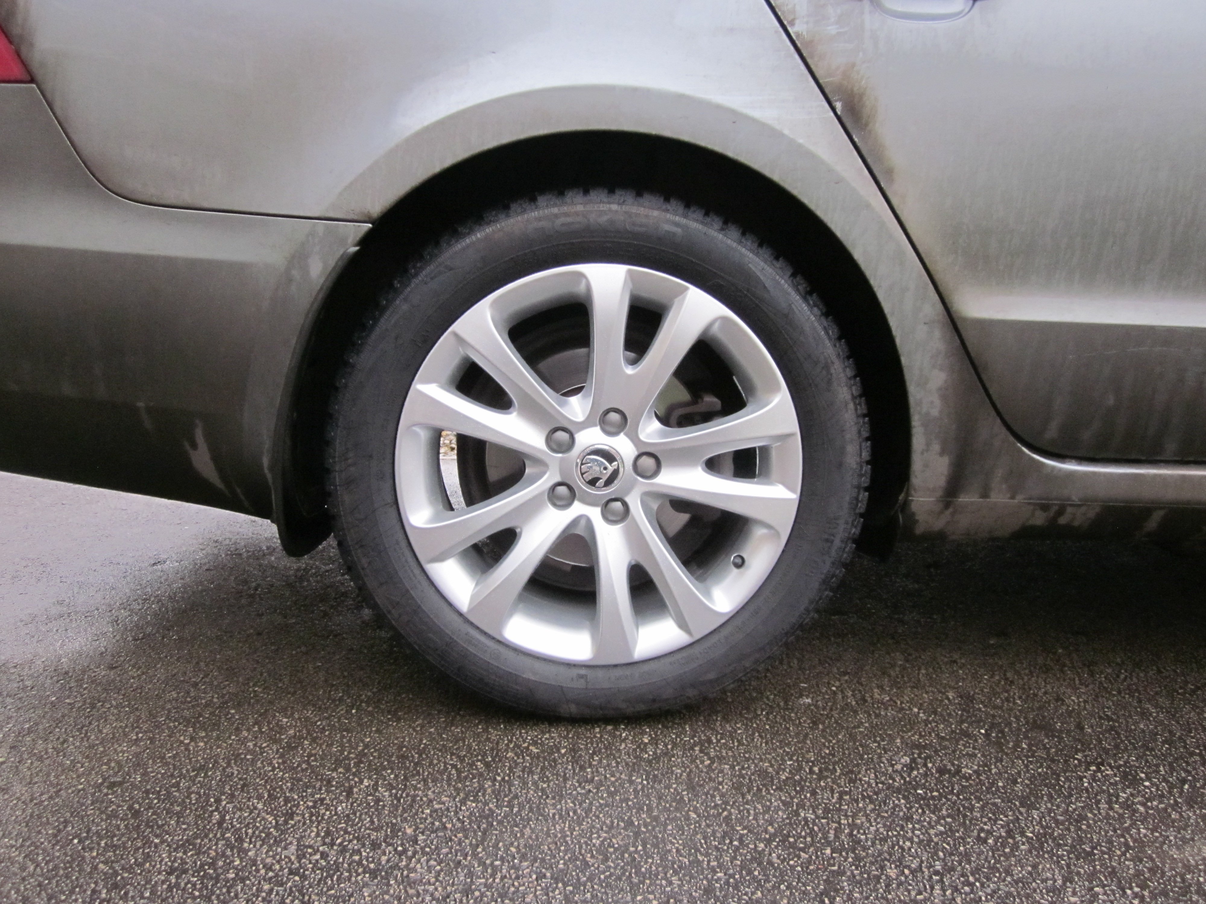

I use 17" Terons in winter with standard-size 225/50 tyres and they fit over the 340/310mm brakes fine, but I'm not sure the increase in sidewall size will do you much use as we hit a pothole in one of my other machines (cleverly hidden by a puddle) and it did the tyre and bent the rim and that was with the mother of all sidewalls on a 235/55

Mytyres list Alcar 9021 6.5Jx17 ET38 5/112 57.1 steel rims for the Skoda Kodiaq. These should fit if you use 205/50R17 tyres. They will fill the wheel arches similar to 225/45R17 tyres fitted to 7.5Jx17 ET49 rims.

I made a typo, that is the Scout size. On the Terons I use 225/45 which is the standard size tyre for 17"
