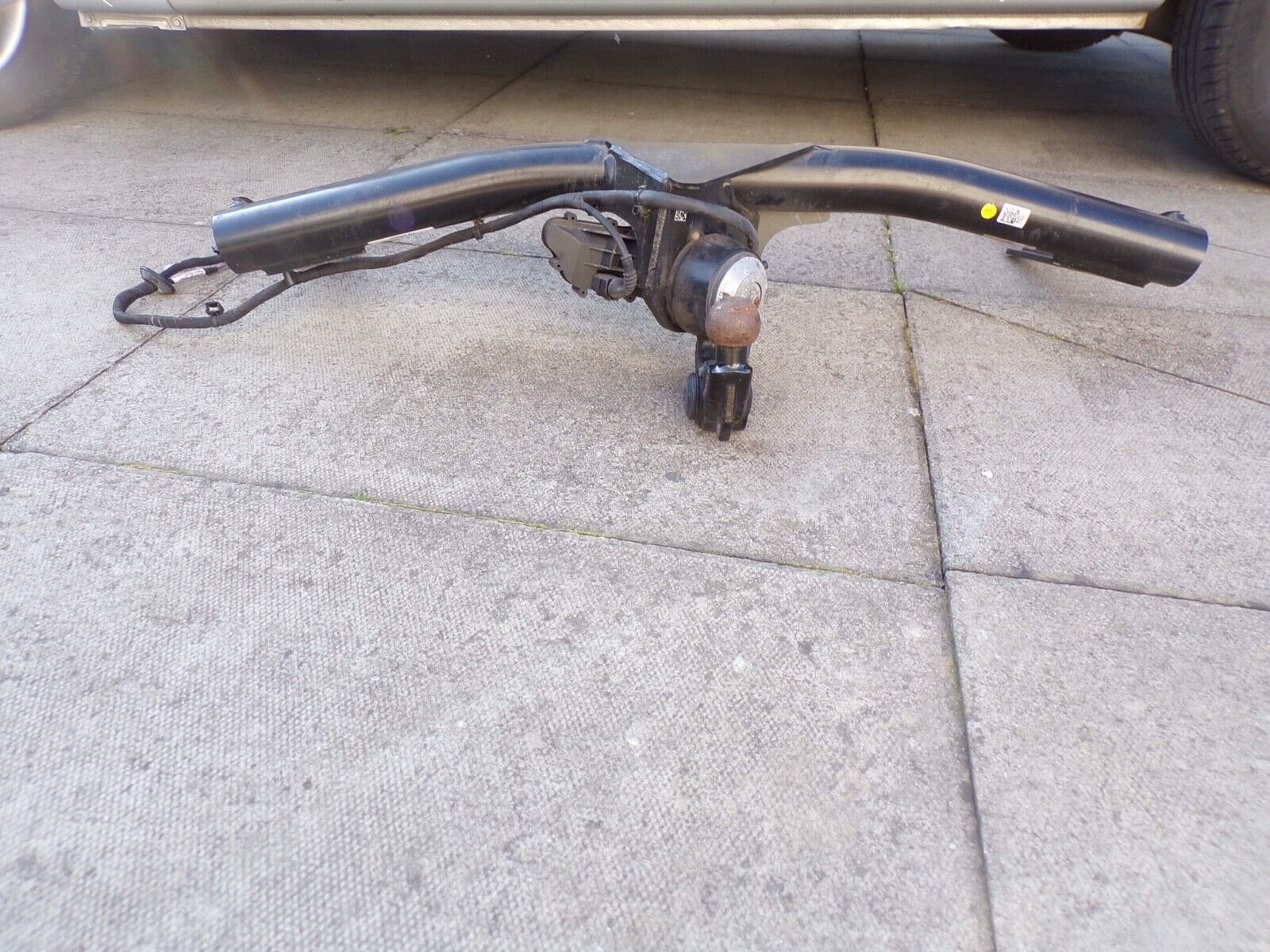

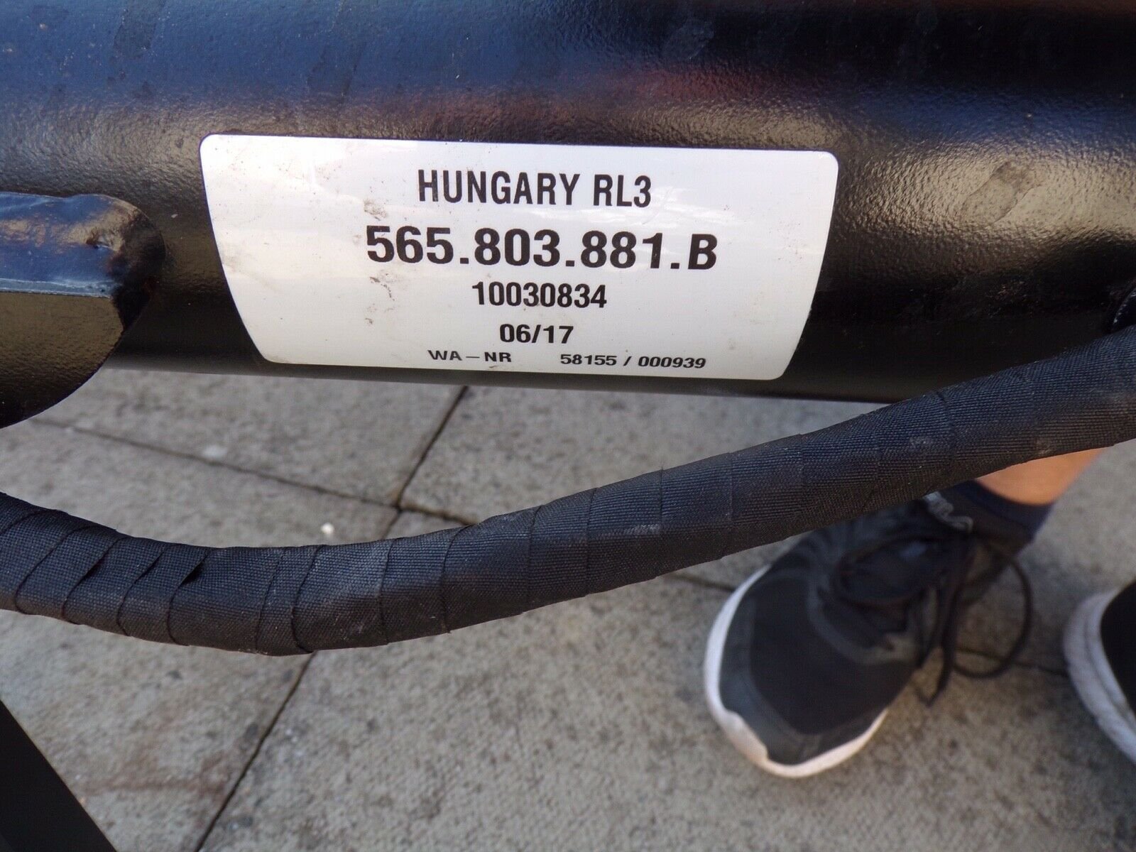

Have someone selling a retractable towbar from a Kodiaq and I cant seem to find a definitive answer on whether the retractable one  (pictured) will fit on the Sportline with the different bumper.  (Rang 2 local skoda dealers, each give a different answer).  Then rang Skoda UK and they actually said you cant fit a towbar on a 7 seater TDI at all, the guy actually said it was because of the TDI engine, so I promptly put the phone down .  (I am aware of the restriction with the Manual gearbox, but mine is the DSG)

What is your question, will it fit?
As long as it is a genuine Skoda towbar for the Kodiaq (which it looks like from the pictures), then yes it will physically fit.
The bumpers across all the Kodiaq models are the same with or without the towbar fitted, the only difference is that if factory fitted a section of the bumper is cut out.
So, if you're looking to retrofit one to your SportLine then as long as you can fit the additional wiring and switch and then get the car properly coded it should be doable.

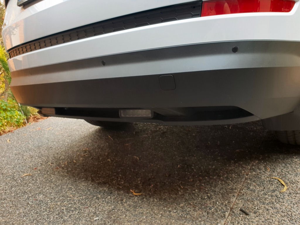

This is a vRS with a non-genuine towbar retrofitted. The fitter cut out the aperture in the bumper...
This is a factory fitted cut-out on a Scout...

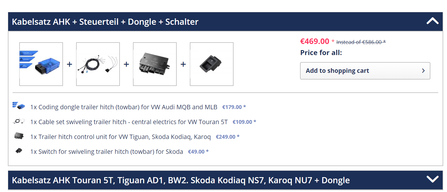

Take a look on Kufatec for wiring looms etc

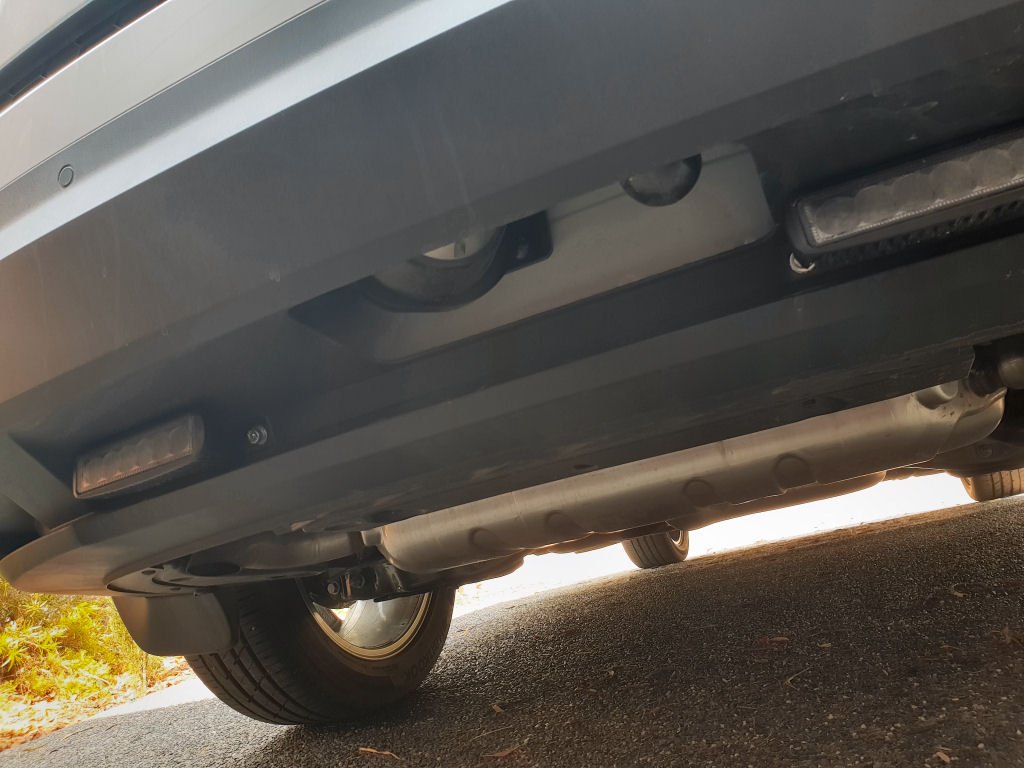

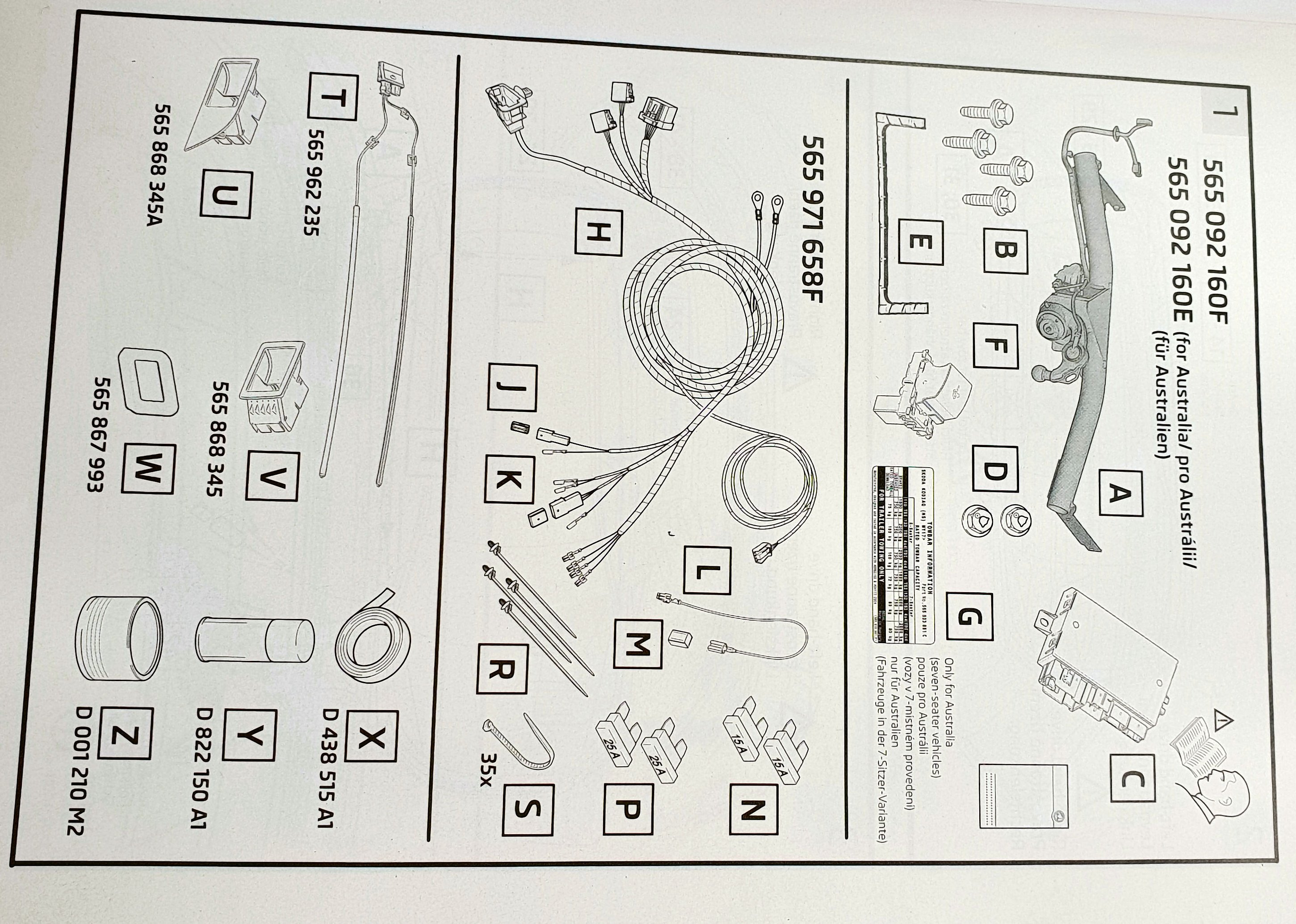

Hi, mine was dealer fit, before the car was delivered.  See 2 pics of the bumper bar with the hole they cutout.  They left this book in the car (pics attached) and it shows some part numbers which might help.  Might be different part numbers as mine was homologated for 'straya and New Zealand.
Car is a MY19 Kodiaq 132TSI 7-seat.
They did an ordinary job fitting it, they mounted the kick-to-open sensors to the wrong part so the boot opened if you just walked past the rear.  I had to take the bumper off anyway to fit the reversing lights and TPMS module so I re-positioned the sensor strips at the same time.
Would it help if I scanned the installation manual?

Yes please the scan of the installation pages would be great if.its not too much trouble.

Any idea what part E is?  Also can you still easily see the individual part number on your tow bar, if so is it the same as the one I have bought (pics in original poat).
The part numbers in the manual is for the combination of the individual parts so hard to tell.

Thanks.  What wiring part number that@wokwon posted in the pic is around 40GBP at the dealers so thats not too bad.
This is Kufatec...

The Engrish section of the installation manual is attached here.Scan_001663.pdf
First bit is the Ikea-style pictographs, 2nd bit is the written instructions.
It's the template for the hole you cut out.
Can't see it sorry as it's hidden by the bumper now.

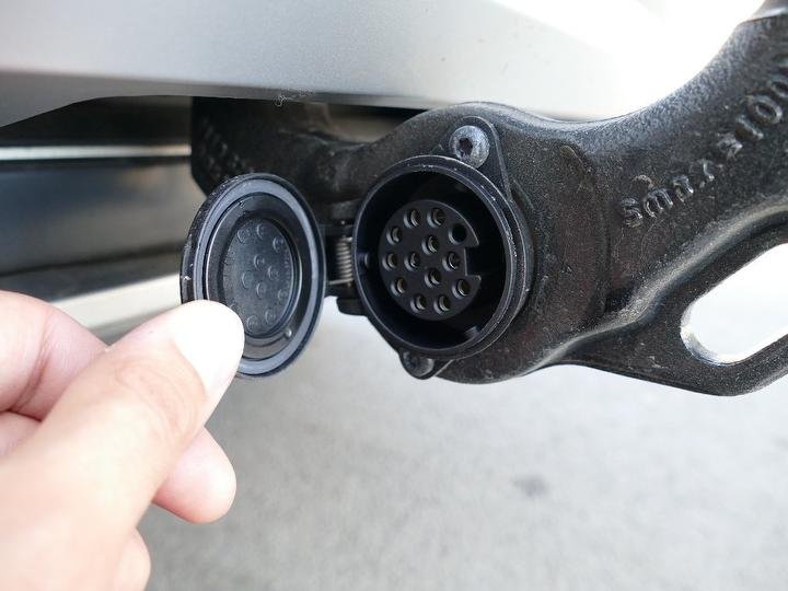

Right, we have got all the bits and the used tow bar is already retracted out.  Before we start wiring everything in, is there a quick way to send power to the towbar to get the hook to retract back. Maybe get a live and earth straight from the battery and connect temporarily to some pins on one of the plugs
