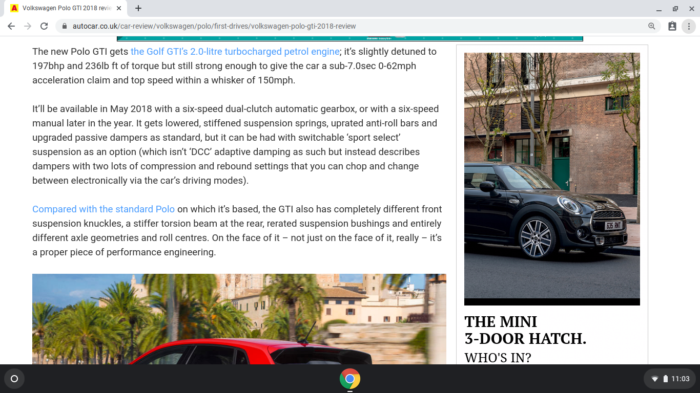

9 hours ago, Roottootemblowinootsoot said:
A 2.0 TSI Polo GTI / GTI+ has.
Not so sure about that. Better torsion beam is one of the improvements touted over the old 1.8 GTI
"Front lateral stiffness is up by 55 per cent over the old GTI, and the bespoke twist-beam rear-axle is 60 per cent stiffer"
Pinch of salt though, can't believe all you read and have not looked under one in the flesh.
Don't know if it is chicken or egg but it is obvious whoever decided what RARB to put on mine was involved in setting the stiffness for the rear torsion beam. They thought having a weak back end on an estate was a good idea. I went from 16mm to 22mm RARB just to make it feel normal. We are not talking wild oversteer here, it just drives without the glaring problem it had from new.
Obviously you can't always translate from one car or suspension setup to another but I would think a 60% stiffer torsion beam would go a long way to solving the problem.
Only thing I can think of is they had to go that weak to avoid some other issue with the handling somewhere else.

@flybynite
You will be right, so i will guess that a S1 had.  Might as well be wrong twice.

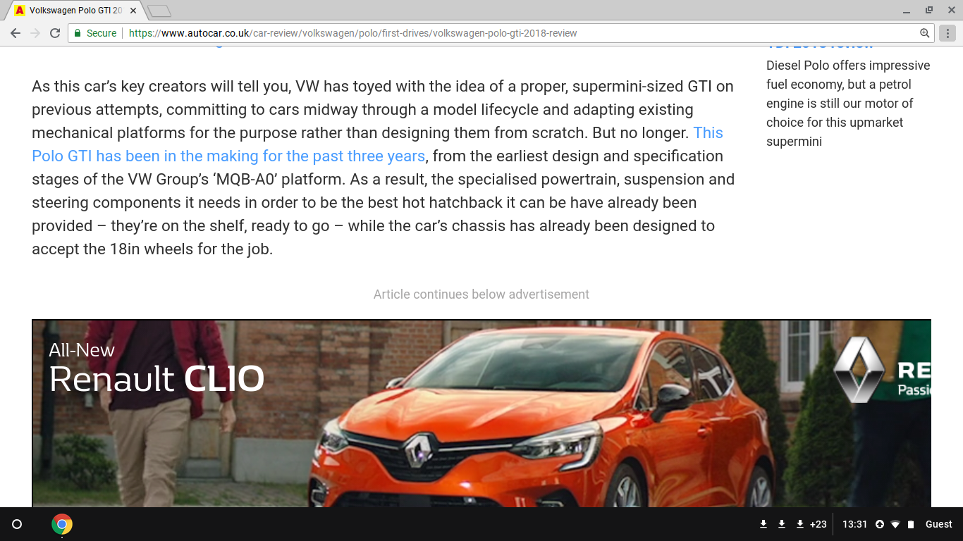

2 hours ago, Roottootemblowinootsoot said:
@flybynite
The S1 was on the old platform and was 4x4 from memory so I think was IRS.
Yes it was the platform for the Fabia, Polo & Ibiza that got a bit of an unpdate in 2014 then modified to be AWD
