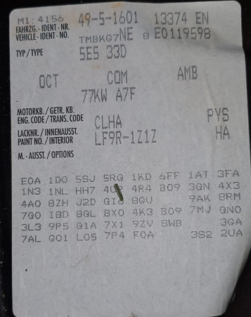

Please see attached Specification sticker from the boot. It is a black magic for me, but I am hopping that someone will help me.

Thanks for your answer. how do you know that my Gearbox type is DQ200 ?
I don't for sure without seeing the car and investigating.
You have the 1.6 TDi with 77KW / 105BHP?
If so likely to be that one since that is what is offered in the range.
i think i have 77KW engine , it is so hard to find out what to do with that Oil . . . thanks for helping. maybe someone else have other suggestions how to check it  . . . .
Pretty sure the only 'sealed for life' box is the DQ200 and it is the usual box for lower powered cars.  Without looking under the hood most on here would put money on it being that box.  Officially it has no change frequency.  However, the only dry bit is the clutch.  The gears and I think actuators still use oil so a periodic change would be wise depending on how long you intend to keep it.
i can look under the hood  by my self but what do i looking for ? can you guide me pls? am i looking for plate ? number ? shape ? appreciate your help

@MikiBal    A 2014 Octavia with 77Kw and a 7 speed dsg, means you have a DQ200.
