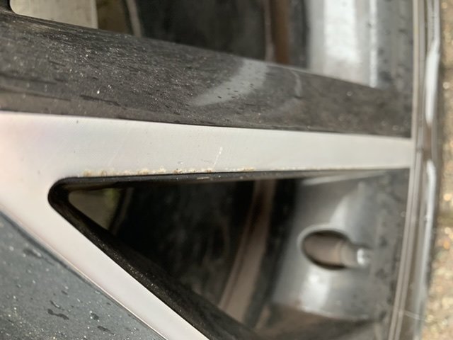

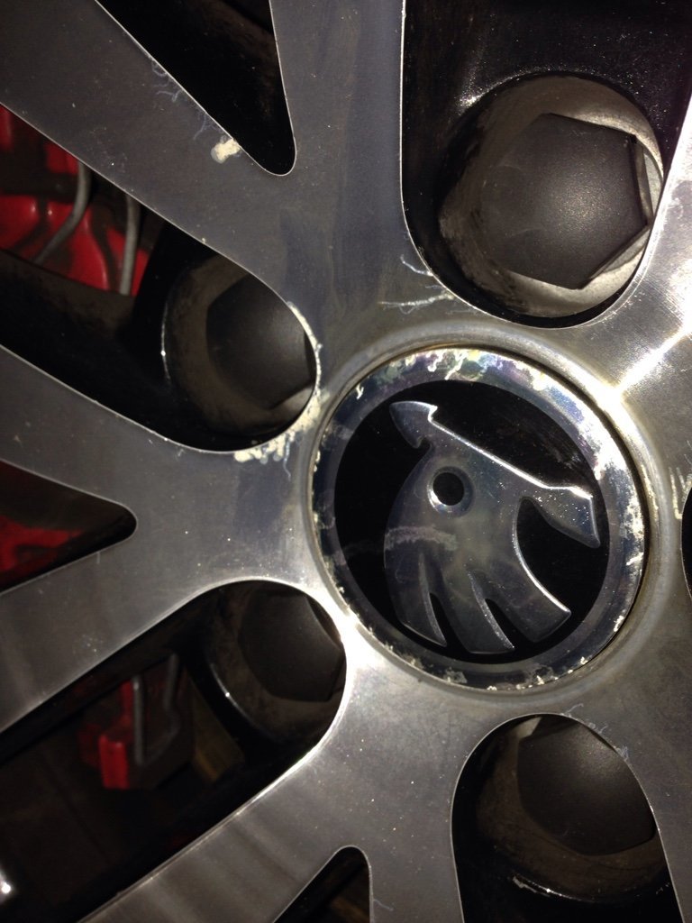

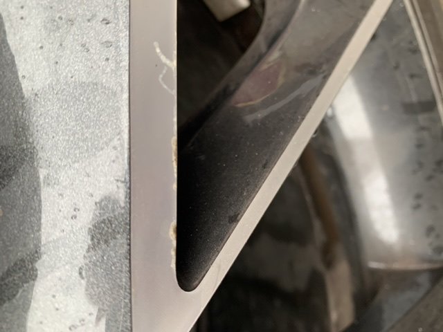

Having just washed the car, I have just noticed that two of the alloy wheels appear to have started to look like they have a blister?  Ir doesn't feel raised... Both are on the off side, but the offside rear is worst.   The car is a Sportline with the 19" and not a year old yet. :(. I had the car with the external and internal dealer autoglimed and always use the dealer wash stuff.  These are washed by hand and never had them pressure washed.
Anyobe else seen this?

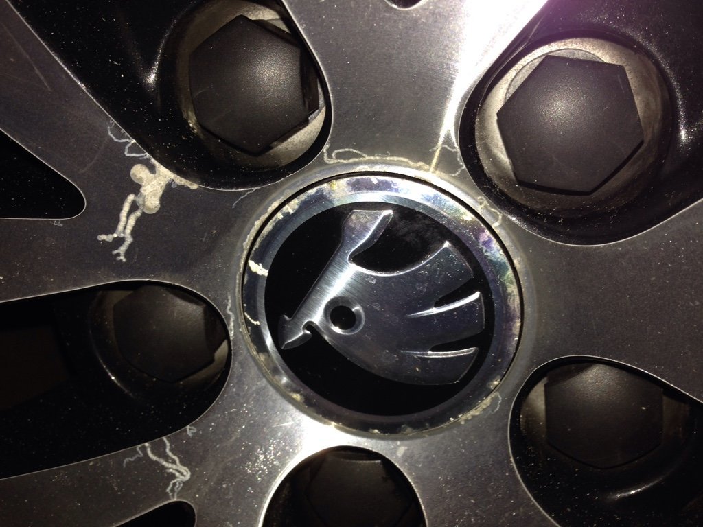

Sadly a very common issue with Skoda / VW wheels over the years.
Keywords Briskoda chrome alloy corrosion  or Briskoda Chrome Alloys 'White worm' corrosion.    will bring up the threads..
Looks like the classic white worm where moisture gets under the clear lacquer applied onto the surface of the diamond cut finish (sorry about the underlining stupid computer) Unfortunately this very common with this type of finish you may struggle to get any joy having them replaced under warranty but worth a go.:sadsmile:
As above the same thing happened on my Octavia Scout the dealer said it was the way I cleaned  them but after a bit of of “discussion “ they did replace all four under warranty
Typical with all VAG products - I've experienced this on every VAG product I've owned ( since 2007 ) although it's always occured on the plastic wheel centre caps. Haven't seen this on their alloys for ages.
I’m still surprised manufacturers persist with these types of wheel which are so susceptible to moisture getting under the lacquer and corroding the alloy,after 3 years ALL my yeti  ORIGAMI wheels (chose the right name there Skoda) were suffering terrible delamination  ,when I booked the car in for a service they looked over the car first and advised me to report it but as a Skoda customer I new they would only pull  out their the book of excuses,I just think if they are going supply these type of wheels they should expect these results.
This isn't just a Skoda / VAG issue, it is an inherent weakness of diamond cut / polished alloy wheels.
I've had several replaced under warranty over the years, but it is a design flaw, so it'll always return.
Stone chips, especially on the leading edges of the spokes is the usual culprit, and guess where Skoda put the joint between the painted and polished surface i.e. the weakest point?
Yep right on the leading edges of the spokes. Plain stupid.
Once it is out of warranty / looks terrible / results in the tyres not holding pressure (delete as applicable), then get them refurbished, but fully painted or powder coated, forget the diamond cut.

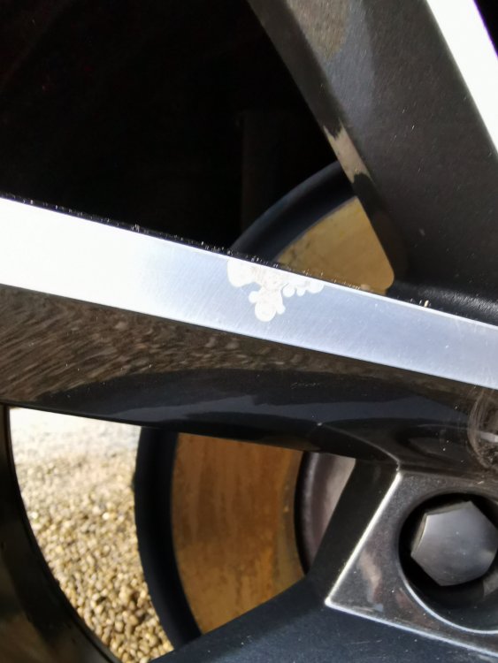

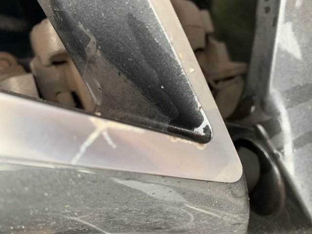

Sadly looks like I’m in the same boat as others here with Sportline alloy wheel issues. Not impressed they look like this after less than 7mths of ownership. Anyone had any joy with repair or replacement under warranty?
I've looked at a lot of diamond cut type alloys and it's not just a Skoda problem its a general problem and doesn't matter how expensive the car is, those sharp edges are so vulnerable to what the weather throws at them and as soon as the water can get under the lacquer they are gone in no time.

Regardless of manufacturer, I've always had them replaced under warranty. There's more than enough evidence out there to make the case it's a manufacturing defect.
The only people I had a battle with over this was Ford who didn't imply it was my fault rather kept saying their warranty didn't cover alloy wheels. That may have been a matter of fact but there was still something called sale of goods act ( or at least that's what it was called when I had my Ford ). They sold me a product with a known fault - end of.
After much dialogue passing between us, I sent them the repair estimates and said I'd recoup my losses via small claims court. And then hey presto, they still wouldn't admit any liability but replaced both alloys "as a gesture of goodwill".

The simply fact is that the concept of the diamond cut wheel is in itself a design fault. Unless the sharp edges are softened it does not matter how they are painted ( conventional spray or electrostatic powder coat ) the paint will always be half the thickness on those edges which makes it vulnerable to damage. This is because paint pulls back from sharp edges by surface tension and can even leave microscopic flaws. Add to this the abrasion they receive from airflow and grit whilst they are spinning  is a recipe for disaster. If you study diamond cut wheels on any make of car the only ones which bare no scars are those which do not have a sharp edge between the coloured section and the diamond cut surfaces. My friends 2016 Lexus wheels were shot inside 12 months but Lexus were happy to replace them ( in fact whilst the car was in for service they advised him of the problem and assured him they would be replaced ) the only problem was that 18 mths later the new ones looked just as bad.

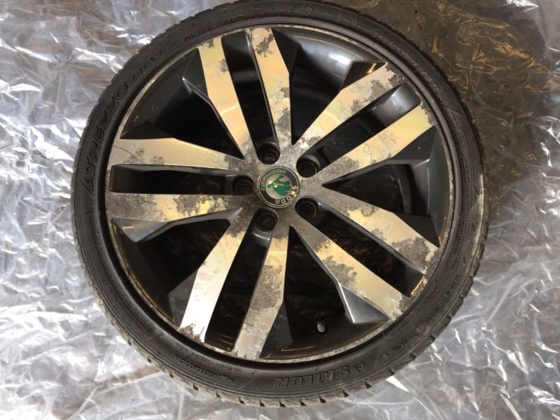

I had Dark Chrome Gigaro Alloys replaced under warranty but the wheels had to go to the Skoda Dealer to have the tyres changed.
They slightly marked them when on the bead breaker or the Tyre fitting centre they put them to did.
As soon as i had the car home the wheels came off, got washed with tap water and stored in a dry shed. Unheated,
They were suffering white worm by the time i got around to selling them, just the same as New Take Offs that i had stored.
Wheels not fit for road use and environmental conditions without corroding in a few months are not fit for purpose.

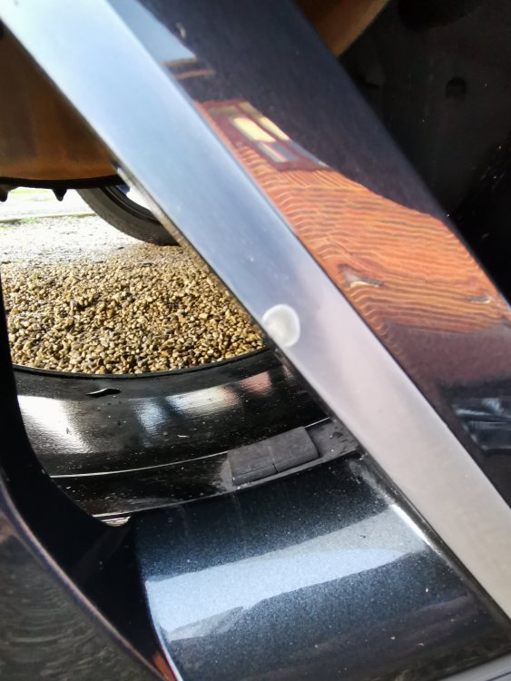

Top wheel not mines thankfully.
2nd one as it came from a Skoda Main Dealership doing a warranty replacement.
(Weights added, weights removed by fitter.)
Ready to start having 'White worm' again.
Bottom picture.  That is Job done.  Just the edges to kerb...

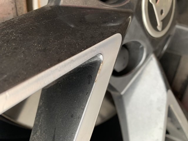

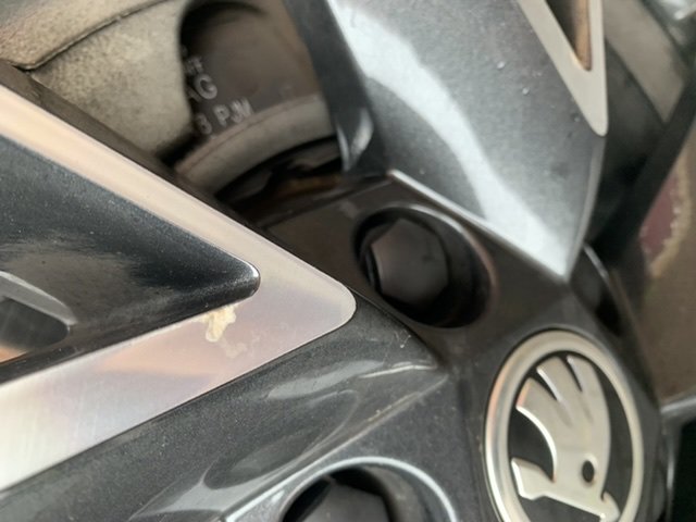

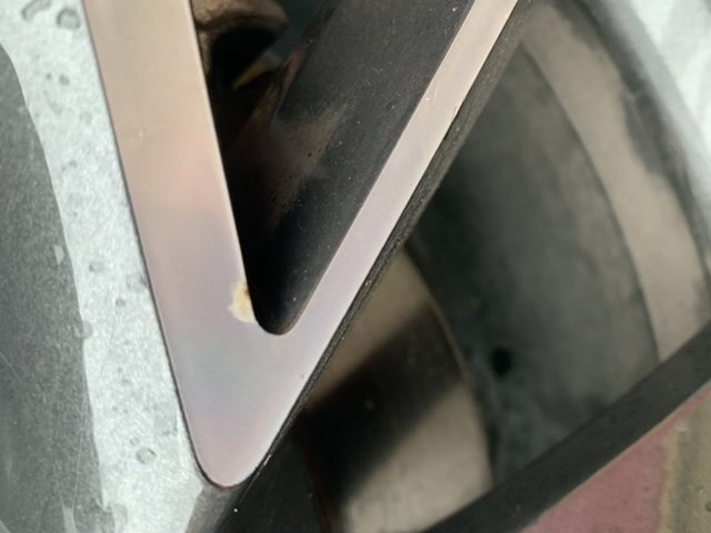

Mine have just started going on 3 wheels  on a 2019 karoq sportline with just over 9000 miles covered , it is in for a service this week so have raised the issue and going to try under the warranty hopefully, the back 2 have no curbing damage etc but have just started blistering the front have a bit of curbing but bad blistering nowhere near the curbing though
Whilst you may be able to argue that the kerbing isn't related to the white-worm, if Skoda UK do agree to replace the alloys under warranty they might still ask you for a contribution to the cost due to betterment.

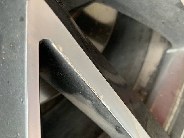

I have now raised my issue with my dealer as my car is going in for first (20k) mile service in a week or so.  They have taken my images and will "see what we can do"....
I will update....
It is true that there was a period in time where Skoda were replacing white wormed alloys with refurbished wheels, albeit supposedly 'factory' refurbished wheels.

As I have said before several times, diamond cut wheels are bad news. You only have to walk round any carpark to see no matter what make, it is the concept which is wrong and those sharp edges only serve to reduce the thickness of the lacquer as it pulls back whilst drying. Those same thin edges are exposed to all weathers and road abrasives so they are just 'Bad News'. Fully painted alloys are the way to go every time.
