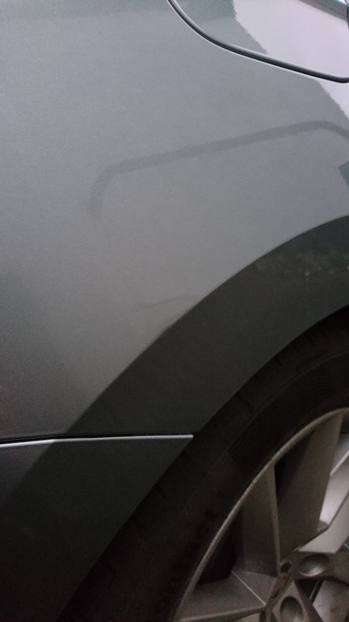

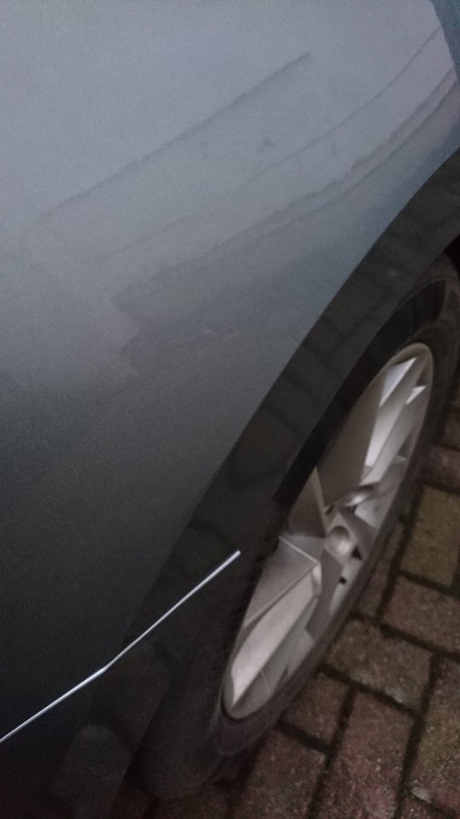

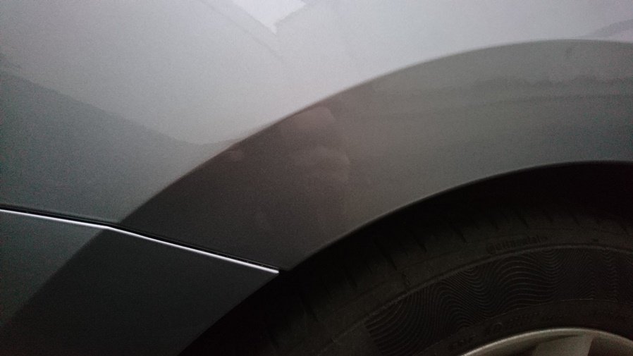

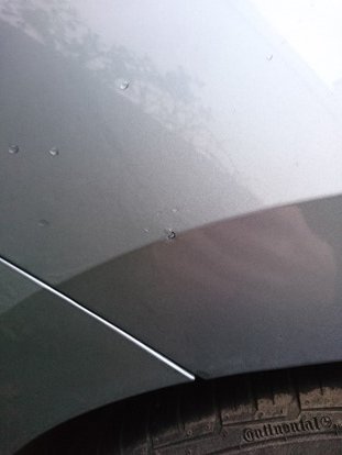

Update:  Been back to bodyshop this morning and he says he can see what I'm talking about so has booked me back in for next Tuesday to see if he can get it better.
Photos attached below if anyone interested for future reference etc.
Photo Before......
Photos After....
Surely the work should have been checked to see if it was done properly in the first place, if not it should have been done again and the statement saying  " to see if he can get it better."
doesn't hold much confidence in his work.
Just my thoughts..................
I must admit, the same thing did cross my mind, but this is a high end bodyshop with a seemingly great reputation.  But when I got the phone call to say the car was ready it sounded like a junior/trainee.  I could be wrong but I did wonder afterwards if it was a less experienced person that did the repair and maybe the person I'd originally spoken to was more focused on some of the other more high end work they have, as they do a lot of work for local dealerships including Bentley, Mercedes, BMW etc. which are all on their doorstep.
Even if the work was carried out by a Junior or a person learning the trade the work should have been inspected by a senior member of the staff and signed off by him.  All cars should be finished to the same Quality wether it be an Aston Martin, Bentley or a Ford Focus

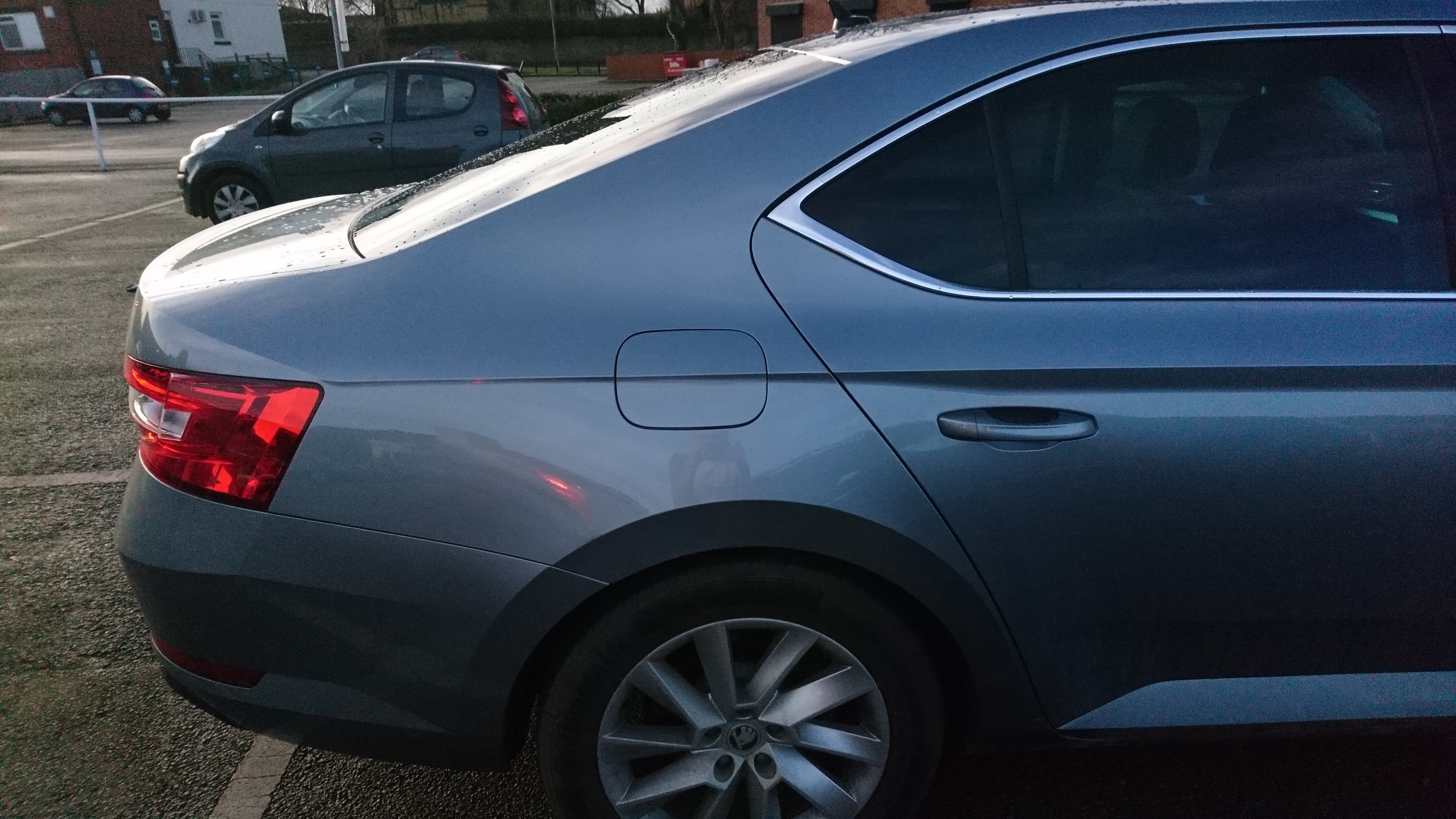

 Can you post a pic taken from further away? To show the back 1/4 of the car IE: Damaged panel, door and roof ?
A proper repair would be "invisible", and indistinguishable from the rest of the car. The finish on your car is called " Clear over Base".  and it's a metallic color. Being metallic means that when its being sprayed on to the repaired area, it has to be done in stages, in ever wider areas, and once the primer has been covered 100%, These coats of color will also become increasingly thinner and thinner, until it will be mainly thinners being sprayed on to the panel. This is called "Blending in", so that it becomes impossible to tell where the new paint end's and the original paint begin's.  Then come's the clear coat.This is what gives the glossy sheen on the finish. ( The base or color coat is completes matte...absolutely no shine at all )   Because it's metallic...you cannot paint a complete panel ( IE a single door, for example ) and expect it to blend in . You have to "fade out" the color onto the adjoining panel's. In  your case I'd say that the line running all along the side of the car (above the door handle, and through the fuel door) will form a natural line for this repair, meaning that the side of the car will be masked off from that line upwards along the 1/4 panel and rear door. This masked off area will be completely sprayed with clear coat, and if done correctly, it will be very nearly impossible  for the ordinary individual to tell the difference ( Professional's generally can tell when a panel has been repaired / repainted )
