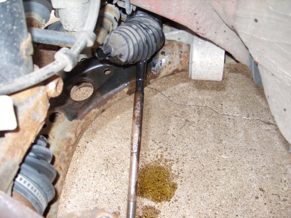

The racks tend to leak past the rack end seal on the passenger side and the fluid leaks into the rack gaiter where it's not always obvious. I only found out that mine was doing this when I was changing the rack gaiter. I topped the fluid up and it's been fine for months now, so maybe it's been leaking very, very slowly over a number of years. Of course, if it gets worse I will need to replace the rack.
This is what I was greeted with after cutting the old gaiter open...

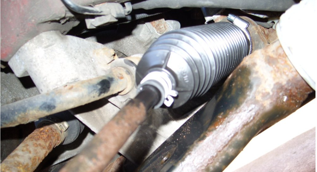

After new gaiter...
