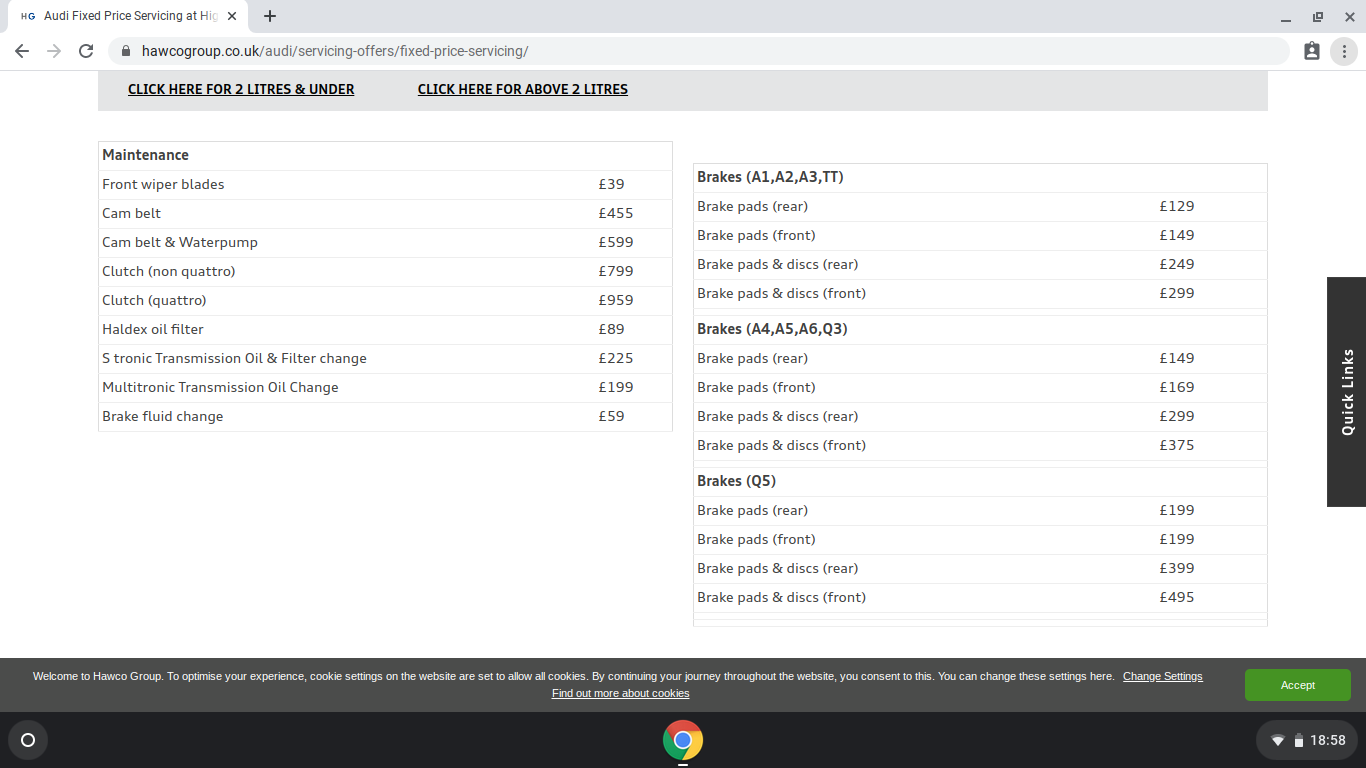

Is the DSG dual clutch in the Superb?
Dual Dry Clutch DQ200 in a 1.6 TDI.  So no Oil Change required.
Wet Clutch in 2.0 TSI's or TDI's.
Audi s-tronic Oil & Filter change Fixed Price & participating dealers is £225.
Note that is Oil & Filter where that applies.

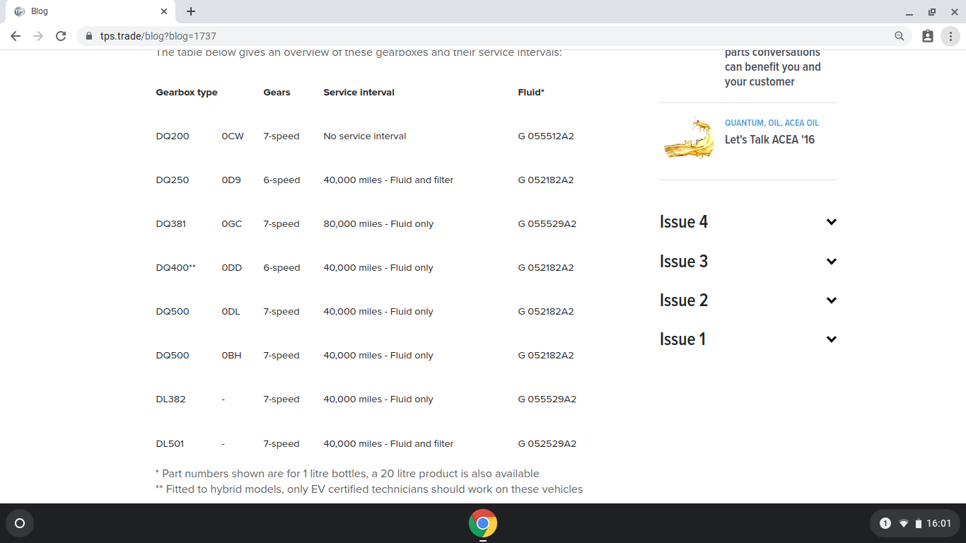

18 hours ago, silver1011 said:
The problem is the £189 is the DSG oil only, it is advised to replaced the filter too, where fitted.
A clogged or partially blocked filter starves the oil supply, so even fresh oil is pointless at this point.
Is that true?
I thought  even Skoda replaced this filter as standard
I know they dont changer the haldex filter as they dont even have a part number for it (even though it is there)
You need to be sure when there is a filter to be replaced in a DSG that they are replacing.
Assume nothing. The person at the Service Desk or on the end of the phone likely does not know.
