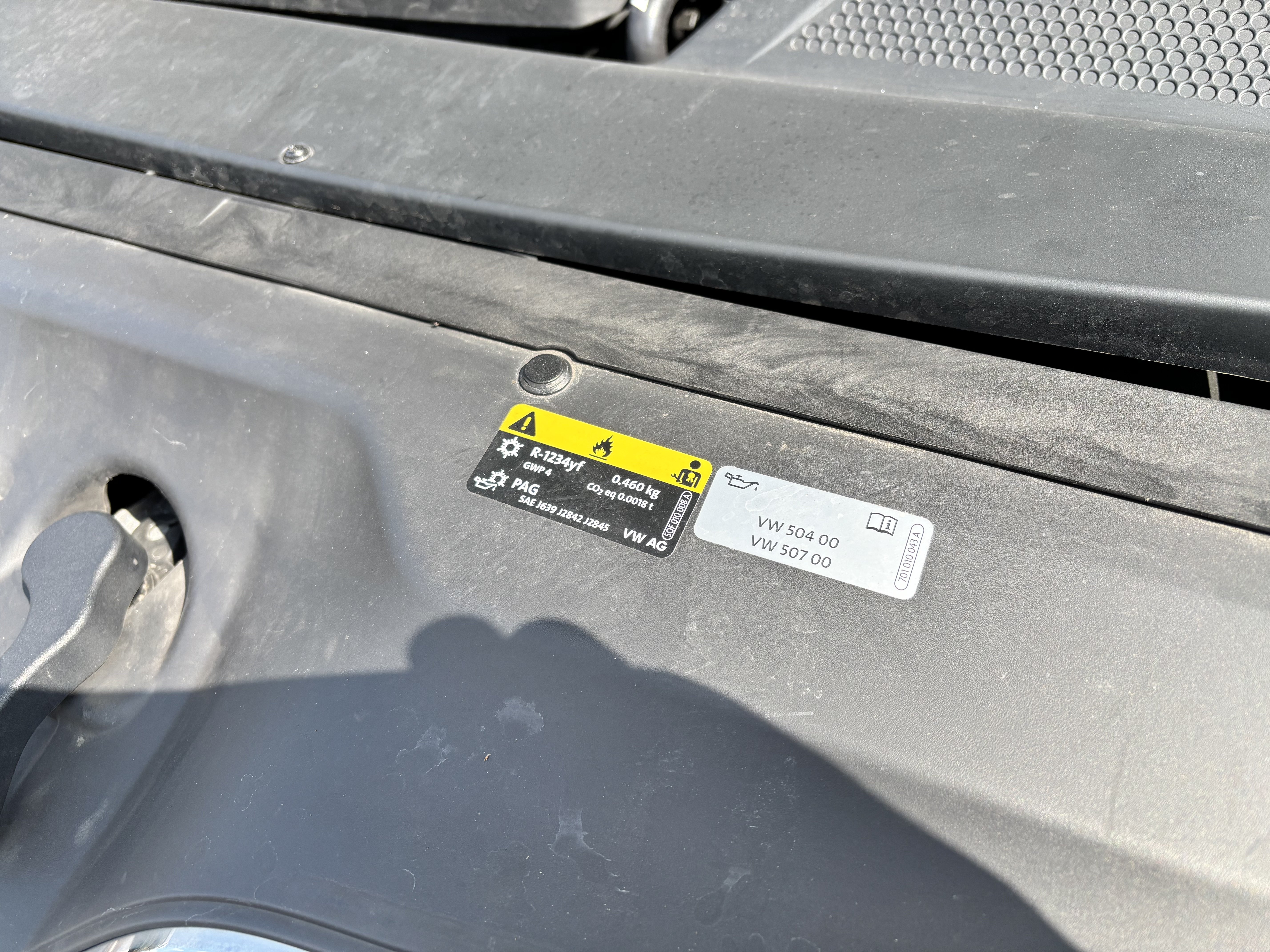

1 minute ago, s88urd said:
Just near the bonnet catch

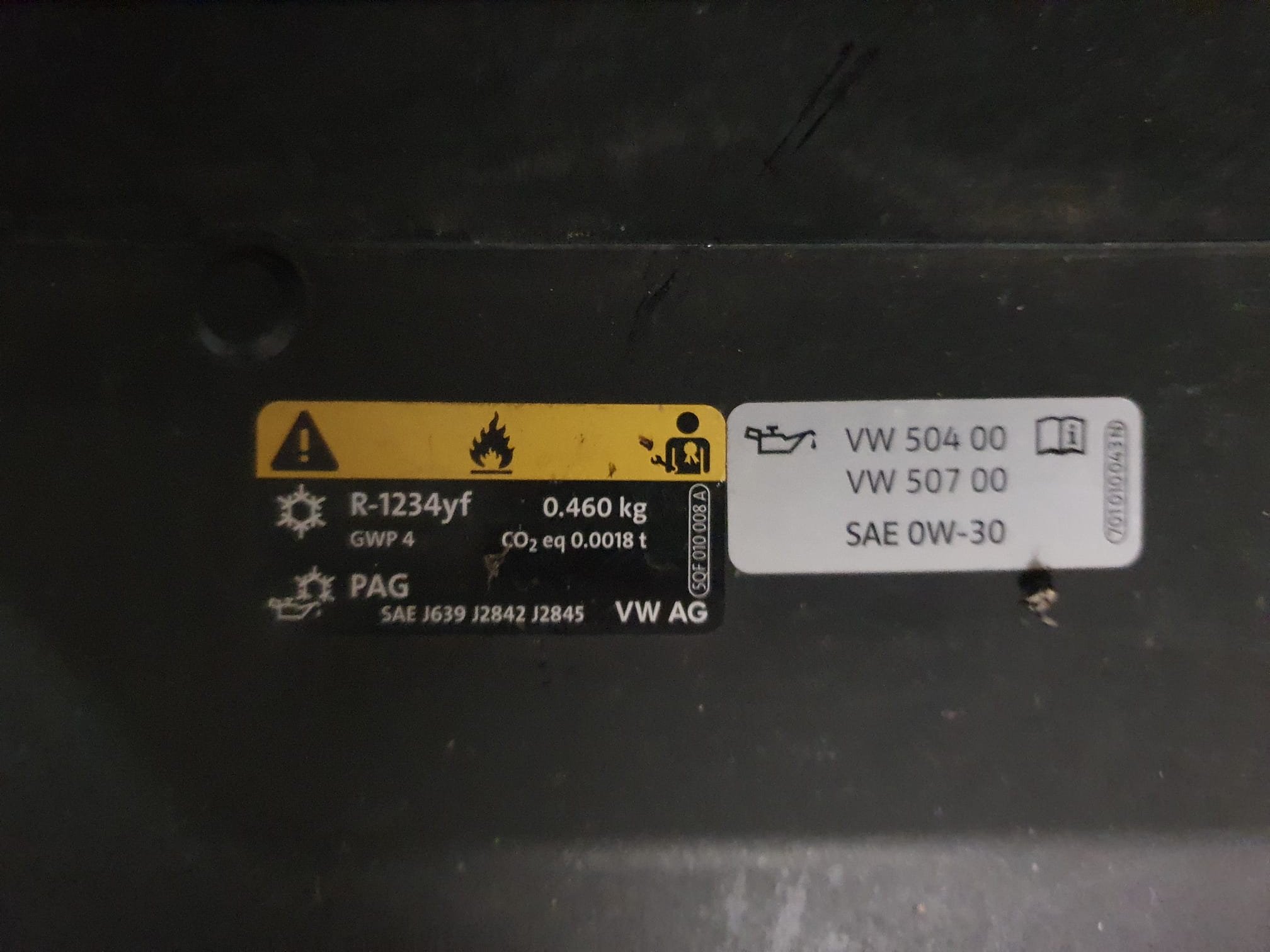

1 hour ago, s88urd said:
My 2018 TSI 280 (CJXA) has a sticker for 504 00/507 00.
Recently had a service at a indy and they used 5w30 Castrol Edge LL
Supports the fact that 504/507 was 5w-30 and then changed to 0w30; probably for EA888Gen4 engines
Finally thought about it when the bonnet was open:
Same but different grade to Gen3.

DNFE 280ps 2023.
Interesting to show and compare stickers ... my DNFE '21 shows....

funny how the stickers are somewhat misaligned 😁
