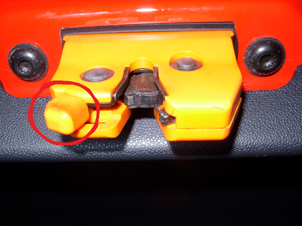

That's a MK2 and it's different. The MK1 lock is activated by a mechanism which pushes on the orange lever on the lock. The mechanism is mounted to the body not the tailgate.
Mechanism pushes on this...

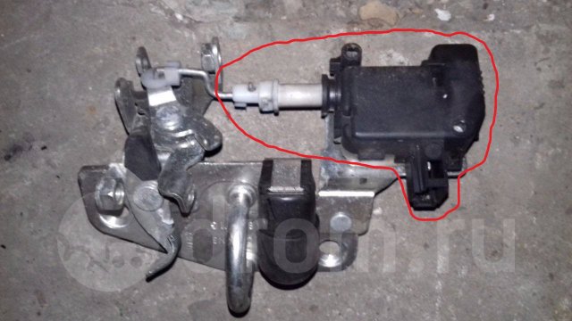

Lock servo motor looks like this...

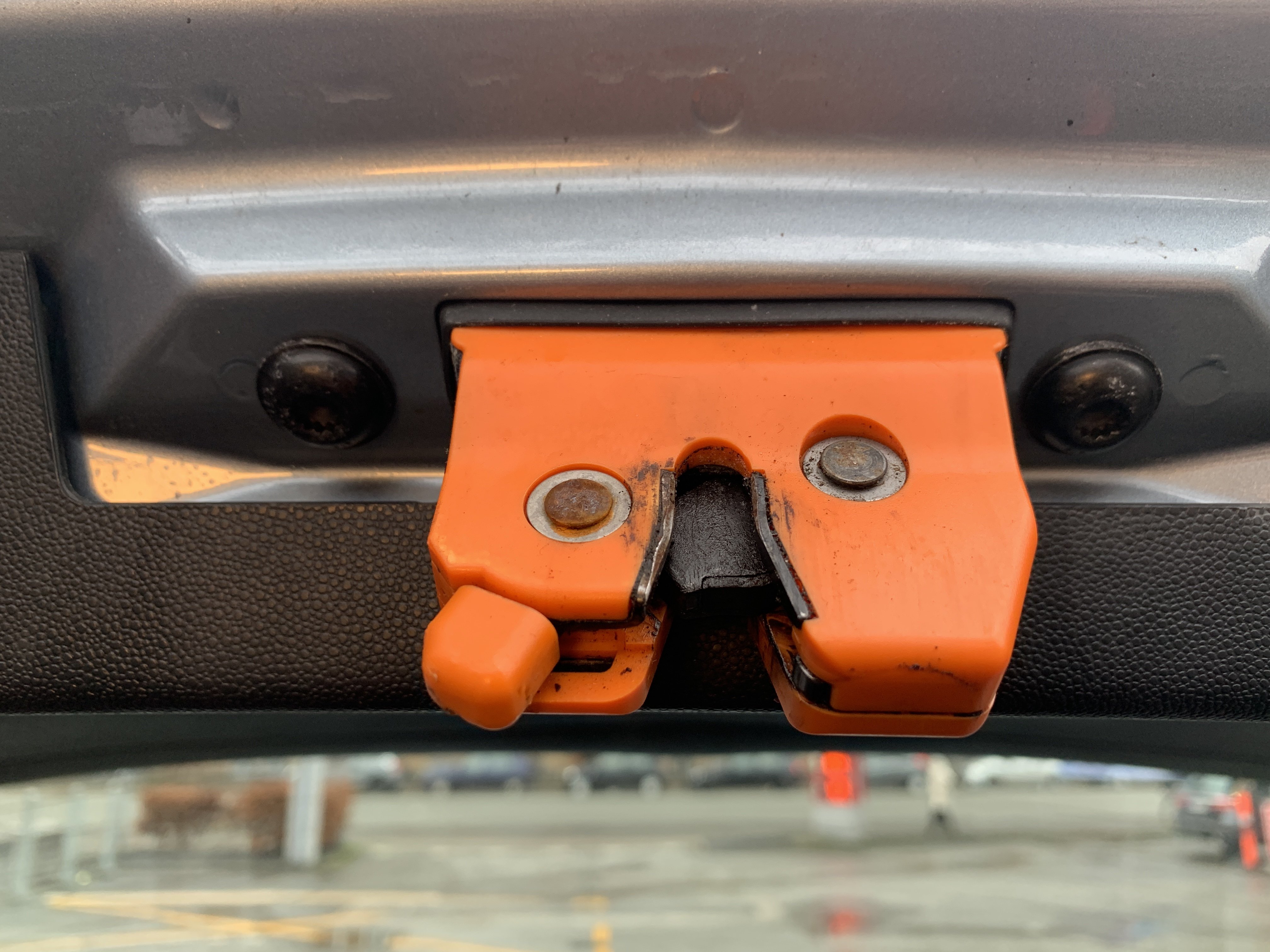

Yup, that's what I have... albeit not so clean

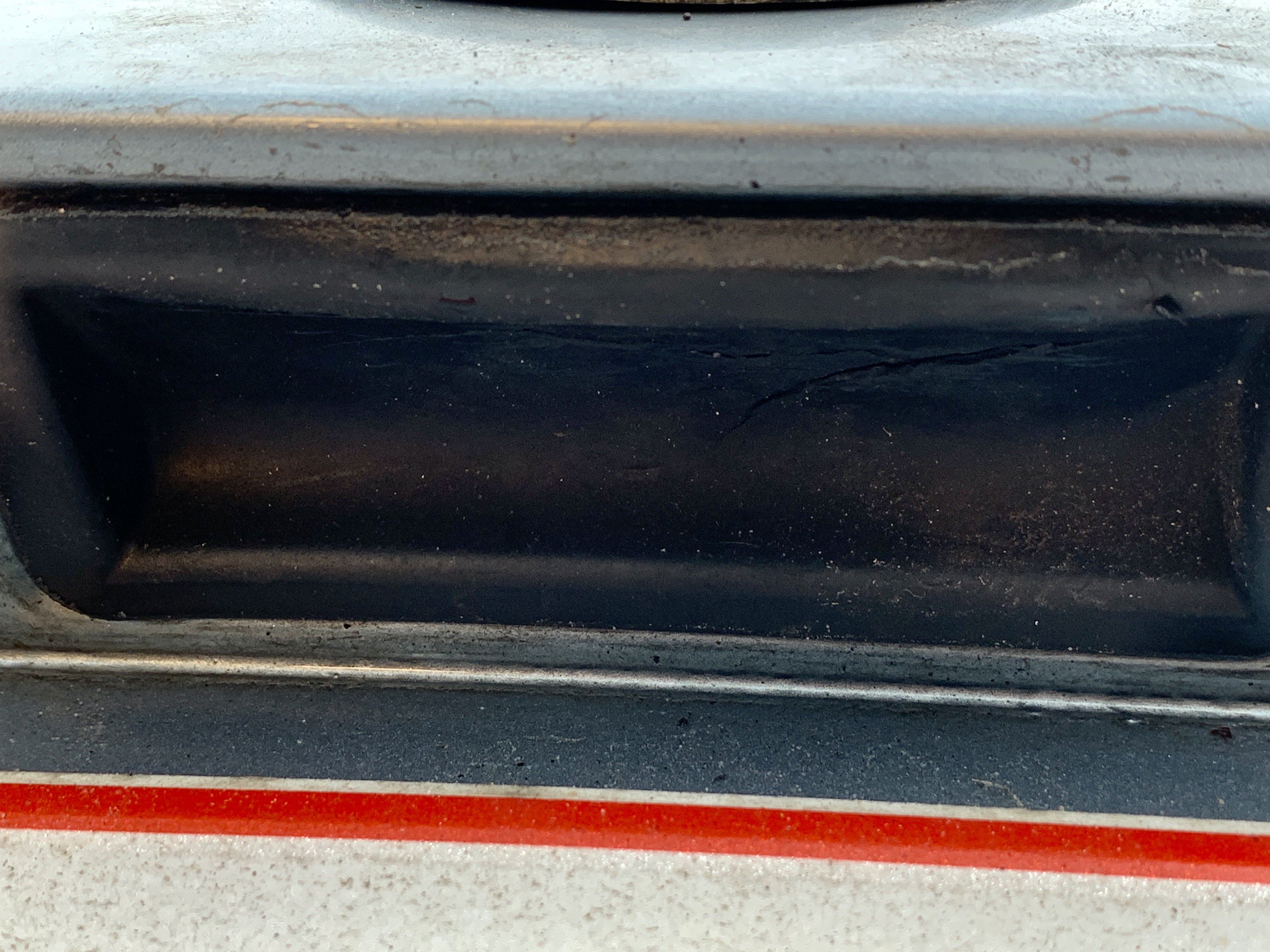

Got this car two weeks ago so still getting the hand of things. The rubber cover (behind which I assume the servo motor is) is in a pretty bad state, so I'm guessing water could have entered and damaged the motor:
Any idea of part numbers if I was to order the cover and servo motor?

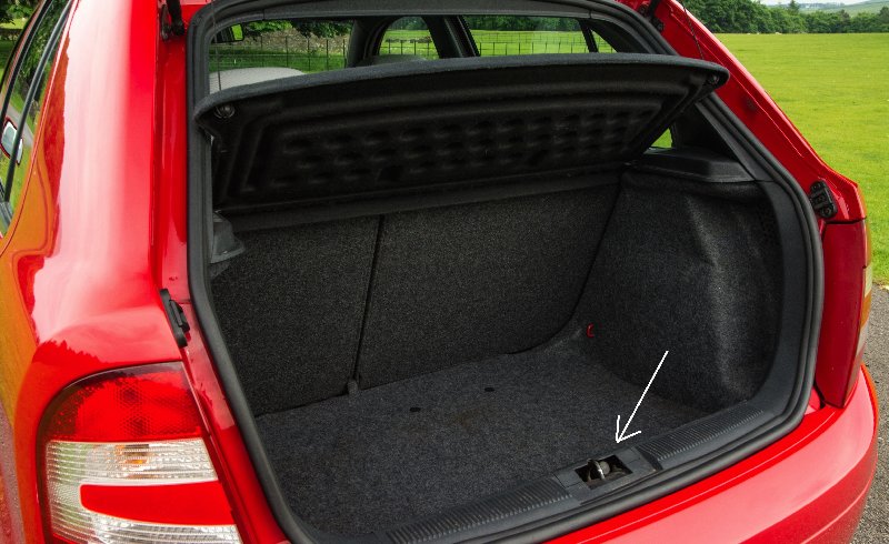

Those are the correct part numbers but the servo motor is not behind that cover, it is on the boot floor. It all needs testing out to find out if power is reaching the motor before you spend money on one.
Servo motor in here....
Edited by TMB
