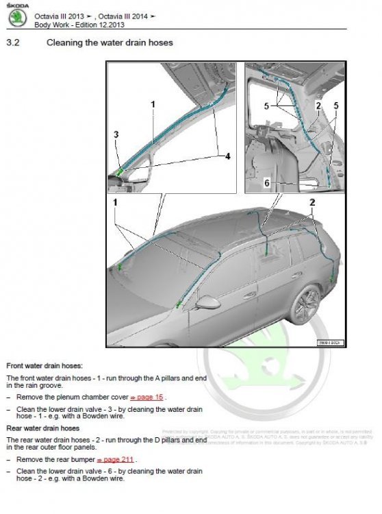

Does anyone know exactly where the drains for the Superb Pano roof are?  The manual says they're in the 4 corners and I'm supposed to shove a bowden cable down it once a year to clean it out, but I've not been able to actually find the opening.
@rado99 It's been quite a 2 years, eh.
I am sure they are just in the four corners
This is from Octavia but all same **** sunroof🤪
image.jpeg.5082dba00b68be0dbbffa39166d481df.thumb.jpeg.182787c1be504dc74677eec1fe918366.jpeg.781c80f6cb2a846851857d50f3319d3d.jpeg

I found them this weekend, after a week of the drivers side footwell being...sloshy.
The Superb 2 (3T ~2013) Combi front drains come down the corners of the plastic sunroof tray and terminate in a rubber grommet in the door frame, in between the top and bottom door hinges.  You don't need to remove the plenum cover like my version of ELSA tells me to (it lies).  I also couldn't get a bowden cable down it from either end, possibly because of the guk in it. As a last resort, I turned the regulator on the compressor wayy down and blew air in from the top and it blew the guk out and worked after that without needing to lower the roof lining at the front.  I suspect I was very lucky I didn't blow the hoses off.
The rear, just dropped the head lining (in the combi it's just velcro'd on), popped the hoses off the nipples at the sunroof tray and blew them out too.  The bottom end is behind the bumper bar and I didn't feel like taking that off so I was lucky that it cleared from the top (one was totally blocked, one was slow).
At the same time I pulled off the front wheel arch liner and cleared the leaves and miscellaneous organic matter out.
So I guess if someone else gets stuck, try a gentle air compressor.  And while the Octavia and Yeti's hoses end up behind the plenum cover, the Superbs ones come down into the door frame.
