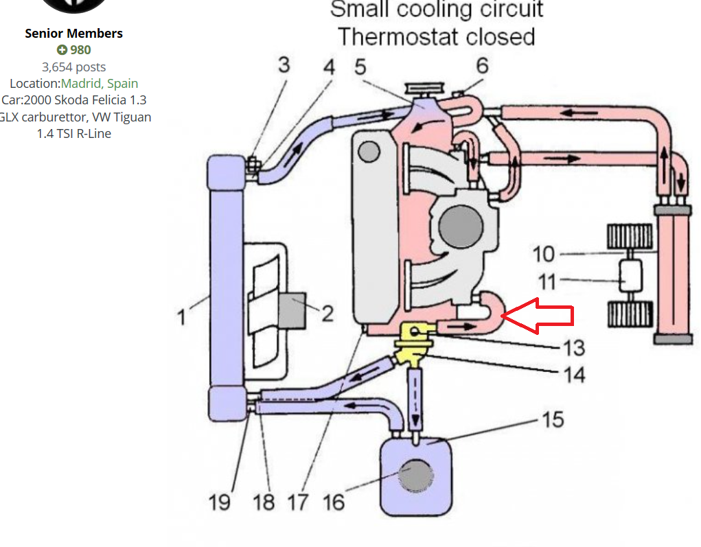

  • These illustrations should answer to your question.
  • Remember there is a plastic safety latch that holds the sensor. Pull it out while holding the sensor, raise the sensor a little to let all air escape, put it back down, insert the latch. No big deal.
  • @D.FYLAKTOS - Well, I think you're assuming correlation between 3 separate items:- The thermostat, which is a purely mechanical device in the cylinder block. The sensor for the temperat

Looking at the diagram that RicardoM posted, it looks like what is happening is just normal operation.
As the engine warms, the temp gauge sensor (which is on the engine block side of the cooling system)  makes the gauge read higher and higher until it reaches 93C.

Why suddenly the coolant in the upper part of RicardoM's picture gets so hot for the first minutes? it's not 91 or 93 'C but few days back was 95 and now 100 C, this is NO good !
For some unknown reason the coolant gets hot very fast for the first minutes,it's not the slow uprising movement that we all now,it gets crazy and simultaneously i feel heat and coolant smell on the cabin.
When the thermostat is full open the car works as it should be but every single day the first minutes are awful for me and for my wife,nobody can stand the smell of ''burning coolant'' and compromise with the idea that this will happens every single day.

Borrowing @RicardoM's diagram without permission (please forgive me), but this hose with my red arrow pointing at it may be important in the context of this thread.
Check for blockage in the hose, but also at the points it connects to.
When the thermostat is closed, it still needs to be exposed to some flow, in order to properly sense the coolant temperature and be affected by it.  If this hose isn't flowing, I think that sensing will be slow.

@Wino  : My thought too,i checked that spot if something restricts the flow and i added a 20mm piece of hose which is 1mm larger than the original.

Did you check all the other coolant hoses and connections into and out of the intake manifold? I'm not familiar with the exact details, but if any of those connections are restricted or blocked it may affect the thermostat even though that nearest hose/junctions is not the problem.
As far as my hand could reach and squeeze i found no problem.
In my Felicia the diagram is not as the above,the hose before the thermostat is connected to the heater (pink line) as you can see in the attachment.

Felicia thermostat housing is design fault. Thermostat tends to stick within the plastic housing.
Had the same fault.
Changed housing and thermostat. Then fill with coolant leaving the expansion tank cap off to allow for the release of trapped air pockets within the system.
Switch on heater to hot and allow the air to circulate as the heater matrix fills with coolant expel,ling any air via the expansion tank.
Once engine is warming up tighten the expansion tank cap on again and run engine up to temperature on idling only and check temperature guage.
Yes in general the felly had many design oversights when it came to cooling.
