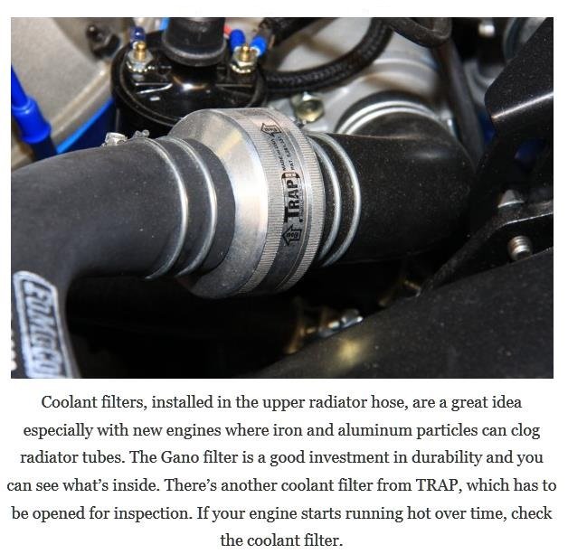

Check the No 8 photo from the slide-photos in the end, it's the 1st photo of my post and the text below are from them.
Unfortunately their diameter is small (are mainly for motorcycles-scooters) so i don't think will fit in our car.

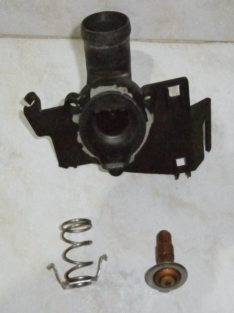

I visited my previous mechanic which changed my (broken) thermostat and i discovered something,he confess that when his assistance removed the old thermostat one part of it was ''gone''
i got angry ''why you didn't told me this before?'' and he said ''no problem,it's far away from the pump and this piece it will be somewhere in the cylinder block''.
I returned home,opened the bag that i had in my cabinet with the spare parts and i took a picture,you can see that the central axon is missing !
That piece can cause any trouble? Maybe is blocking a little bit something?

Mine also had a piece of it broken off but it stayed in the housing.
If it anywhere to be found that would be on top of the rad.
I've heard of this sort of problem happening before. In principle, the broken bit(s) should have gone along the top radiator hose and be someplace in that or in the header tank. It would be worth taking off (at both ends yes) and reverse flushing the top hose.
