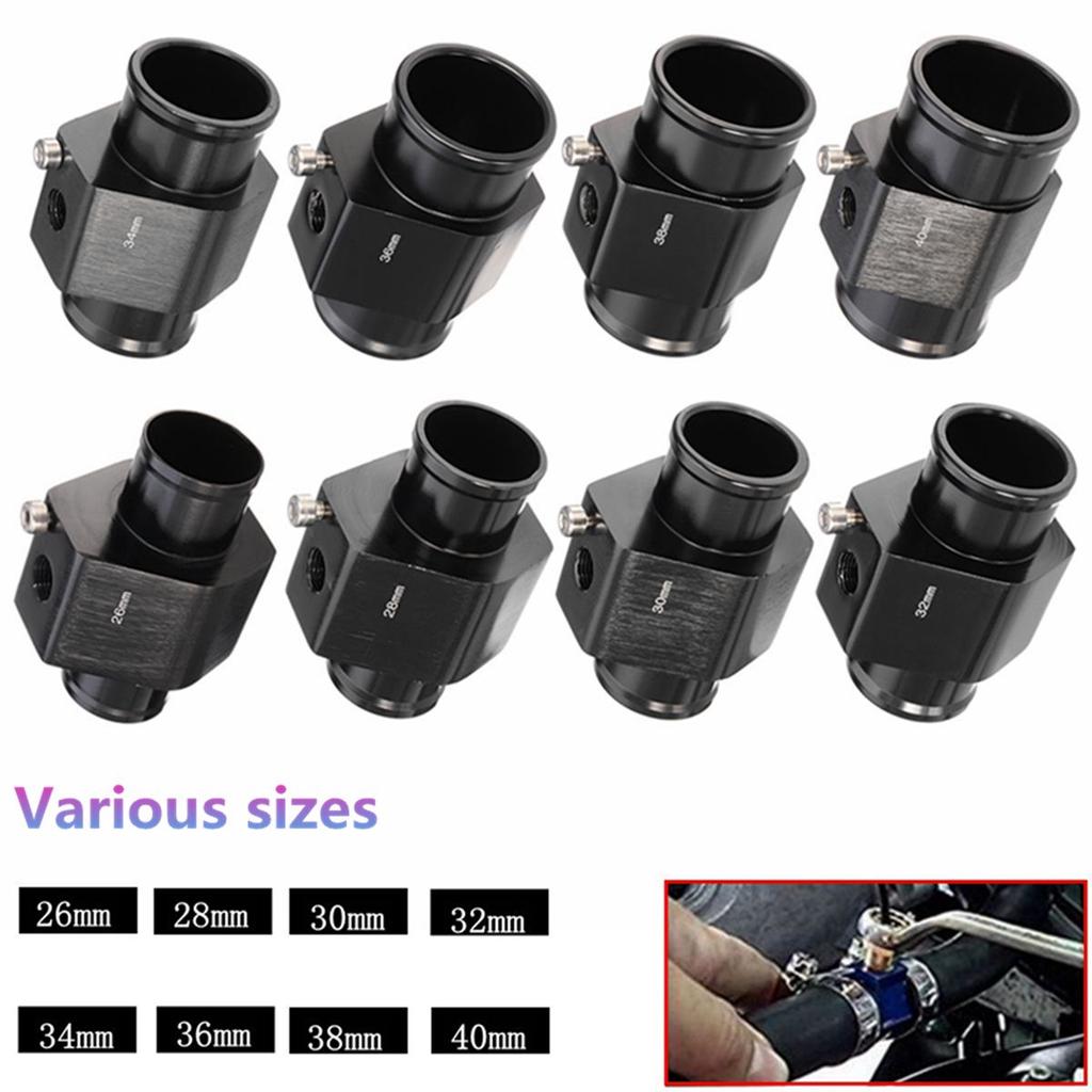

this is the temperature probe adaptor right?
the clamp keeps coming of because there is not enough of a flair at the end of it plus its surface looks very slippery,
in these cases i just use double clamps, also that means that your cooling system gets pressurised so i would advise checking expansion tank's cap for stuck release valve

Thefeliciahacker My Patrida unfortunately the end of the majority of 26mm adaptors have that problem so no matter how you tighten the clamp it's a matter of time to get loose under pressure.
If you use force the ''walls'' will get bend because are very thin.
Check the far left adaptor, watch the end have not enough ''rim'' as the others

Maybe using double clamps could be solution but even that there is no insurance
