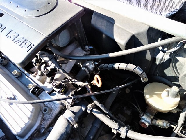

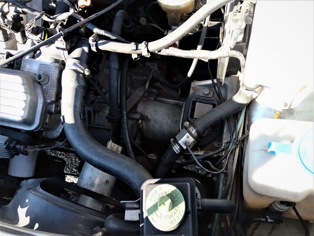

  • These illustrations should answer to your question.
  • Remember there is a plastic safety latch that holds the sensor. Pull it out while holding the sensor, raise the sensor a little to let all air escape, put it back down, insert the latch. No big deal.

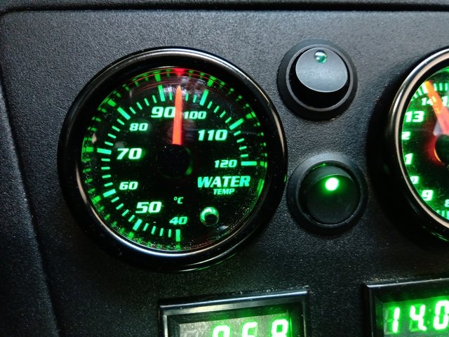

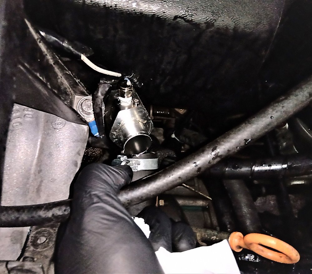

After that problem occur i added in my console a gauge with an 1/8'' NPT sensor just before the new 4 PIN sensor (code 6U0919501B) ,i did as an extra insurance in case that the gauge has problem etc
but that crucial seconds shows exactly what the gauge on the panel for example 93 'c, those seconds i don't know what to do !
My thermostat is new at 88 'C, the thermoswitch is new, the coolant is new even the water pump has only 5100 km in use.
What is causing the temperature of the coolant (before the 4 pin sensor) to rise so suddenly and in few seconds returns to normal?
