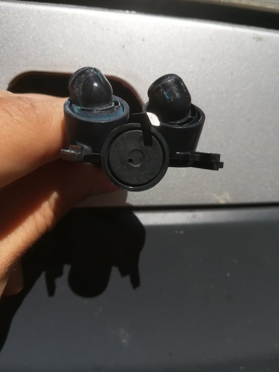

IMG_20190712_121819.thumb.jpg.8beeb8edae7c437507995f127df88c59.jpg.fe7e54079c72c8c8c6278a7f9fb96afc.jpg
been out to have a look and its pretty bad.
the one that doesn't have a cover over it has 2 split jet mounts and the other one has a whole jet missing.
so to repair I might be able to take a jet out of the split one and put it in the missing one. then buy a new assembly and cover for the side that's split.
are they relatively cheap?
Edited by cypher007
All the parts and numbers are all linked to on this site if you search.
Edited by MicMac

As I am missing only 1 of the 2 jets on one side and
1)never really use them anyway
2)don't require them for an MOT
3) you can't buy them separately only the complete lift cylinder unit
I thought about improvising a jet based on the original but made from a dollop of epoxy with a lubed strand of wire through it (pointed towards headlight).  As it cured I would pull the wire strand out and hopefully leave a hole.
If any DIY types want to try, perhaps body filler would be better.  Just be sure to fully extend the cylinder and secure in place to get your jet aim correct.
I'm a diy type...
I'd suggest a slightly different approach: make your body out of whatever gloop you want, encase a bit of the correct diameter hose in it for direct connection.
Then seal the end of that hose with a hard setting epoxy and drill a nozzle through once fully hardened.
That way you can start with a small hole, test, drill the next size up, test, etc untill you're good.
eBay will sell you some micro drill bits in 0.1mm increments.
Pulling out a wire from setting epoxy isn't going to give you a consistent flowpath, if it doesn't collapse it'll likely be widest at the end you pull from, plus you'll have a longer flow restriction.
Edited by Daniel_Bos
