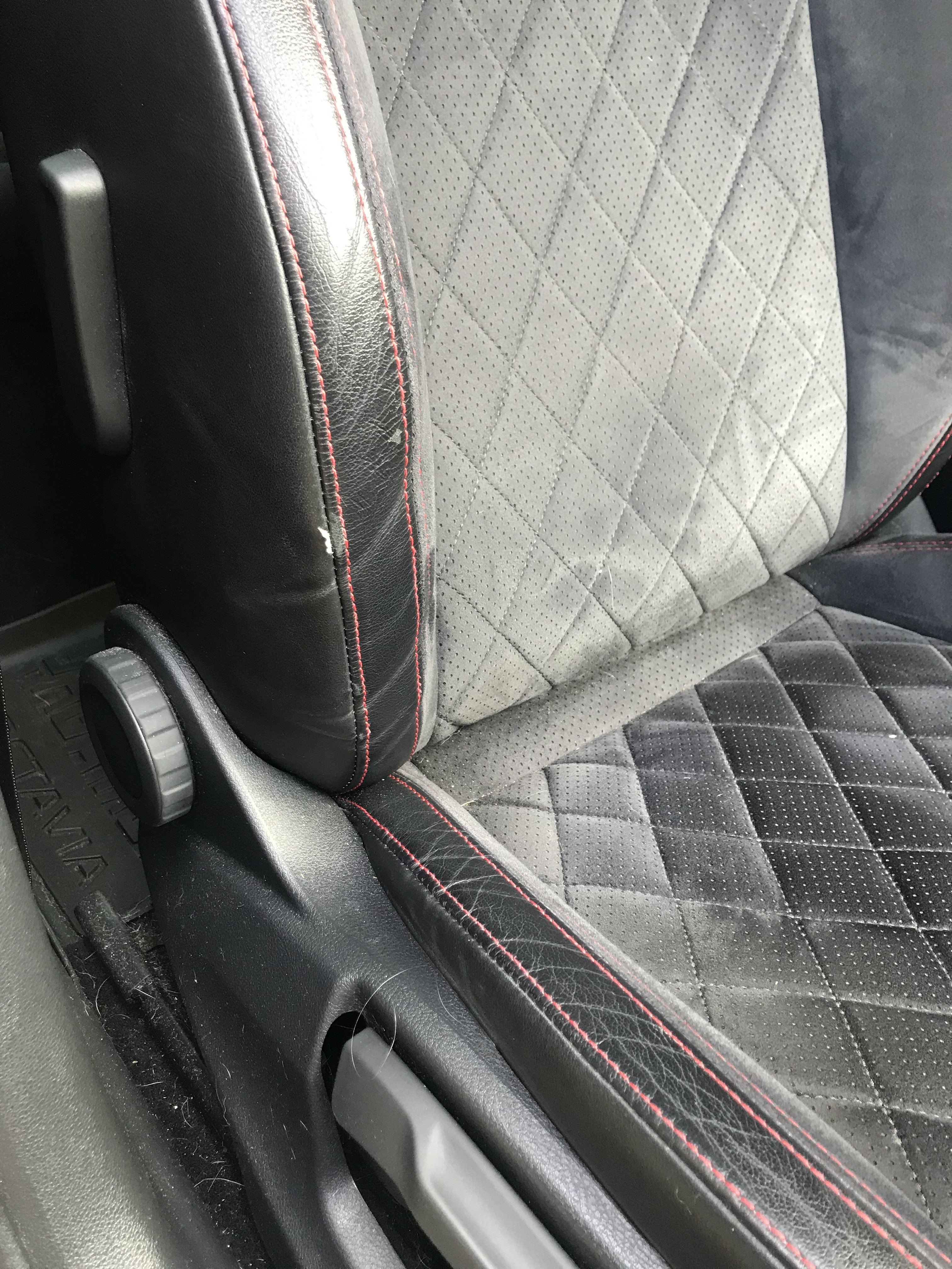

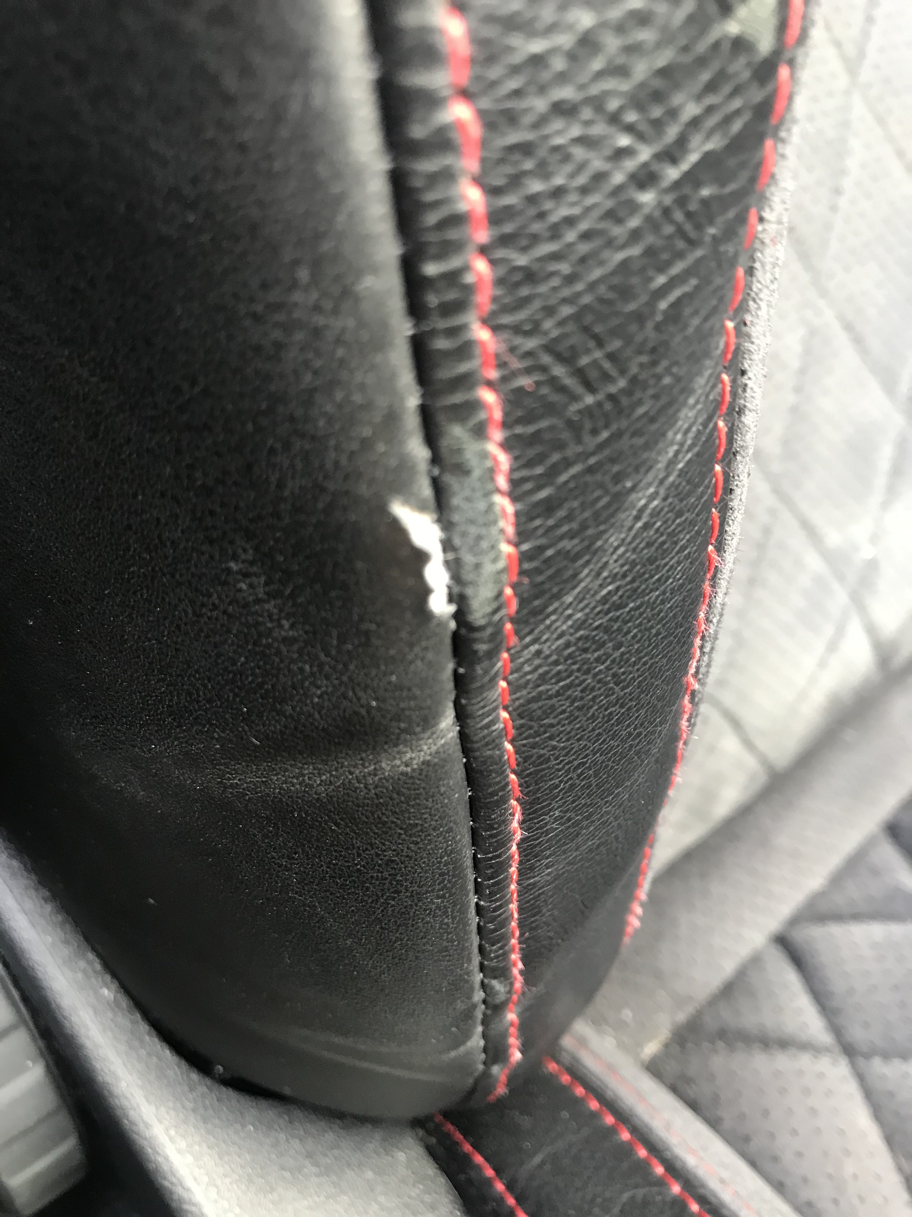

Has anyone had trouble with their seat bolster leather splitting/wearing?
 Mine has been refused warranty today saying it’s war and tear?
 The car is under 3 years old and 30000 miles.
 The dealer said they have seen 3 or 4 recently and they have all been refused warranty

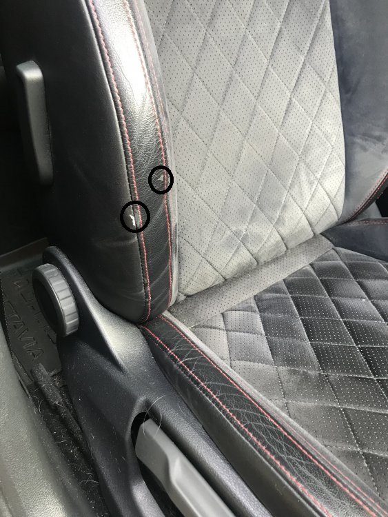

I'm no expert but it looks like the material in the above photo has been damaged rather than worn.
Look at the rest of the material where it meets the stitching - that's lasted over 2yr and 30,000 miles and looks to be perfectly OK. Sorry, I have to agree with the garage.
I'm looking at the leather on the seat cushion - just wondering if you ever use proper leather cleaners and balm to recondition it? No leather will last if you don't look after it.

Agreed, it is damage from the seat belt. i've also had this on my previous car. The misses sits too far up front, so the seatbelt rubs against the chair.
To avoid this damage it' best to buy a seat belt protector.

It may well be seat belt damage where the material has ripped, but I was also looking at the other area where the leather has been worn. Could a seat belt have caused that too?

I have just checked,   It’s not the seat belt. That’s much lower.
  If it is wear and it’s not covered I will suck it up, but I have never had an issue before with my past cars.

The red stitched panel is leather, the side panels are plastic over the white liner base material and both are damaged. Theres quite a bit of wear and snagging on the stitching as well as creasing into the seat side panel of the seatback suggesting a lot of pressure onto that area of the seat. I'm guessing It will be worn from your clothes and hips as you get in and out particularly if you have studs present, stiff belt loops or a patterned belt you wear regularly. Also, are you well under 6 foot tall and the seat bolster is in line with or in front of the door pillar?
Next time you get in, stop half way and see what you are in contact with. Same when you get out.
