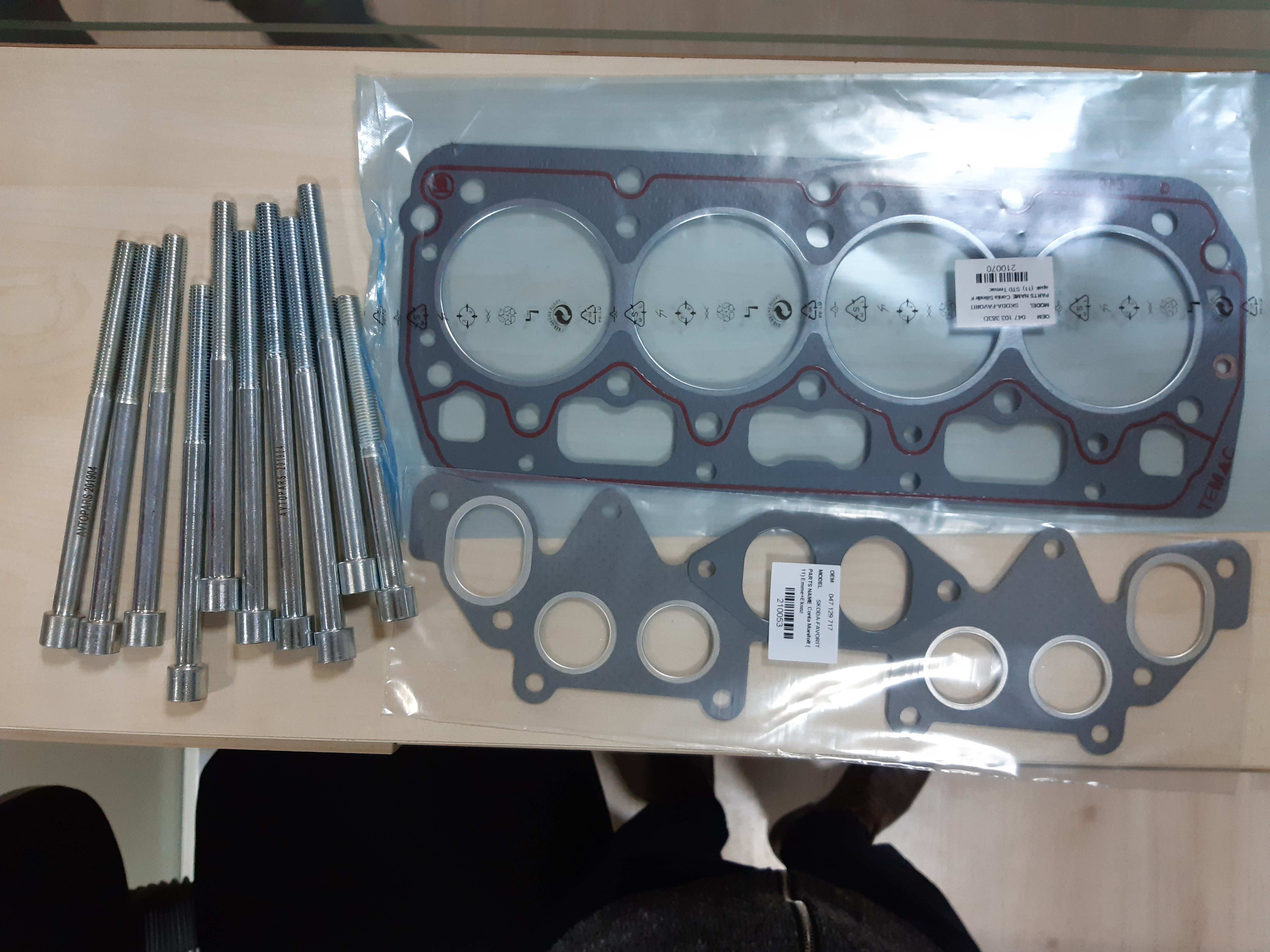

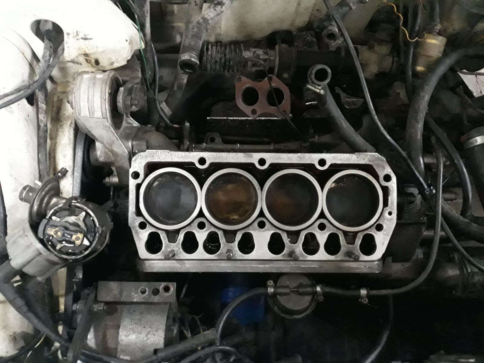

Concerning the car ı left it Yesterday and got the gasket and bolts. The seller also told me to change the manifold gasket(do you guys know about this?

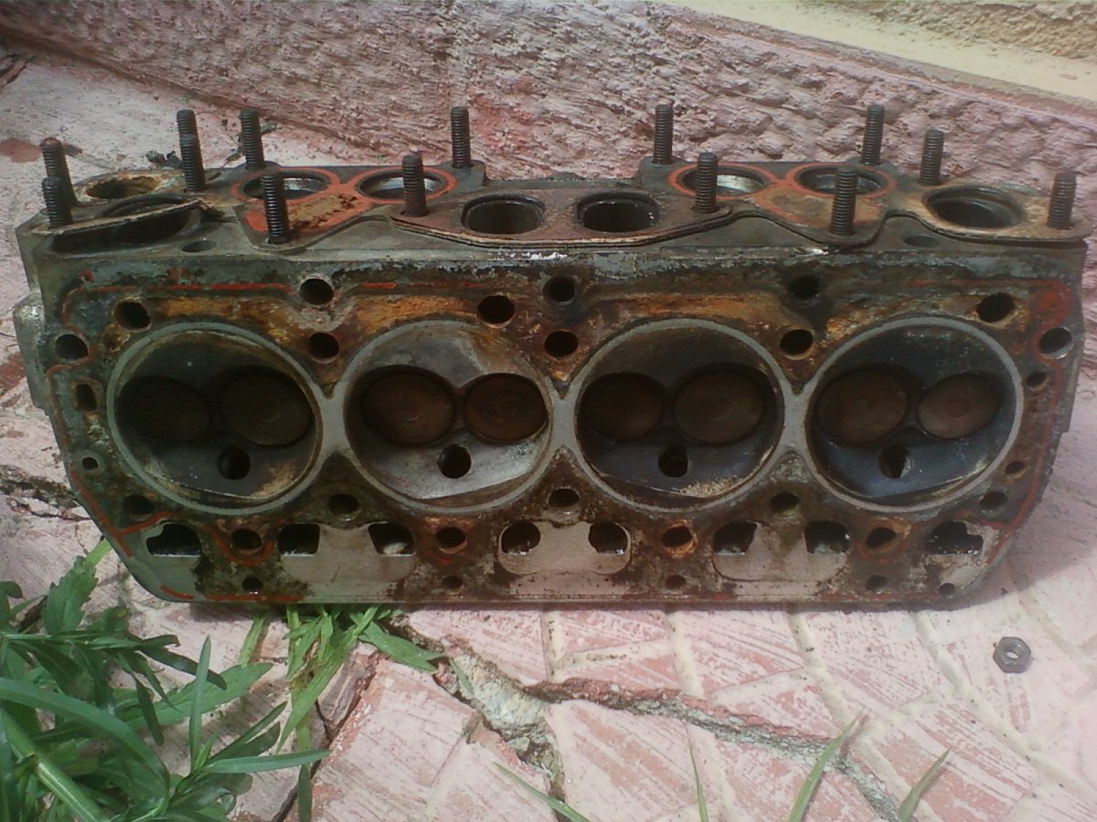

Also ı talked with the mecanic he told me the the cylinder head look good but it look like it rust/rotter in the middle between cylinder 2 and 3 manifold side. He told me he will check with the rectifier(metal working bench) if the tolerences are good enough.
Lastly the seller of the gasket told me there were the best gasket on the market. I asker for oem and he told these were oem(temca). Any idea about this?
For the cost of the gasket : 10eur for cylinder, 3.5 eur for manifold, 18.5 eur for bolts.

Temac is good but i know that victor reinz is better.
It is the smaller one in the kit you bought. For intake and exhaust. Mandatory to change it.
It is good.

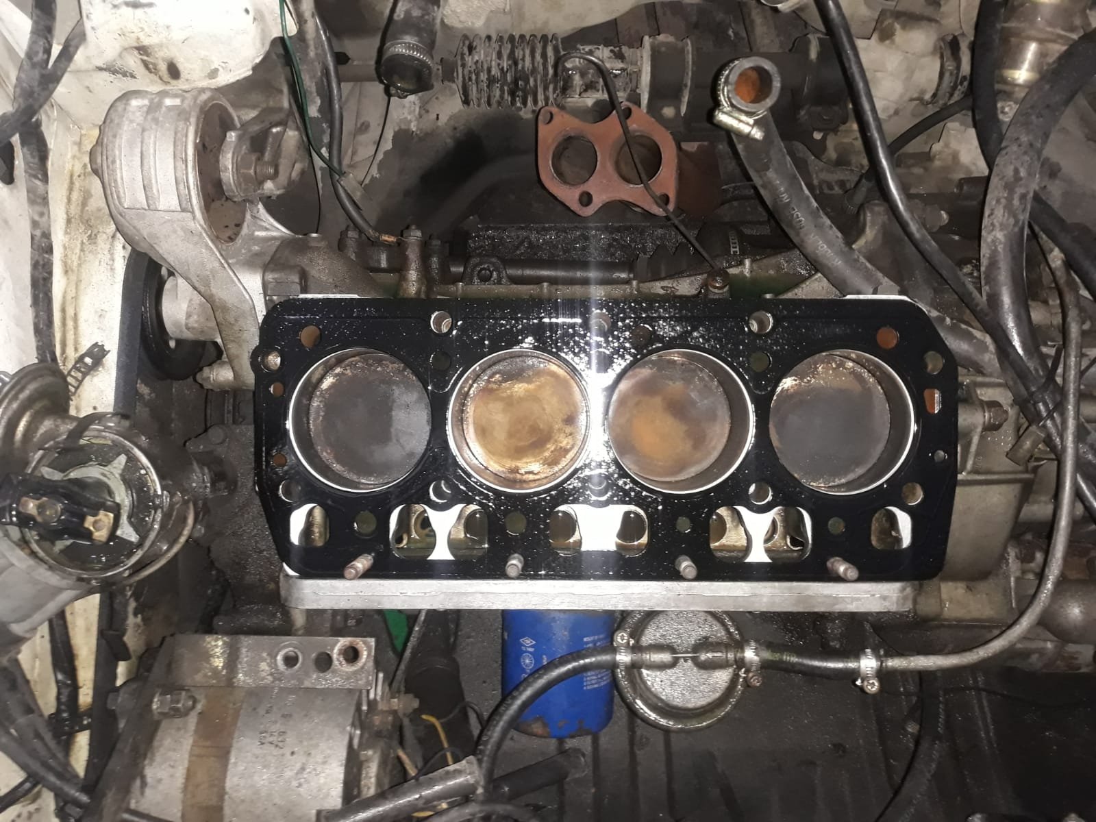

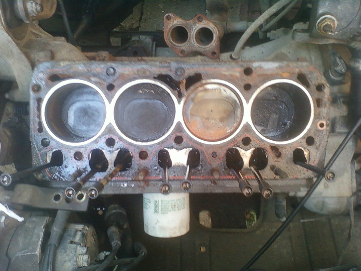

The old gasket tells you where the leak was. My guess is between cylinder 2 and 3 combustion chambers.
Now, the entire success of the job depends on few key things:
  • clean well the head and the block
  • measure carefully the straightness of the head and block !! (max. 0.03 mm) and also look for corrosion
  • grind the valve seats if necessary
  • clean the holes and threads of the block for the head bolts
  • torque the head bolts in recommended order, in 3 stages (20 Nm, 90 degrees, 90 degrees)
Was there any damage to the resulting head gasket.

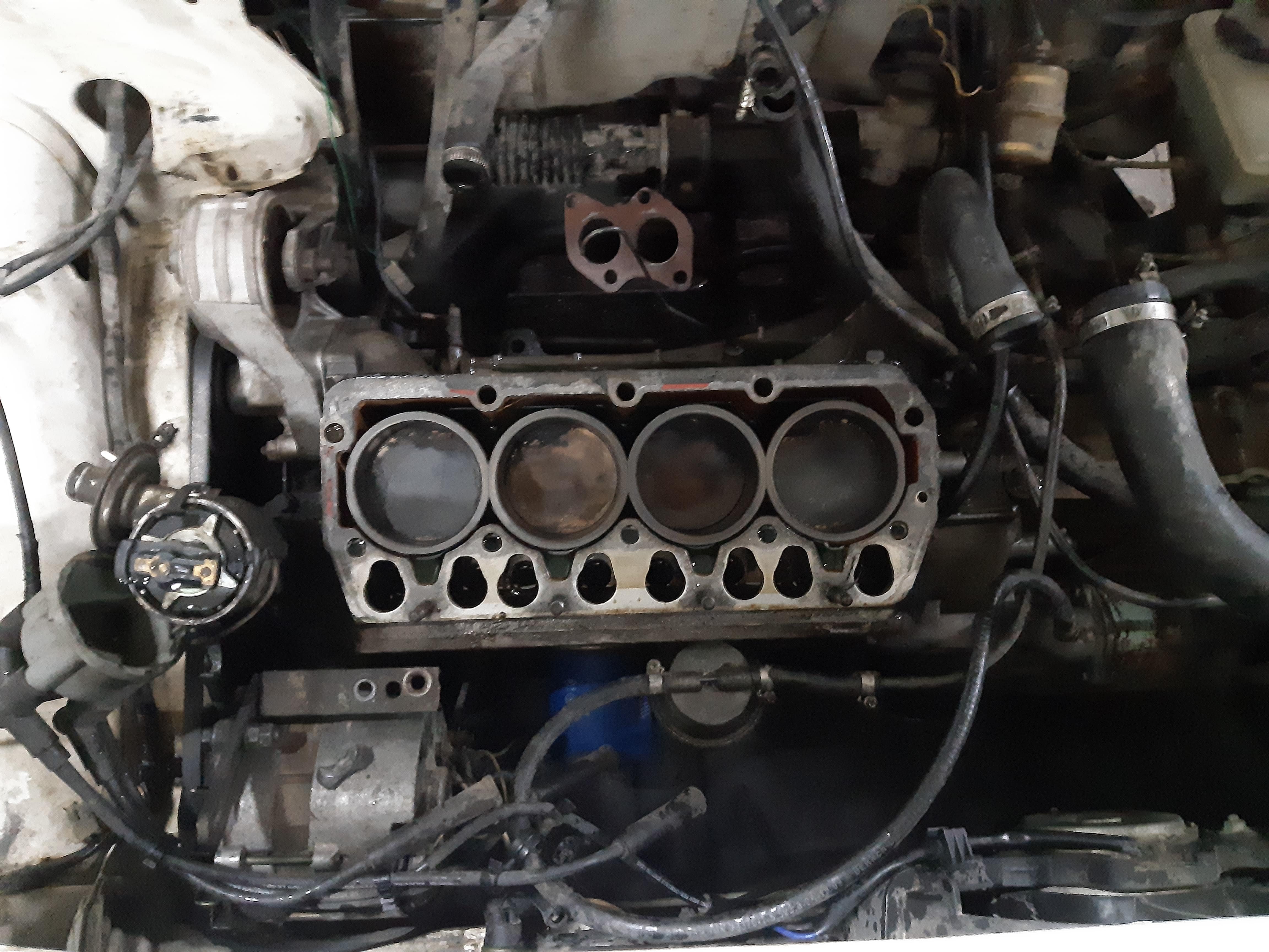

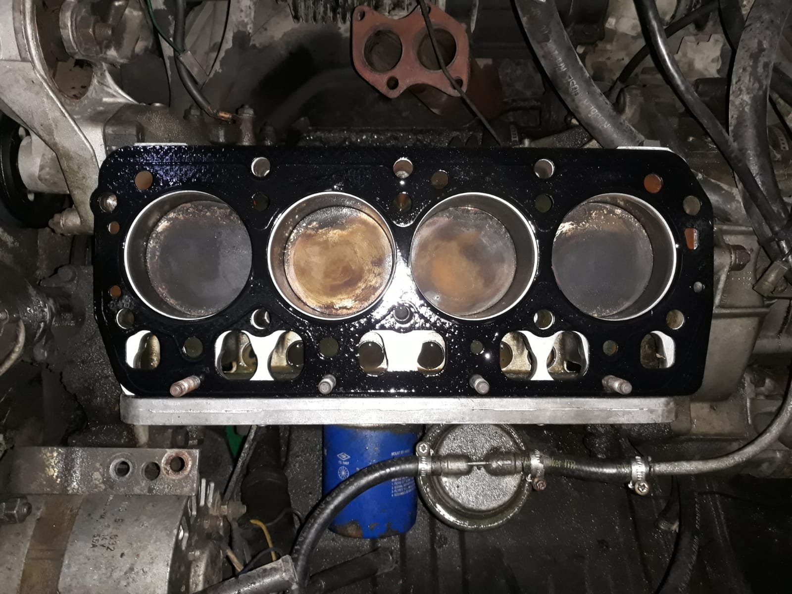

Mr Turgut it look like you have a problem on the 3 cylinder. There is no carbon depozit on it and rust. You should check the spark plug/cable.
Ricardo, ı talked and informed the mecanic about the 3 stages of tightening. He will also send the upper block to check any deformation and impurity/rust.
right guess
I repaired last year.
3. cylinder metal seal rot.

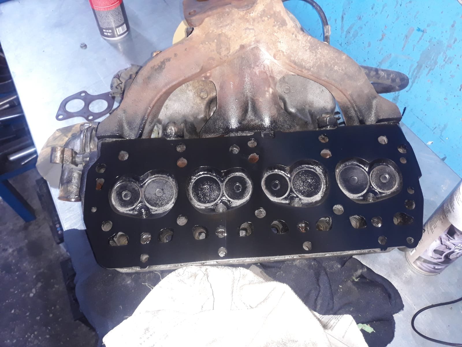

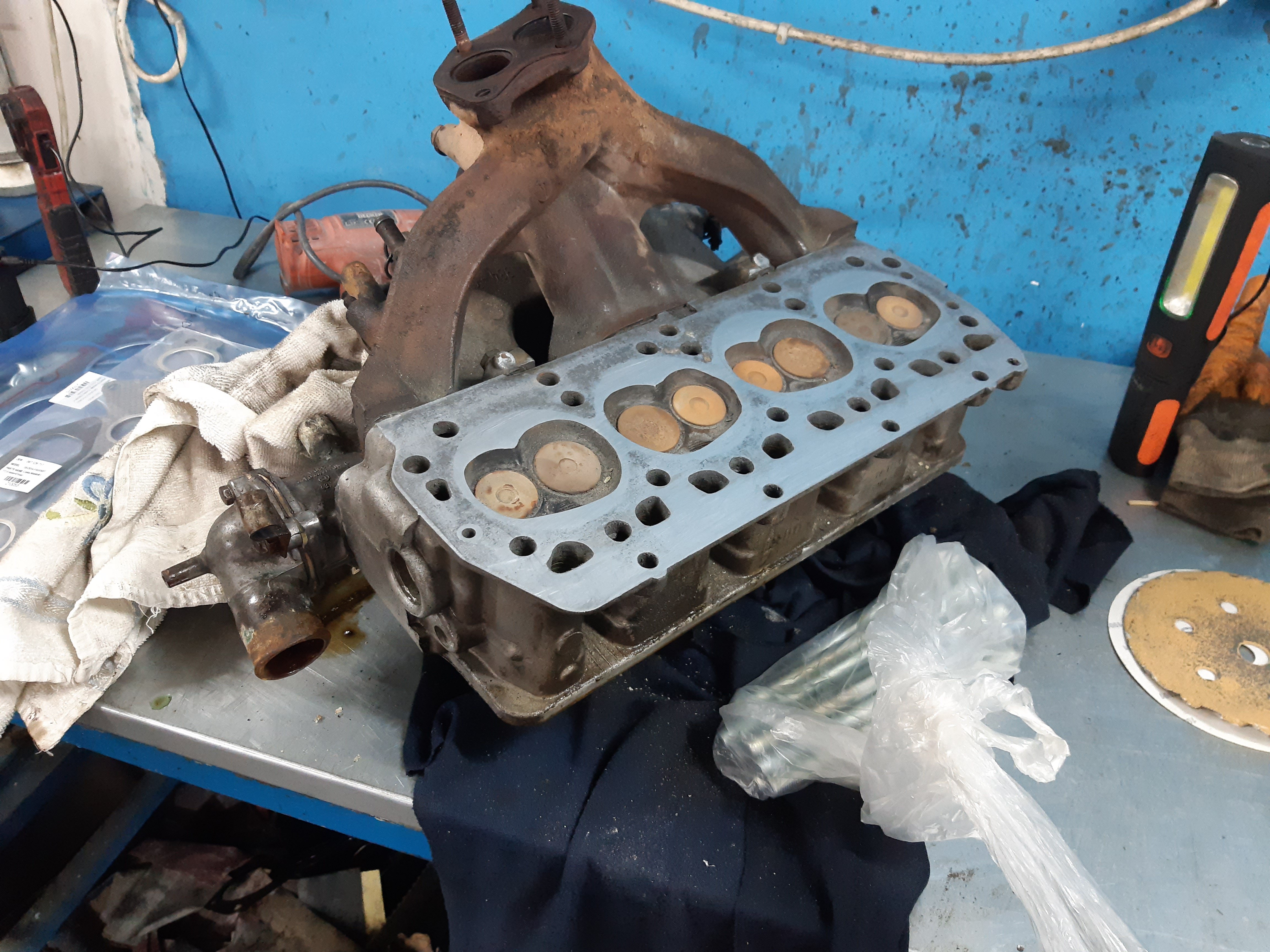

dare I say that this head does not really need skimming?
just a very good clean with abrasive sponge
Don't dare based on a photo. We're talking about hundredths of mm maximum loss of flatness.

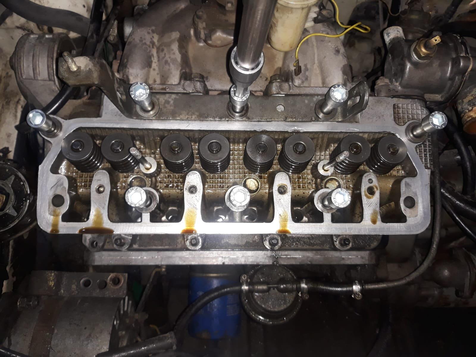

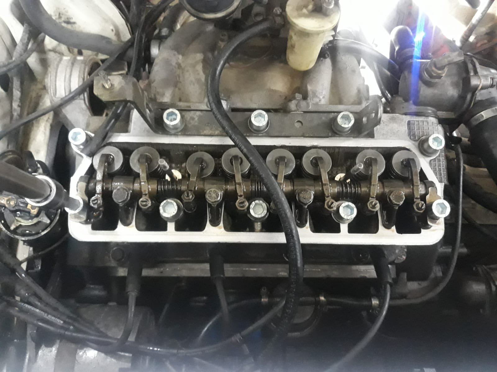

So, I got the car yesterday. The job seems good and he replaced all the bolts. I asked him a couple of photos during the process and thankfully he didn't forgot !!!
As it can be seen on photos cylinder 2 and 3 had a bad time (rust). He also changed the oil and oil filter and the spark plugs as I was already planning to do so. As expected the Cylinder Head wasn't bent.
Now that the HGF has been repaired the rough idling/misfire is totally GONE !!!! (YEY!!) Also I felt like a slight increase in power, I mean it is jus a feel and I am not sure it increased yet. I climb a slope everyday and it seemed it did better than previously, not quicker but lets say easier. Lastly, Normally the temp gauge would take only 5 min to heat up with the HGF but now it took around 10 min in middle traffic.
Normally, a good mechanic should add a small quantity of engine oil on top of the pistons. Obviously after cleaning the top of the pistons of carbon deposits...
Some of the valves look baked with carbon deposits too. Overall it looks like a quick and cheap job. Let's hope the gasket will hold. You'll know it in the summer under load.
