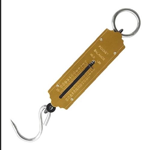

    You could probably do it quite accurately by using a spring balance to measure force, and calculate by lever arm length and balance reading what the initial xxNm is equivalent to when you pull your ra

You could probably do it quite accurately by using a spring balance to measure force, and calculate by lever arm length and balance reading what the initial xxNm is equivalent to when you pull your ratchet handle round with the spring balance??
Wow nice idea. Just to be clear the torque wrench calculate the torque needed at the top of the nut right?
So knowing the length of the wrench and the force at the top would permit me to check the torque needed. Nice idea!

Yeah, I imagine there may be youtube videos showing you how to do it and to do the maths?  Haven't checked, but I'd be surprised if there isn't anything.
Say the initial stage torque is 20Nm, and you connect that balance to a lever/ratchet handle at a distance of 0.5m from the centre of the bolt, you would need it to read 4Kg, I think.
@Naboula01 @Wino - I wasn't discussing that method (because I'd forgotten it TBH). Still, with a typical tommy bar, (12inches or 1 foot long) you'd get usable imperial results using a suitable scale calibrated in pounds. Xlbft means a force of X pounds at a distance of 1 foot.
