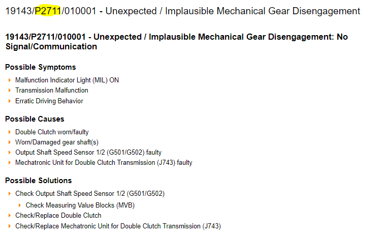

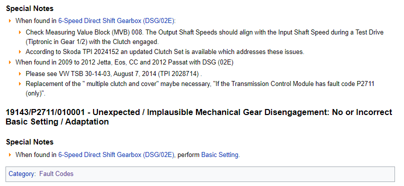

It's a 6 speed when I got the car it was on 64000 miles now on 75000 I was told it had been done at 40000 the place I took it to scanned it and come up with a code of p2711 but said he doesn't do dsg stuff so I've got to find somewhere tomorrow to take it thanks for the reply before it happened it had been smooth in every gear and no funny sounds or juddering

...the place I took it to scanned it and come up with a code of p2711...
