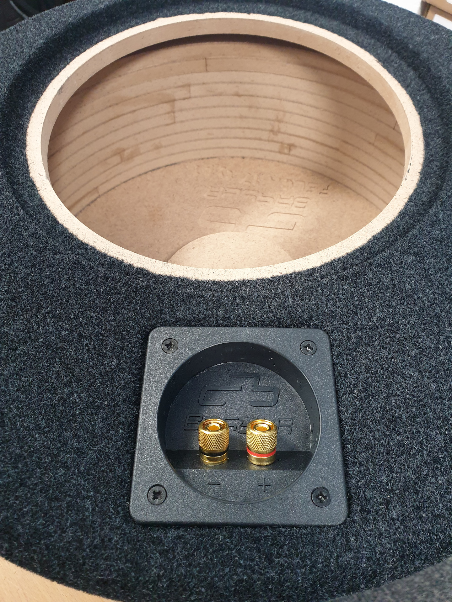

As I am constantly updating my sound system in my bellowed Karoq , I decided to install semi-custom made subwoofer in the spare wheel.

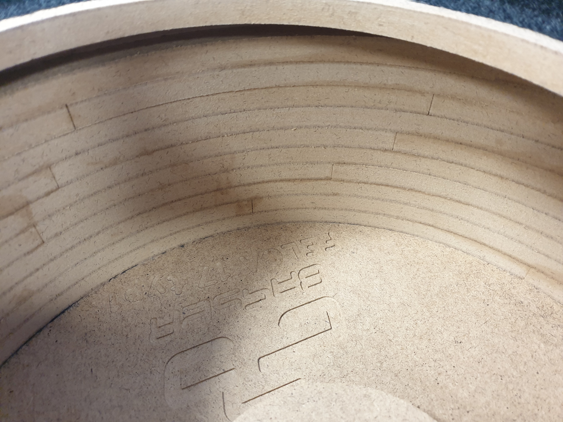

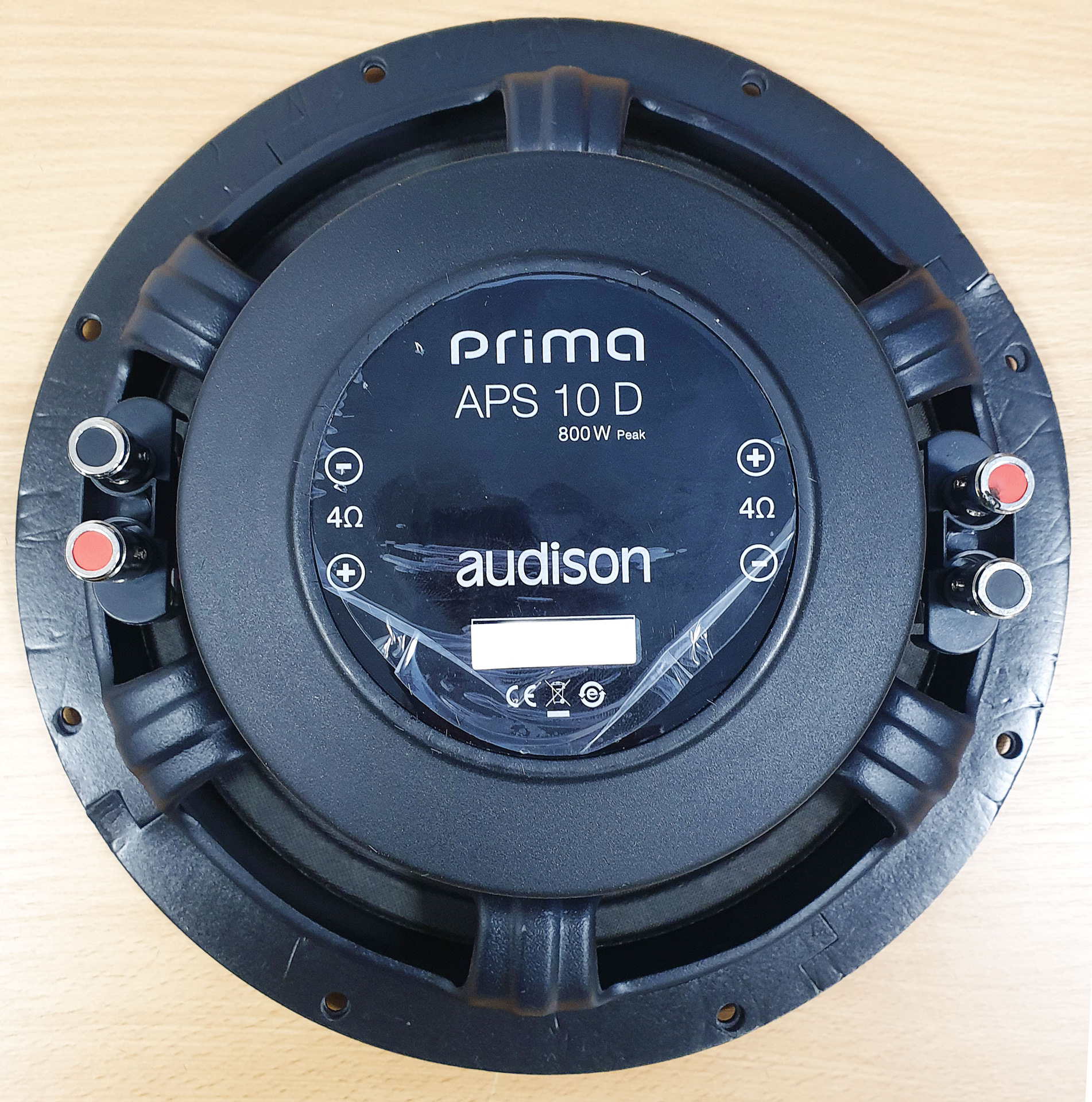

My current small Kenwood underseat sub will migrate to my wife's Tucson. And the new one is based not on my favourite Focal component but Audison Prima APS10D. Got the box from Ebay. Speaker need 10-12 , the box is 15.  Put STP sound deadening and damper mats inside.
3Dprinting mount right now. Will add photos and .stl files  later. Power palnt will be GZTA 2.500TX.
ready one
side view
box made of MDF

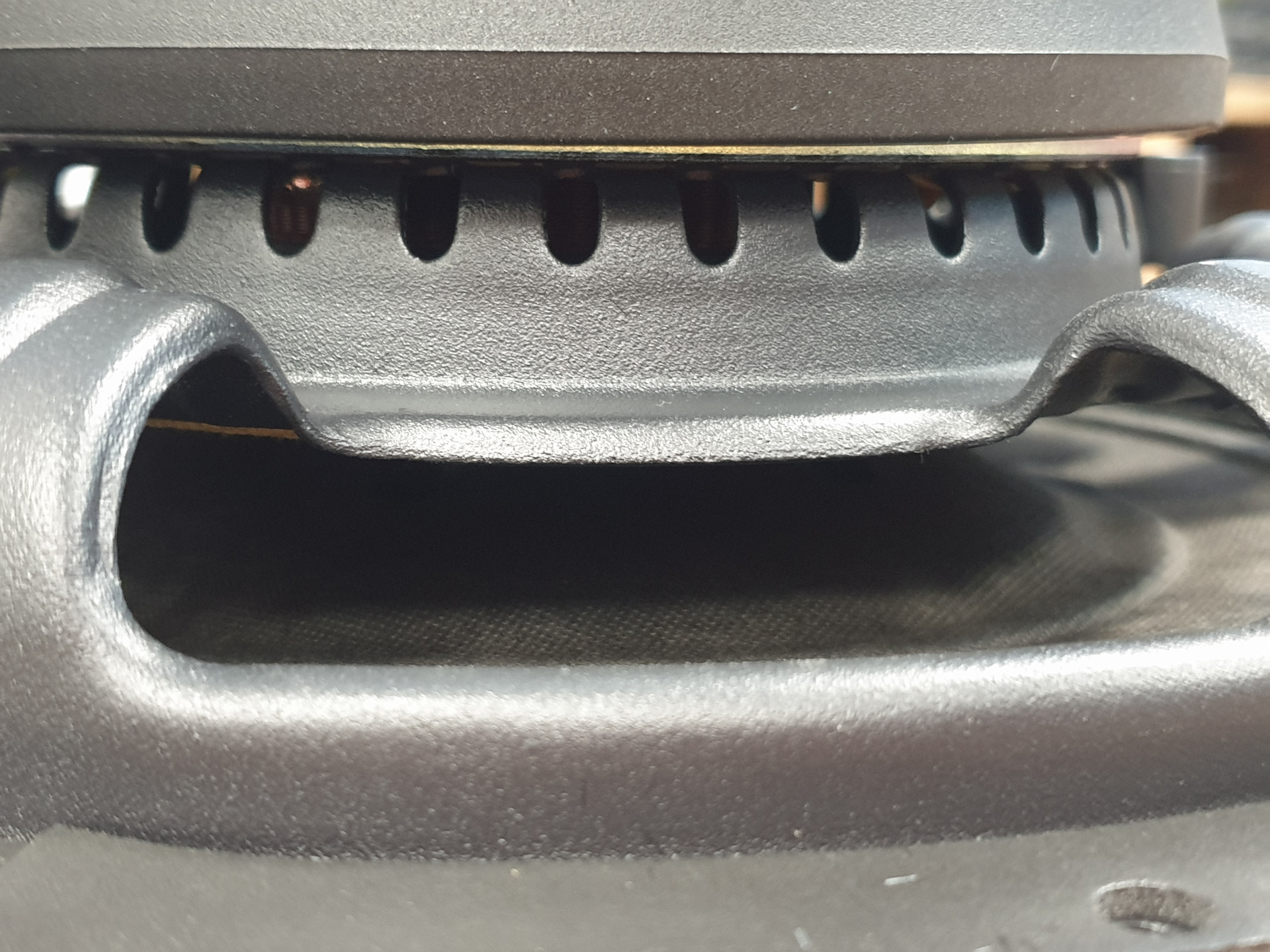

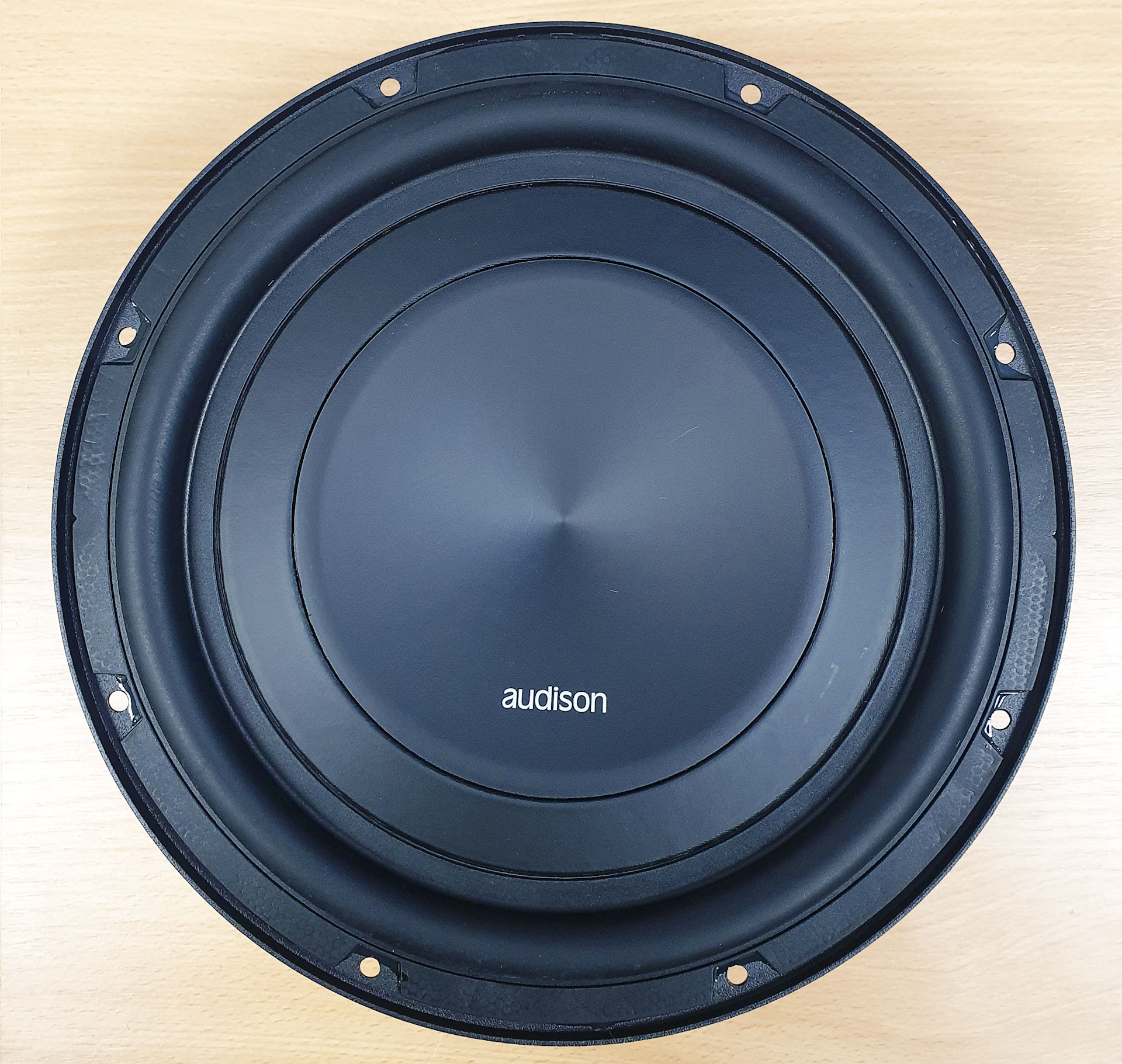

Speaker
two coils , 4Ohm each, parallel will be 2Ohm , 400W RMS
Vents are on the side , plus sub is VERY shallow , mounting depth is on 88mm
Grill and all mounting accessories came with speaker
Testing fitment
Dampening material
Mounting pod prototype

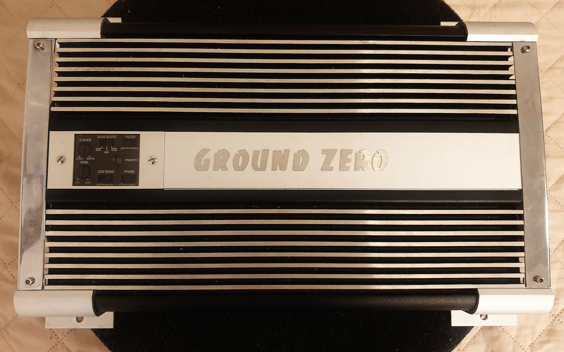

AMP

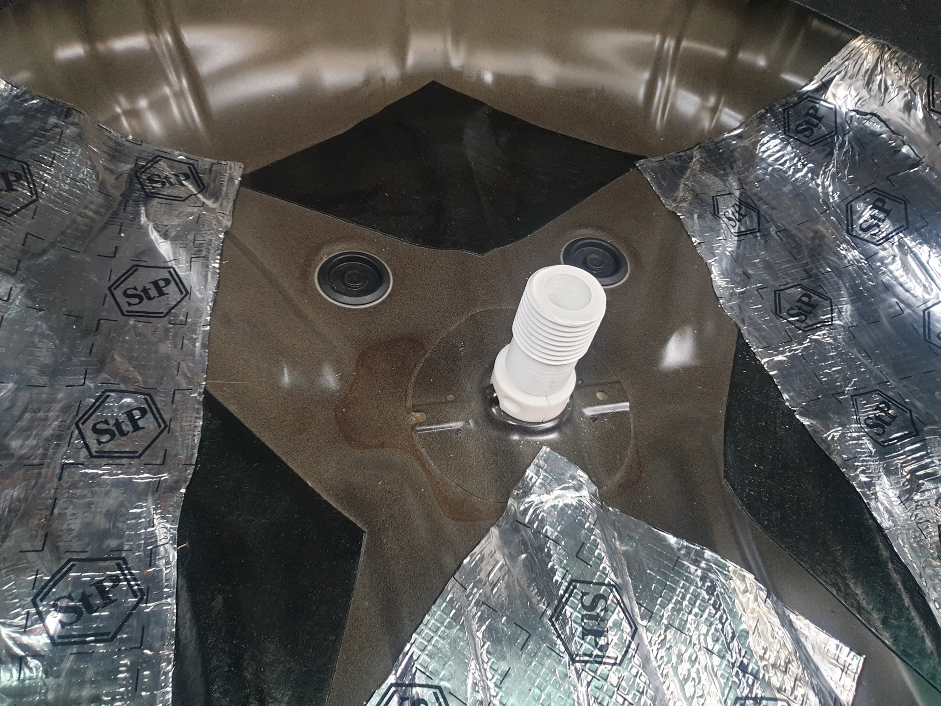

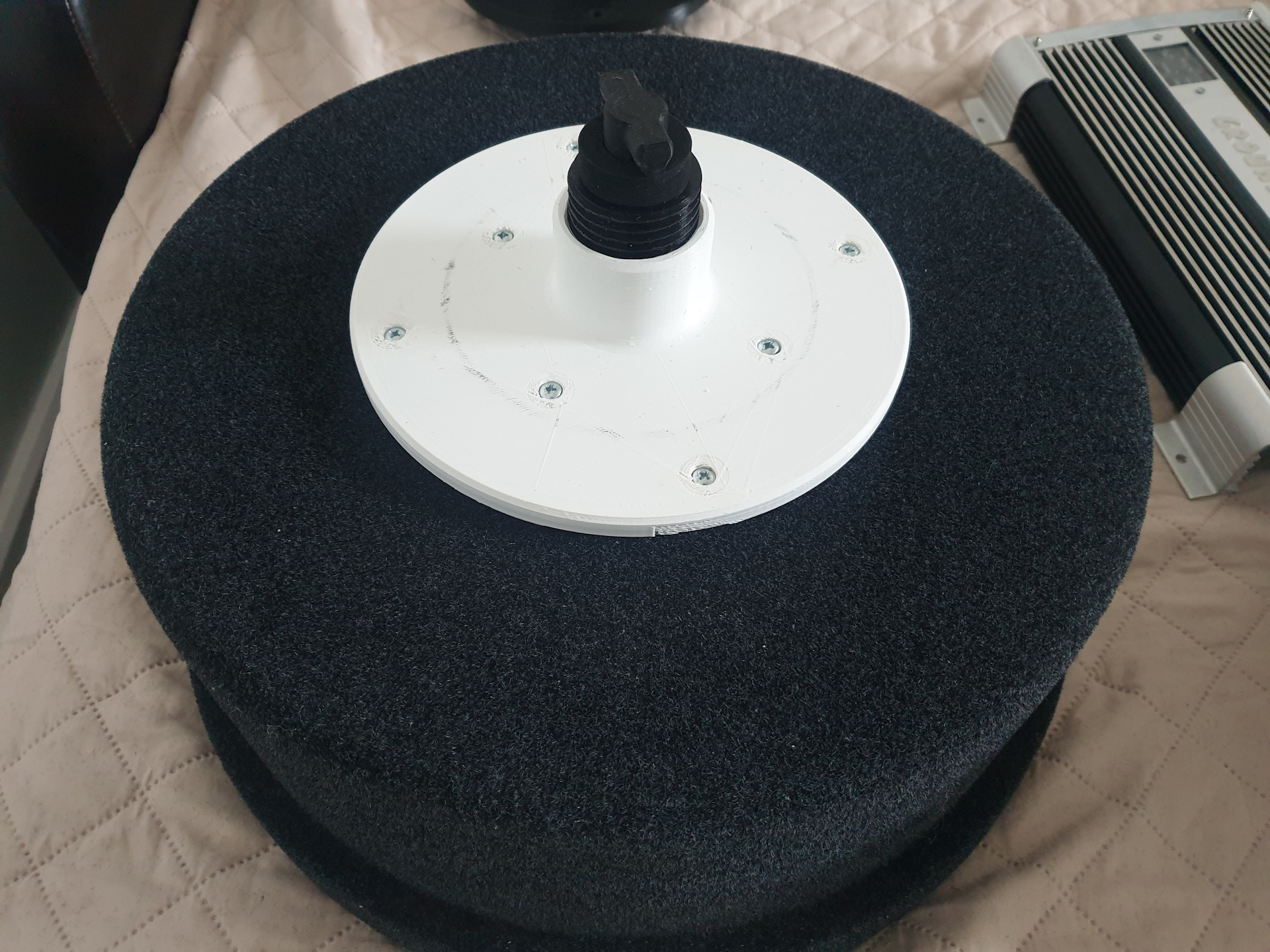

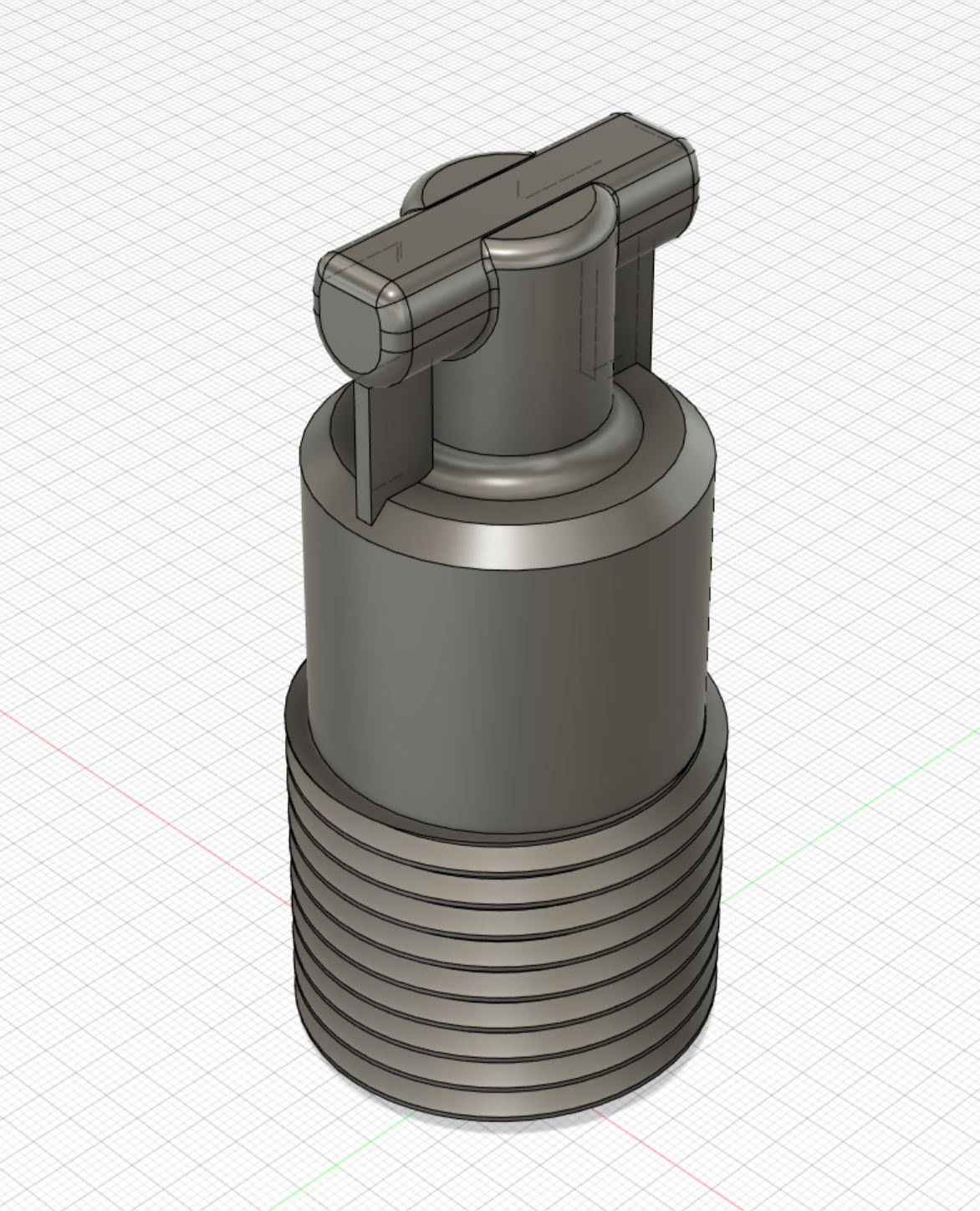

Instead of standard plastic bolt  which holding spare wheel , I printed new one. Shorter , and fixed one. Designed in Fusion 360. Printed with shock proof plastic

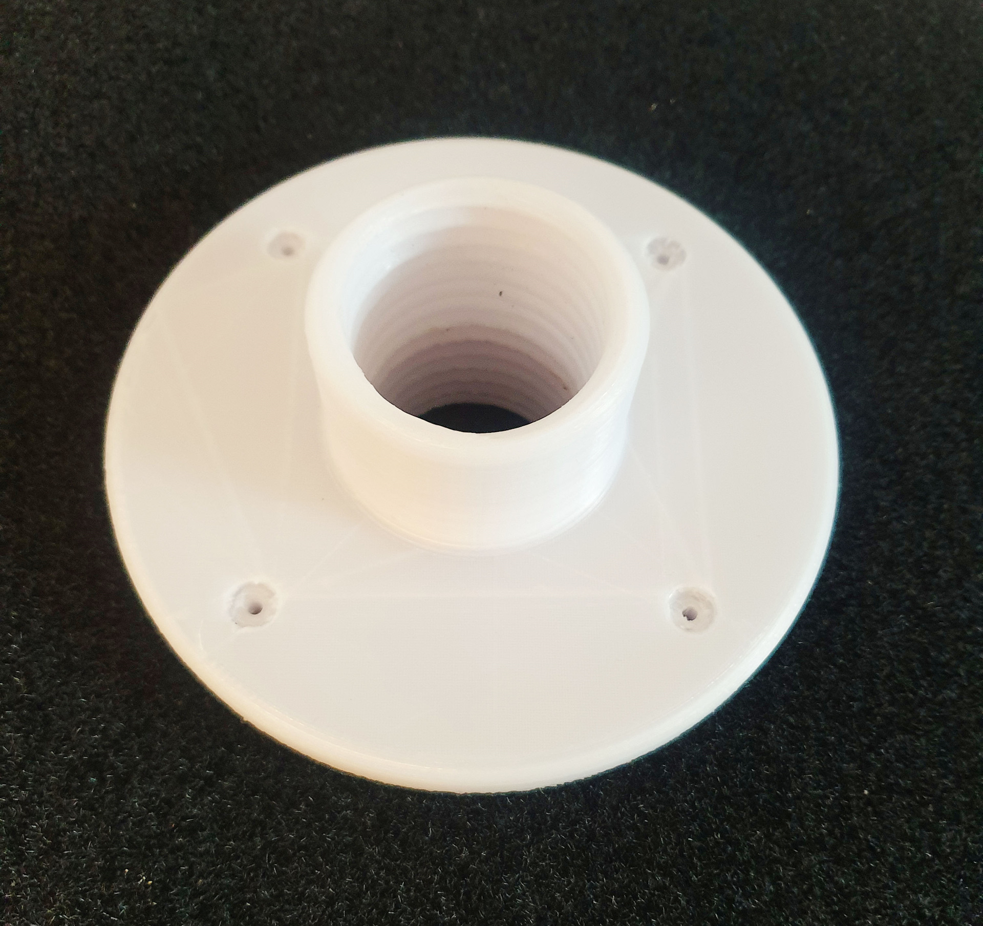

And here is mount to the subwoofer.
Then completed sound deadening exercise under the spare wheel, printed 4 spacers to keep subwoofer tight to wheel on side and installed it

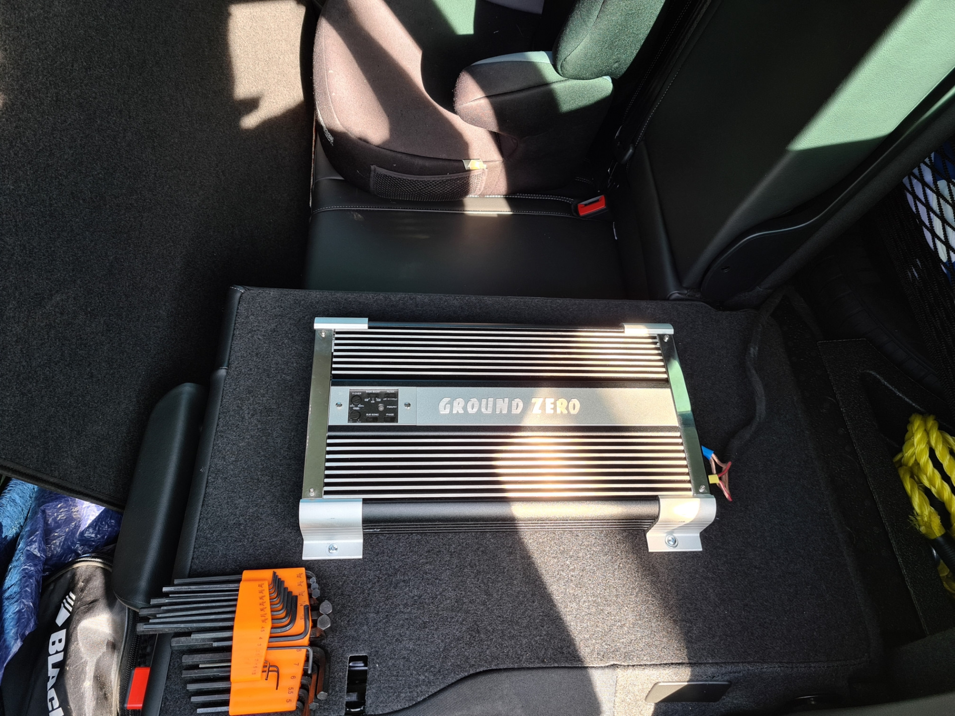

AMP installed on the back pf the left seat with bolts and threaded rivets.

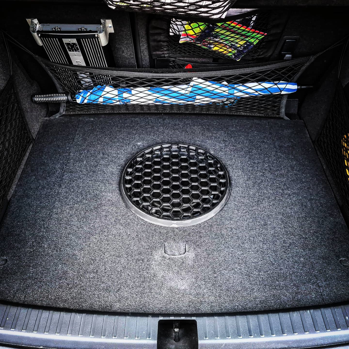

At the end cut round hole in the cover , and printed one more heavy duty grill
Now need to run power for the AMP and RCAs to DSP

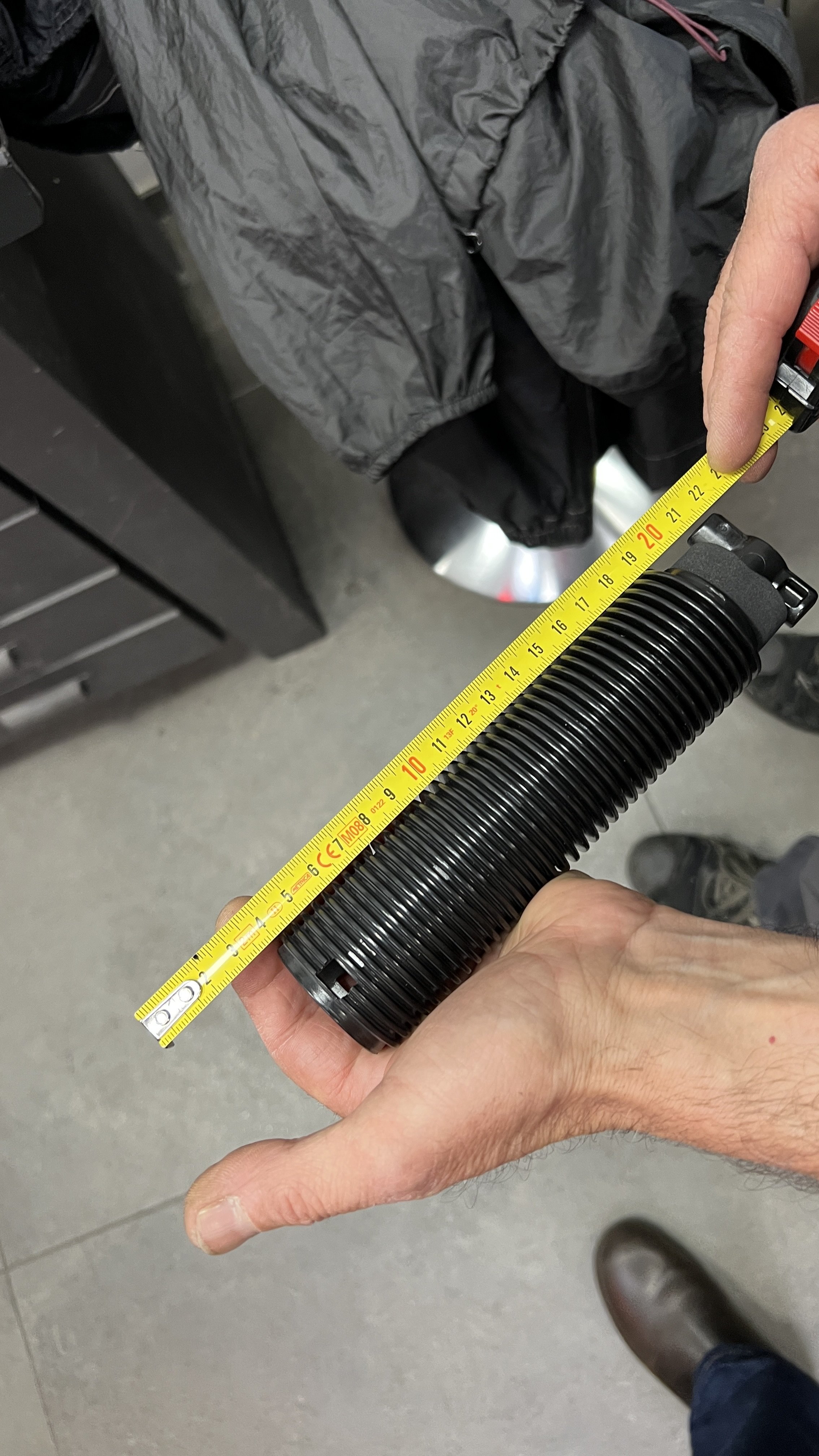

Could You print and ship a longer one (I’ll pay You for it? Starting from OEM consider 1cm longer (or even 2), so I can screw the cover! I’d say I’ll buy 2 of which one is 1cm longer and other 2cm). i mean long 19 and 20cm instead of 18 as the standard one
Let me know!
