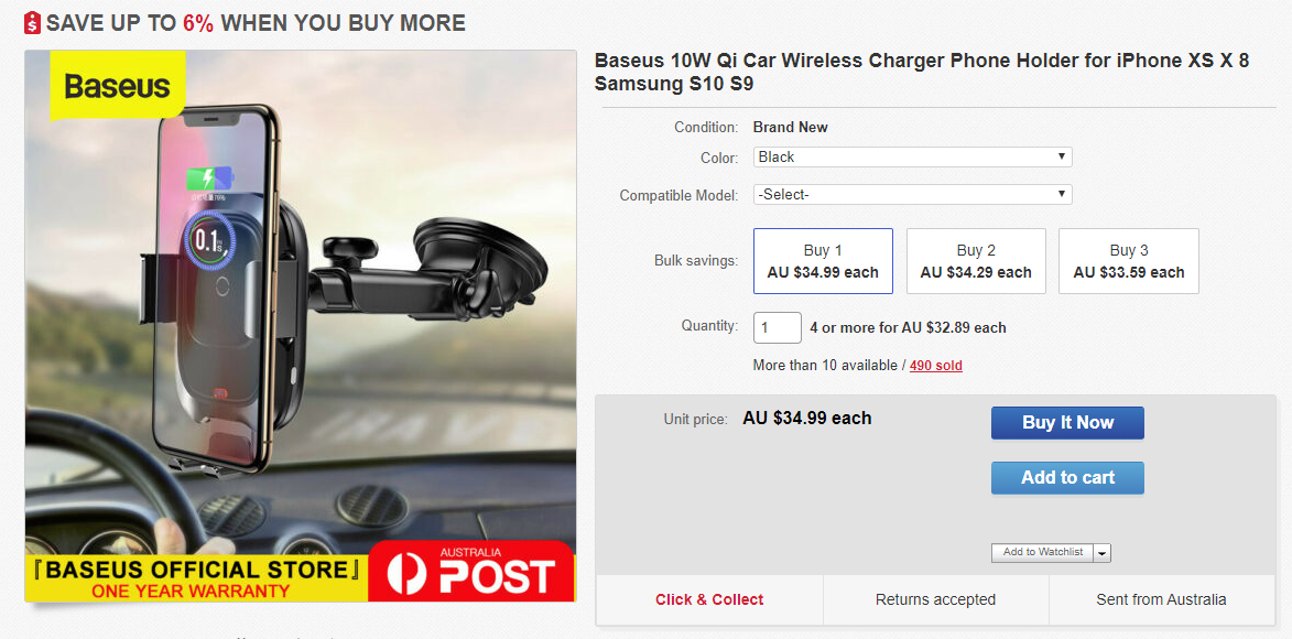

I am now using a Baseus 10W Qi charger that I got from ebay.  It was $35 AU Pesos which is about 50 pence Stirling after conversion.

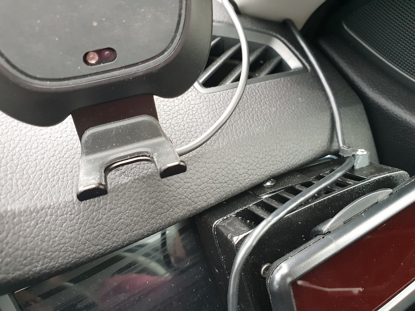

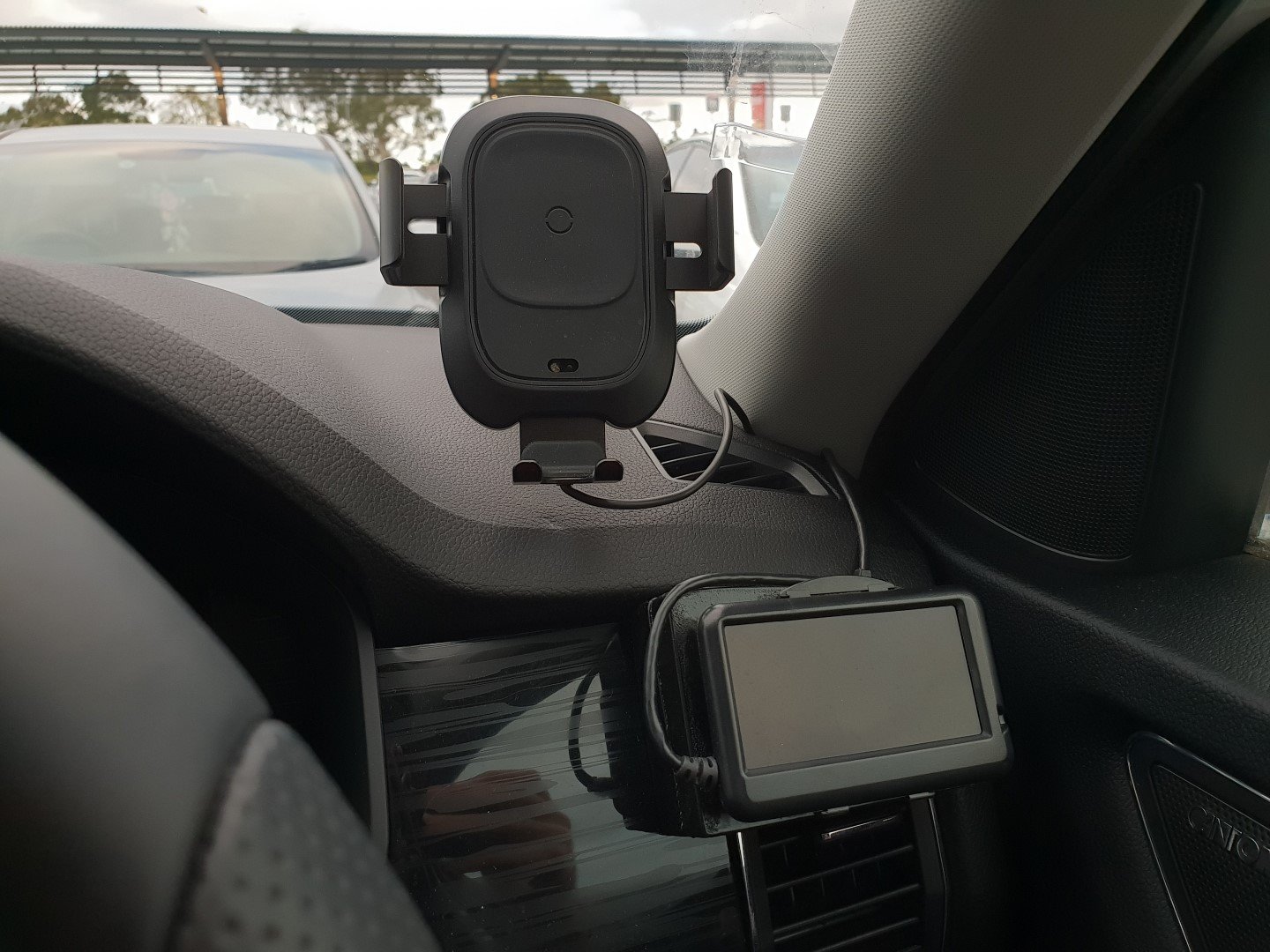

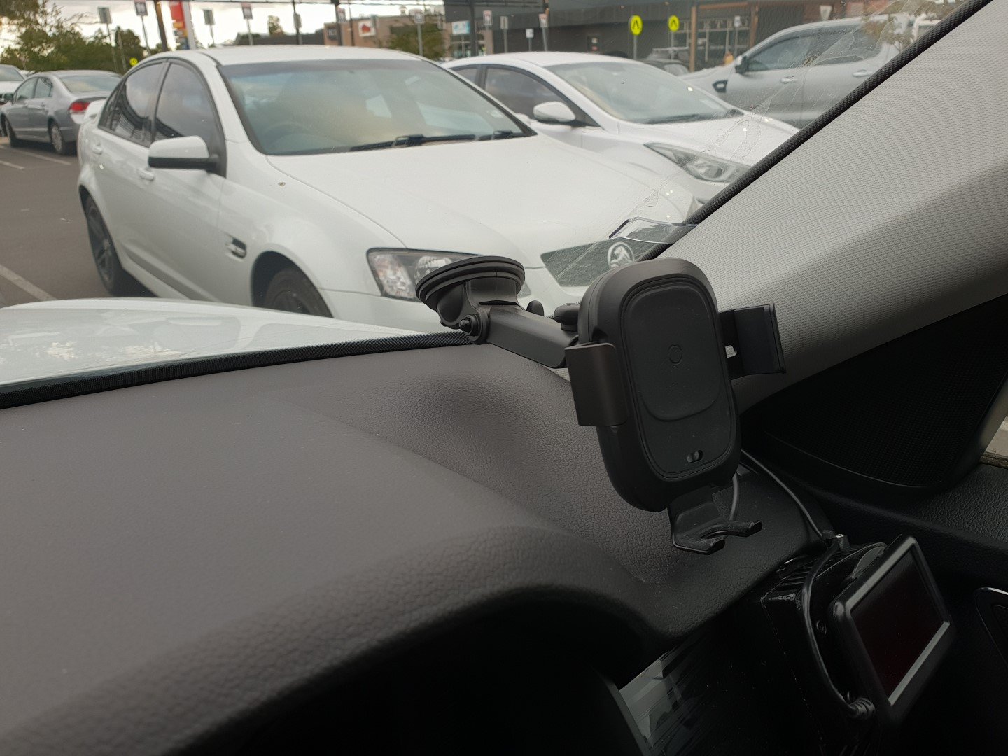

The suction cup works very well (it's really sticky).  The bottom of mine rests on the edge of the dash soft plastic which stops it bouncing around on the arm. The cable started packing a divot in the dash so I've put an adhesive felt pad under it now to spread the weight.

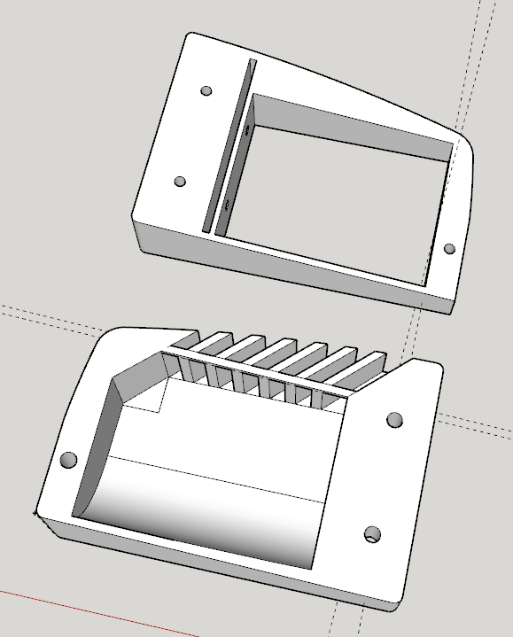

In AU summer when the sun shines on the phone, the phone would stop wireless charging due to over-temperature so I printed a aircon vent redirector that blows the cool air over the phone and that solved that problem.  It also was a handy mounting point for the Ultragauge.  This mounts by some 1mm aluminium strips on the edge that jam down the sides of the air vents.  I will print a thin support from this vent mount up to the Baseus phone mount to support it but it really doesn't need it.  The mount is cantilevered a long way so it bounces a bit on rough roads but not excessively.
