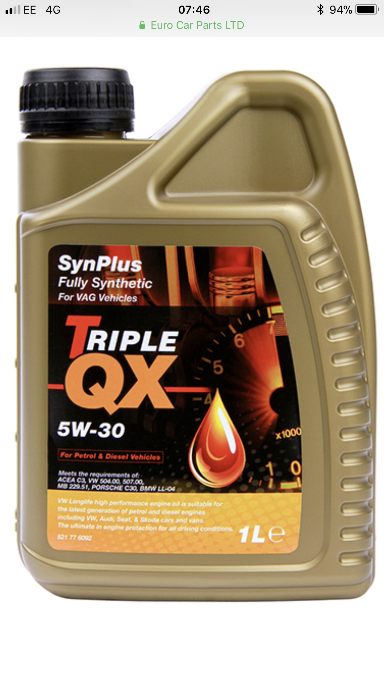

1519881723_59fc1f3e14a29_SkodaFabiaengineoilcapacities.PNG.a7f691f357f02cfe9ea07e59c3b0eff3.PNG.c094bf3723efef199470d9fa9e7a0d07(1).PNG.329ec03ddef86f057838f4837c698970.png

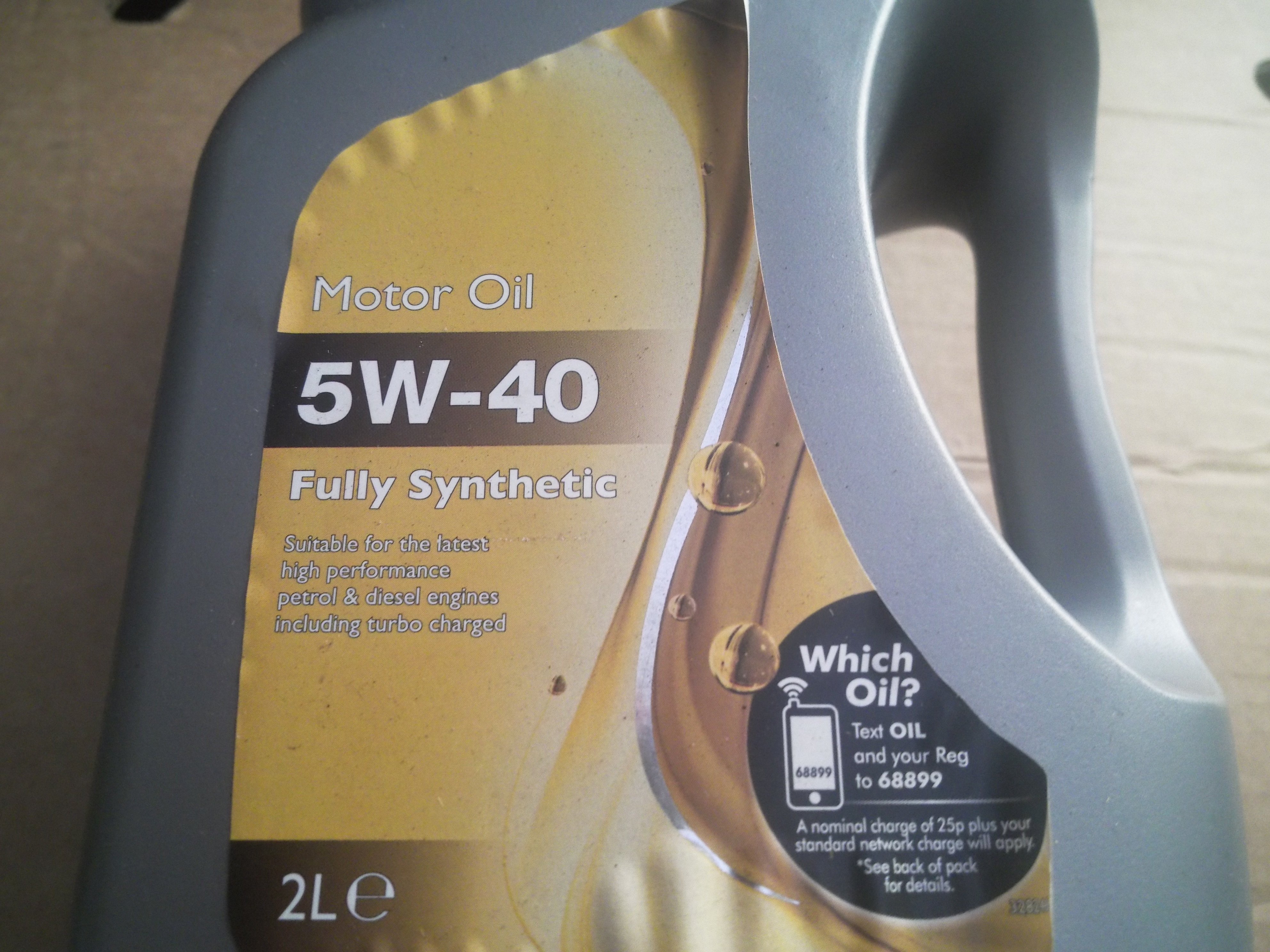

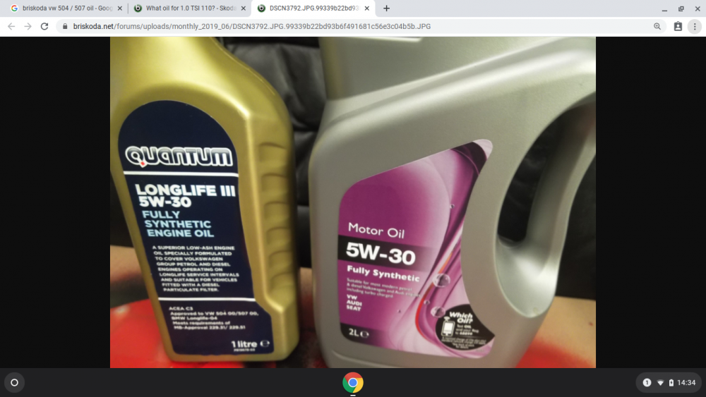

DSCN0630.JPG.1a0b348ee21930609aed64c20d855480.JPG.7c66bc76c402c2f53669b7c9d0b27286.jpeg
