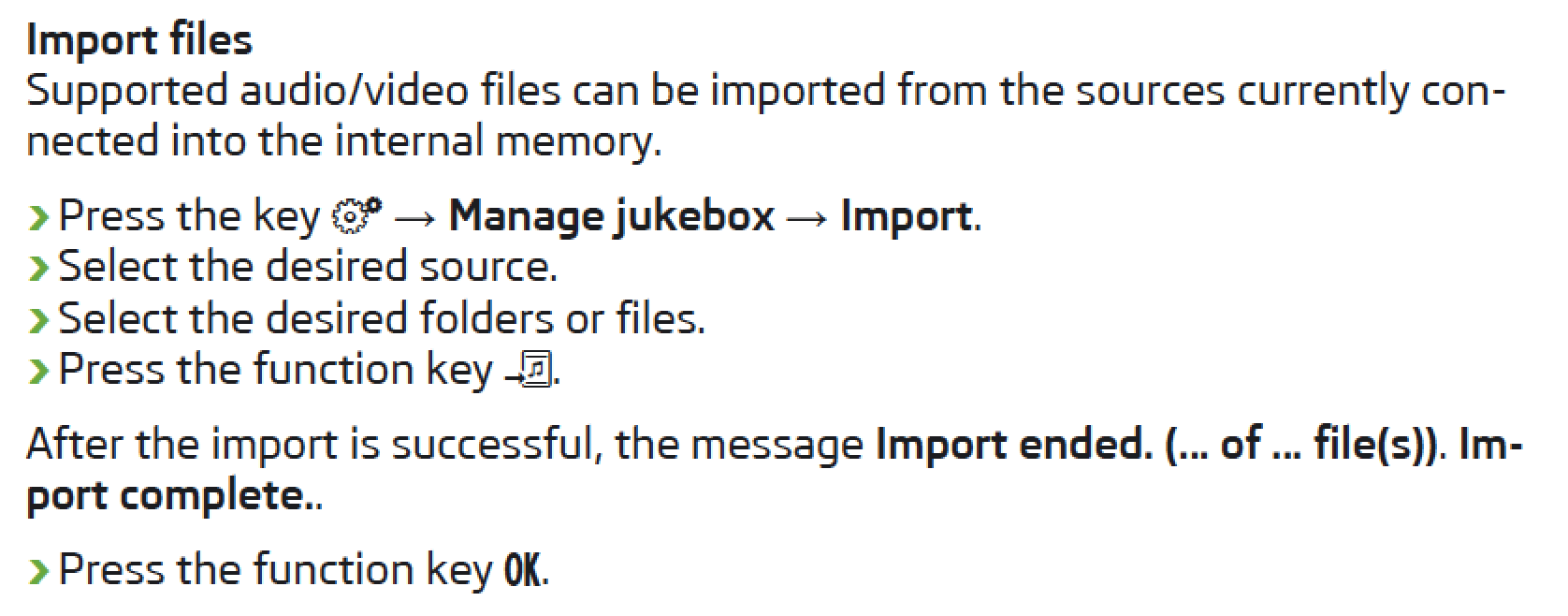

I can't remember exactly how it works, but the source you're looking to play from is Jukebox. That's the internal storage.  In the system you can upload up to 10 gigs of tunes to Jukebox via a USB stick using "manage Jukebox" in the system.
Thanks freelunch - apologies, not always clear how much detail to give. Already tried this.
In the online/downloaded manual it says you can manage the jukebox through <media-settings/cog wheels/manage jukebox>. But in media-settings, all I get as options are 'Manage Favourites', 'Sound', Select Bluetooth audio device', Wi-Fi', and 'Traffic Programme'.
Cannot find any reference to Jukebox in the menus. Mind you the manual also talks about CD/DVD play. Find it hard to believe I've paid £45,000 for a car which has been downgraded in the ICE department! You're right it used to 10.1Gb - I had homes for a bit more...but can't find anything.

Think we've solved the issue...another (yet another) Skoda mess up. The iV marketing, manual, website are all fundamentally  incorrect, and the iV has a new MIB3 Columbus. In a 'step forward' it no longer has CD/DVD, SD card readers, external SIM, jukebox. Just a blank plate in the glovebox.
Only an internal eSIM so every six months it can update maps automatically. Progress eh? Oh, and they've shaved hundreds of pounds off the build cost. And only way for WiFi hotspot is to sign up to the exhorbitant web service through Skoda. My ee SIM data card from the previous car is redundant...with 24 months at £25 a month to run on the contract. Skoda's is about three times the price.
So fed up with their lazy (even dishonest) marketing. But the manual (and e manual) being all wrong is something else. Lovely car, but this is a big disappointment. Jukebox was really useful and meant whoever drove we had sounds, used the SIM, loved putting podcasts on SD for long journeys, Mrs B played her CD's.
