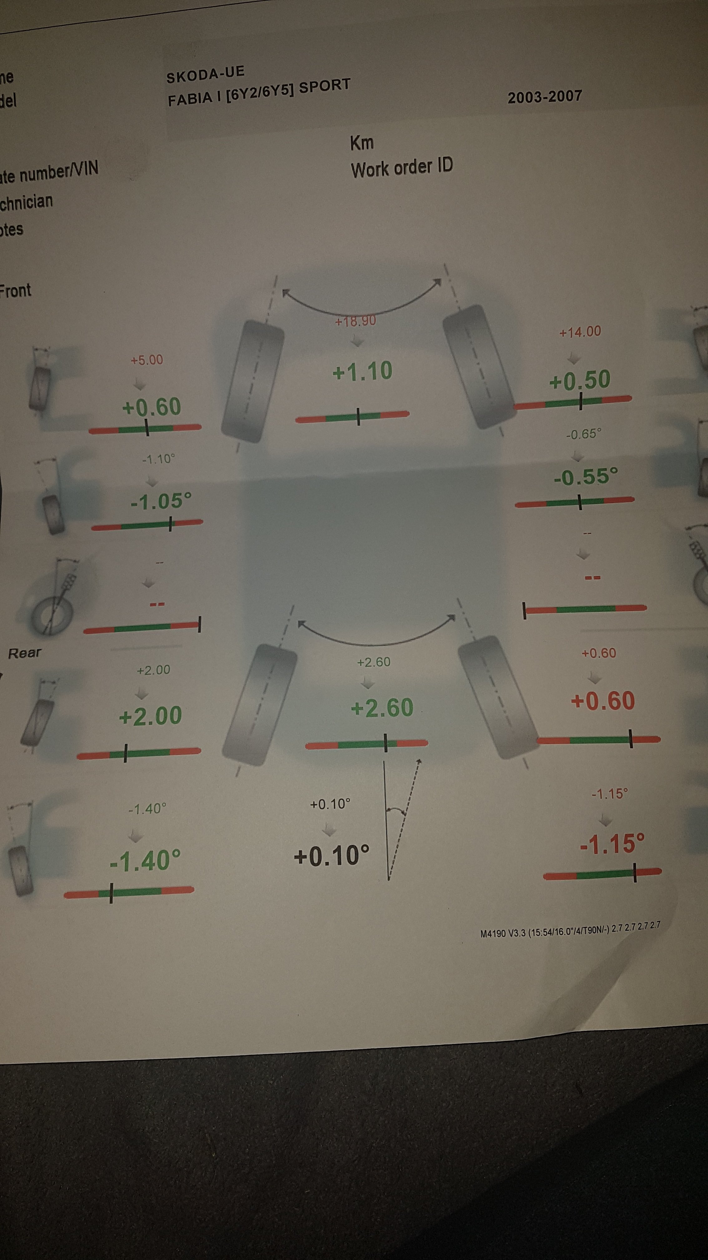

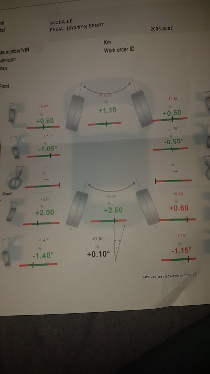

Vrs still pulling to the left

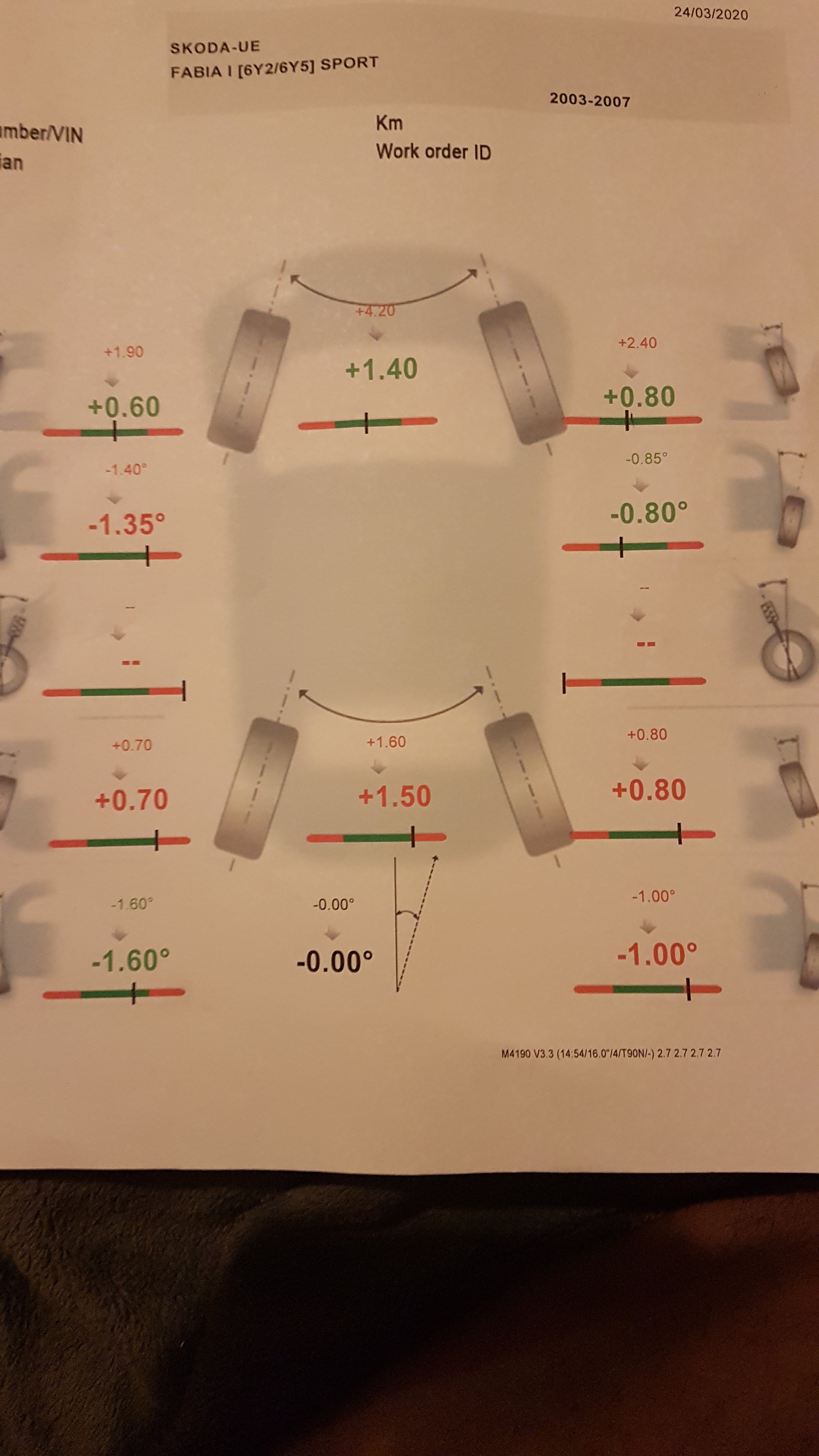

Have you got a printout from your last alignment?
Last alignment done on the 24th march
Blimey Charlie, that's hardly serious, looks pretty straight to me.
Tyres are the dominant factor in these matters, that and the fact that British roads are strongly cambered due to the sheer quantities of liquid sunshine our maritime climate brings.
Mine wears the the front inside edges as well due to negative camber and enthusiastic cornering, it's a running cost I can live with.
