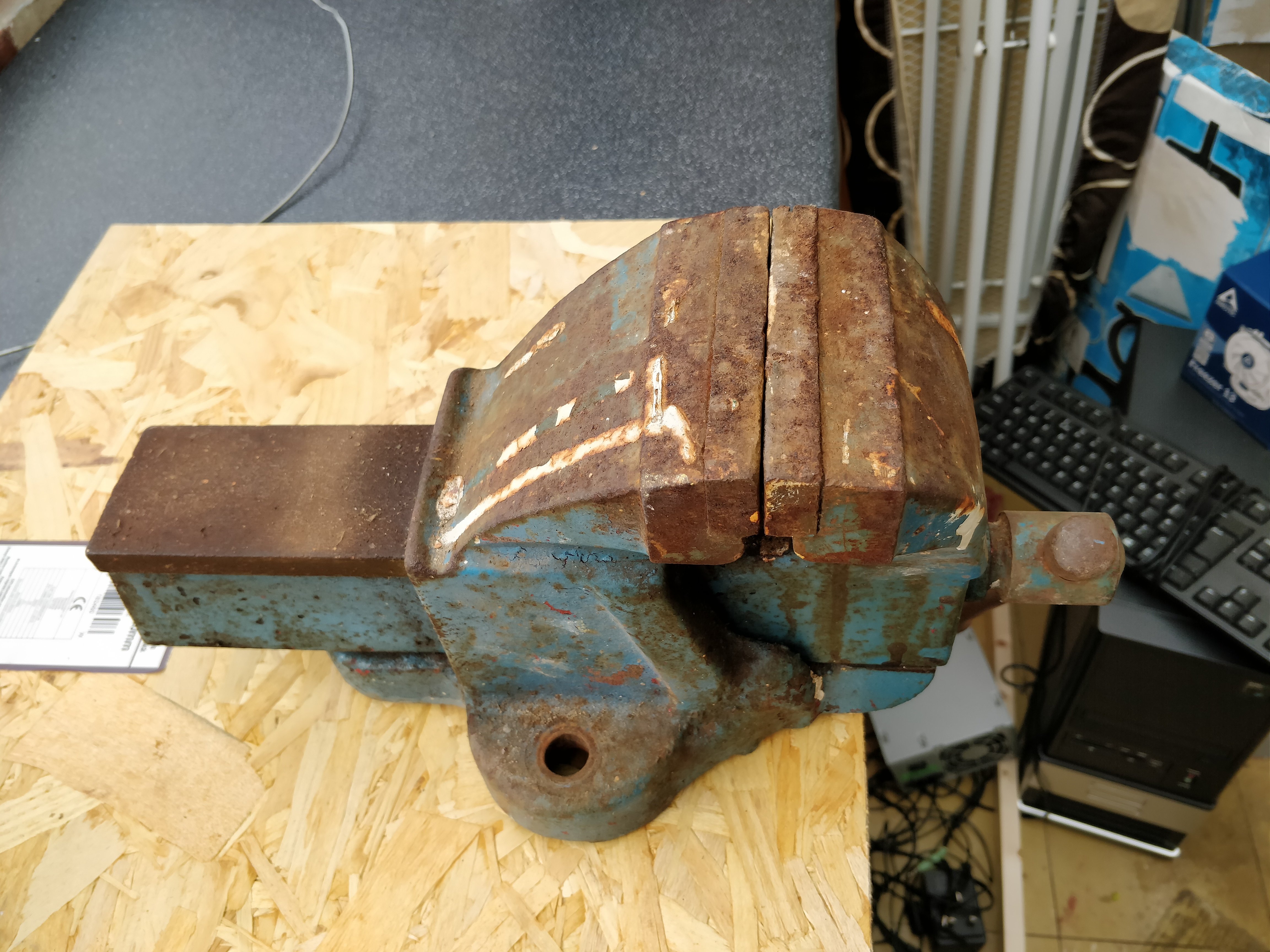

I picked up this vice on eBay for a tenner a couple of months back. It's in cosmetically poor condition, but underneath the "patina" it looks to be OK. So for some reason I seem to have a lot of time on my hands, I thought it would be the ideal opportunity to make the thing a bit easier on the eye.

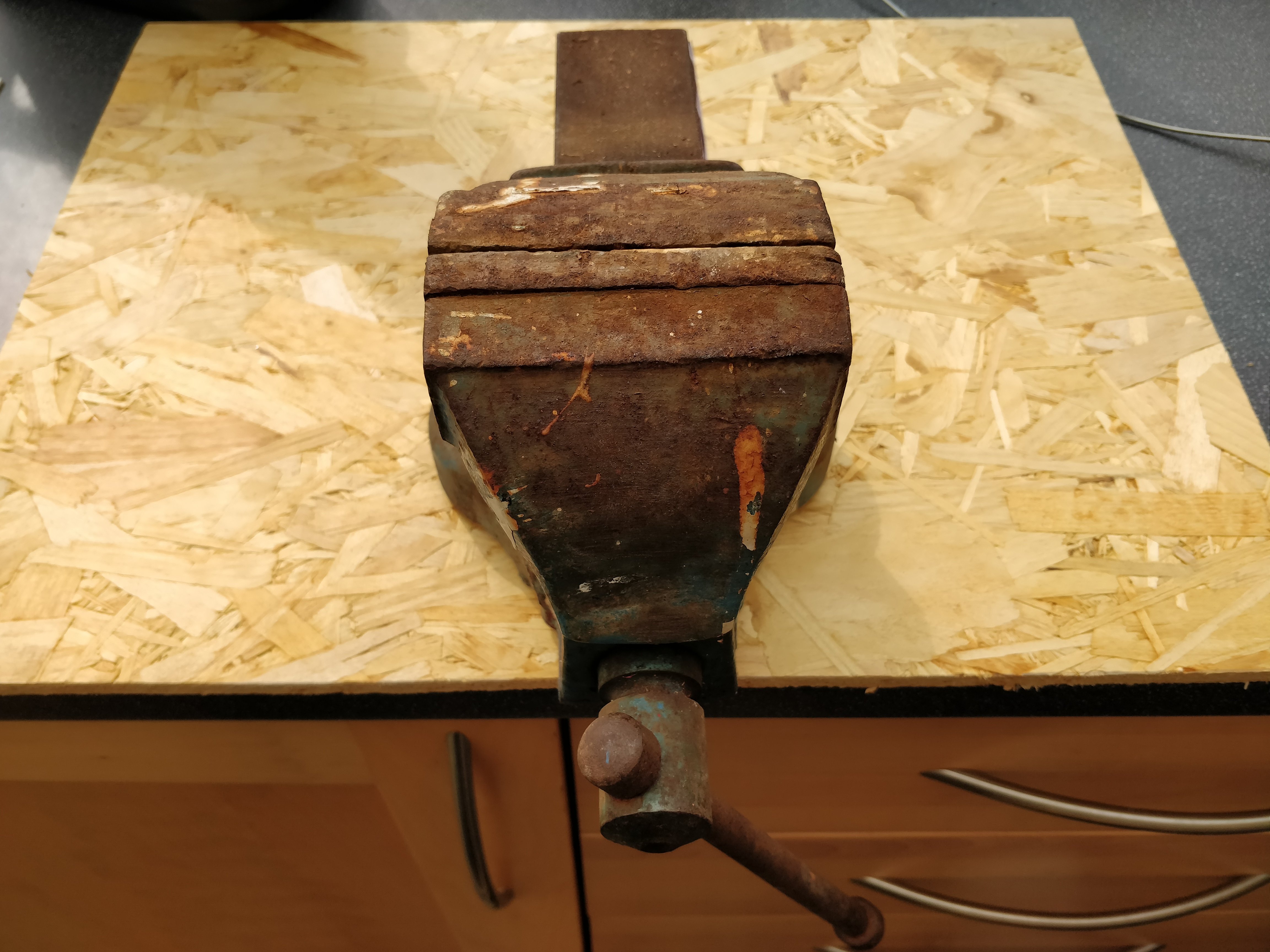

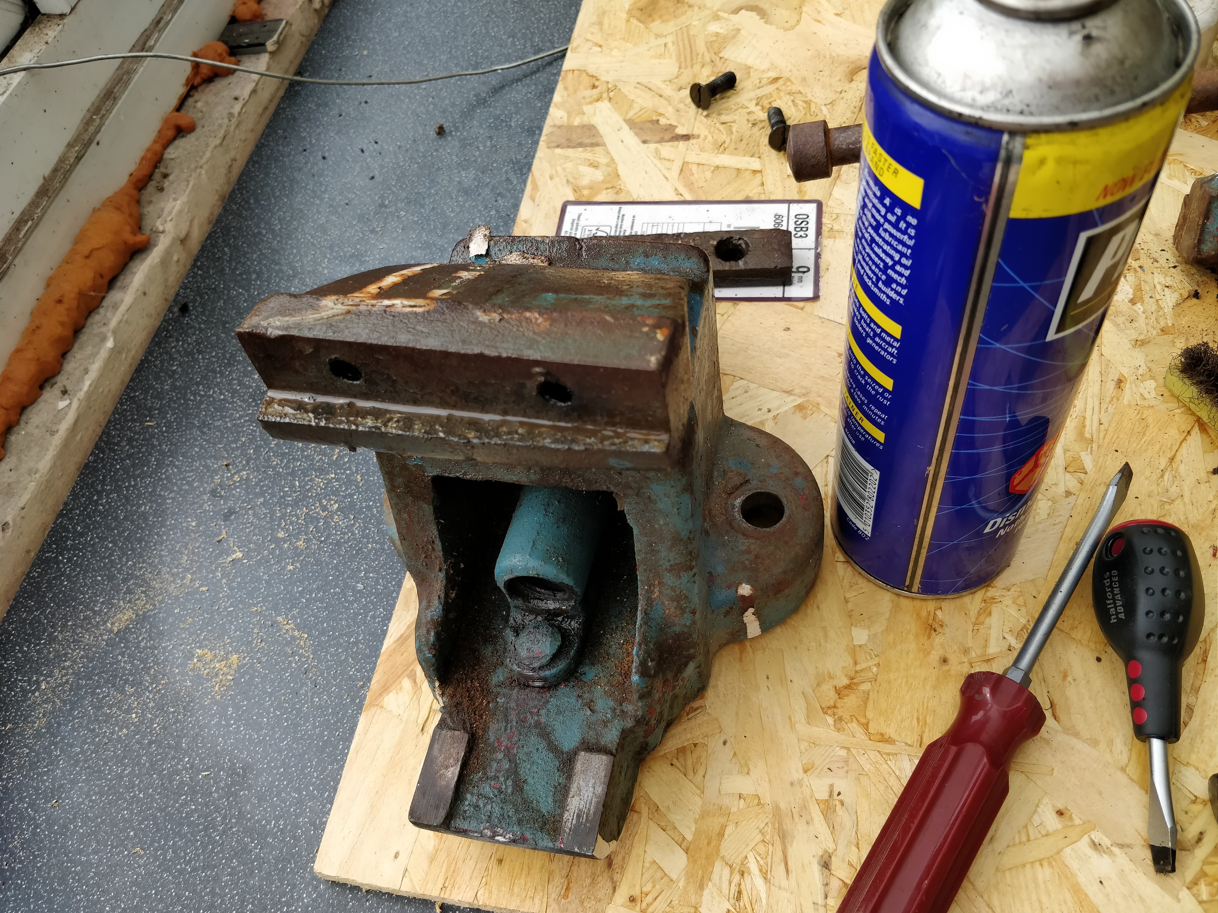

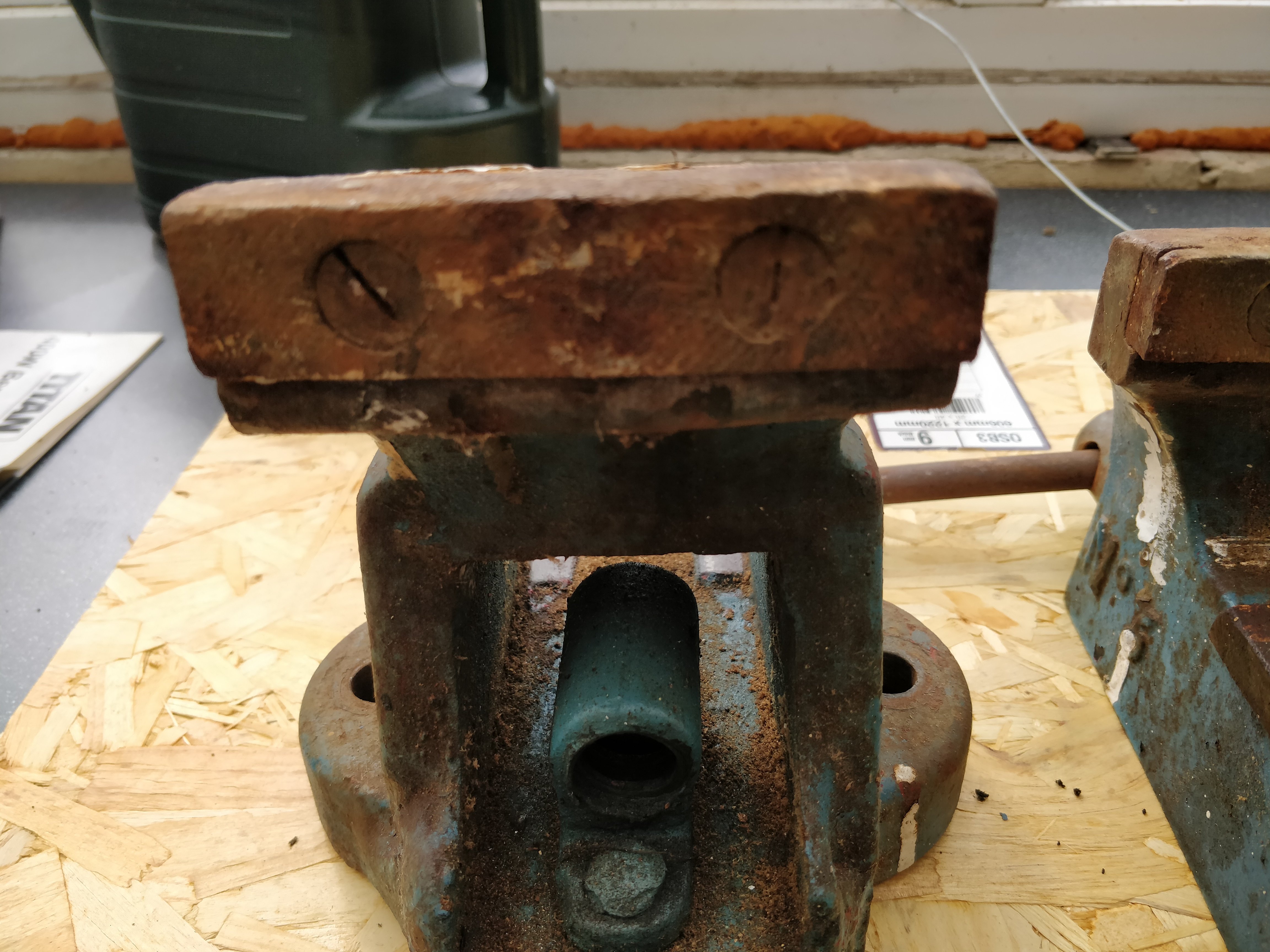

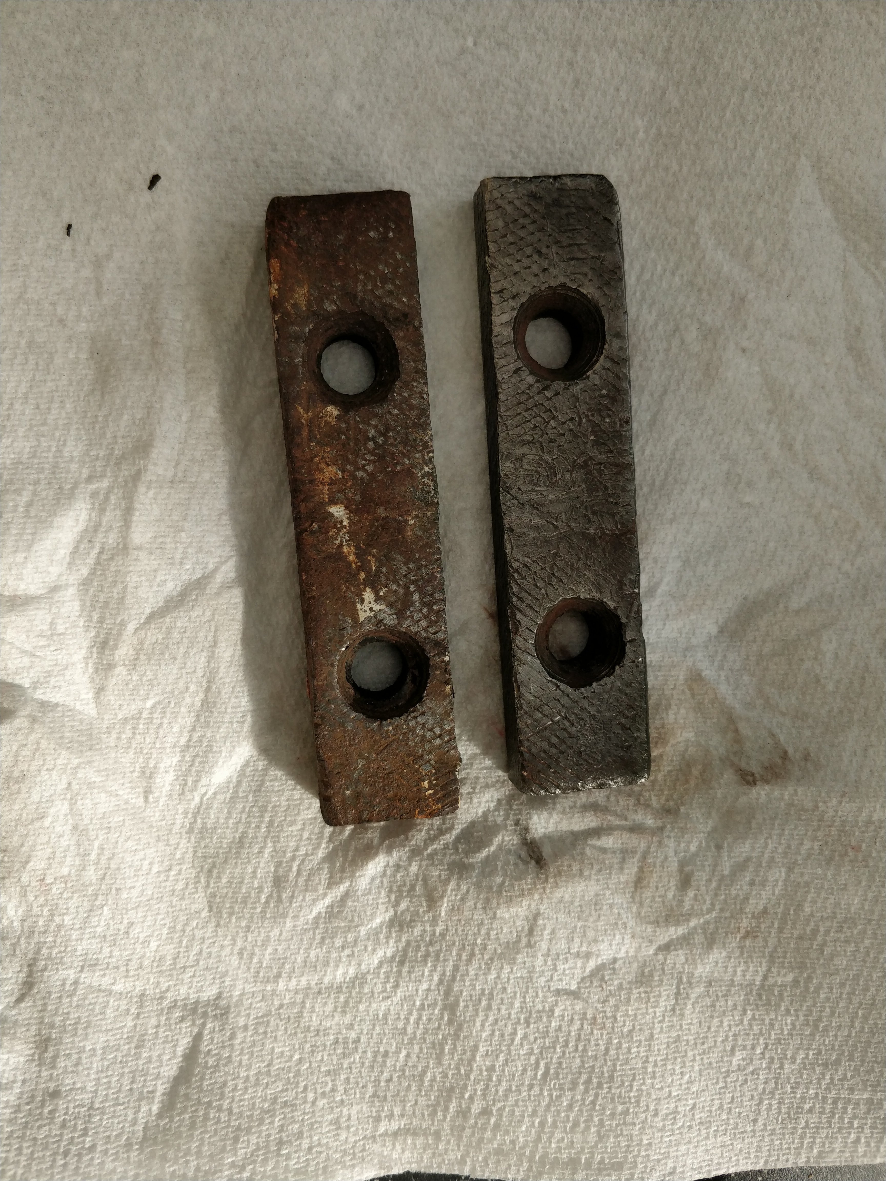

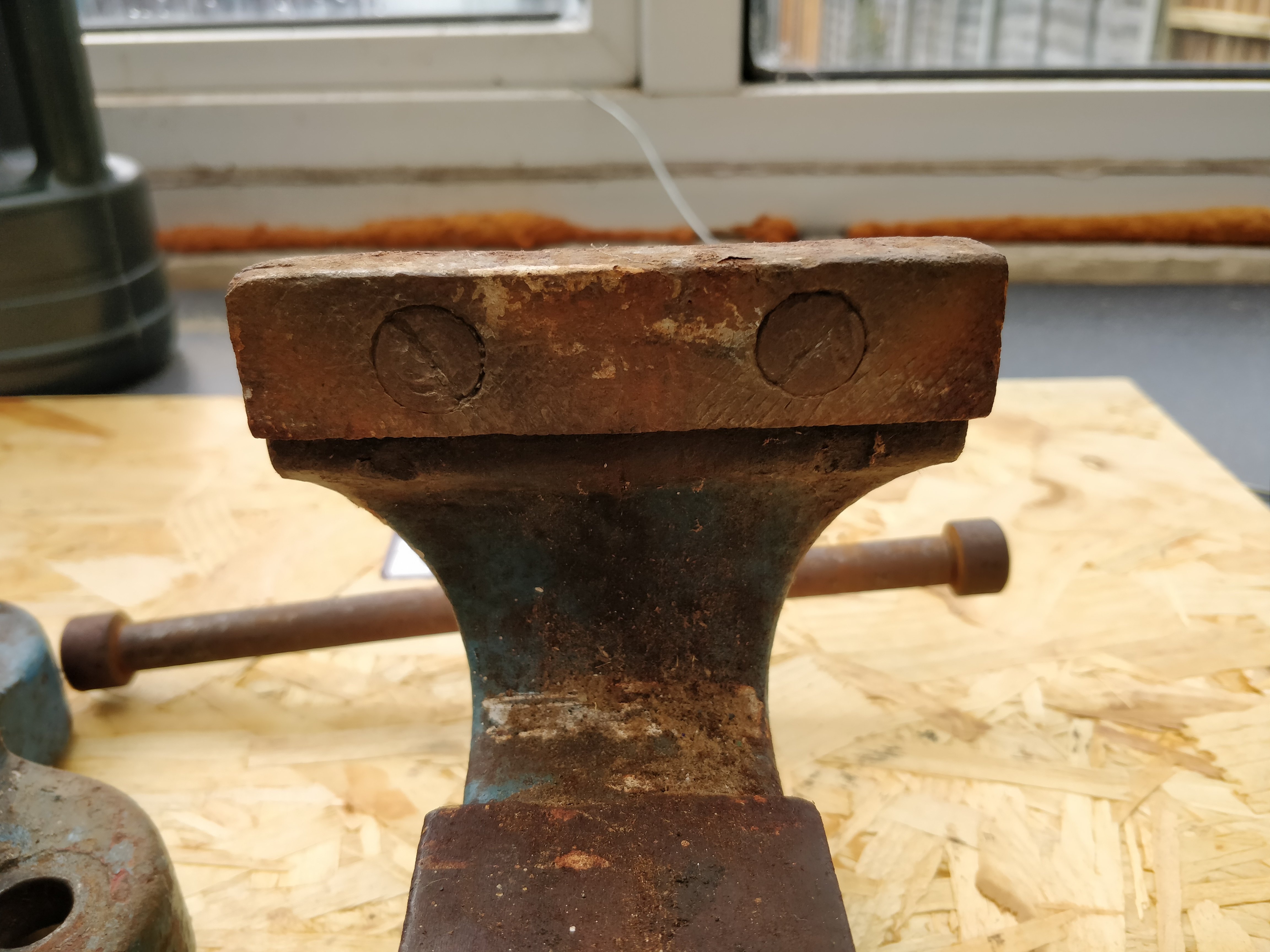

The vice was pretty seized when I got it, the only thing I've done with prior to today is to give it a liberal dose of WD40 and get it moving again. It's filthy, rusty, but the handle is intact and the only wear seems to be to the jaws, which aren't in good shape.

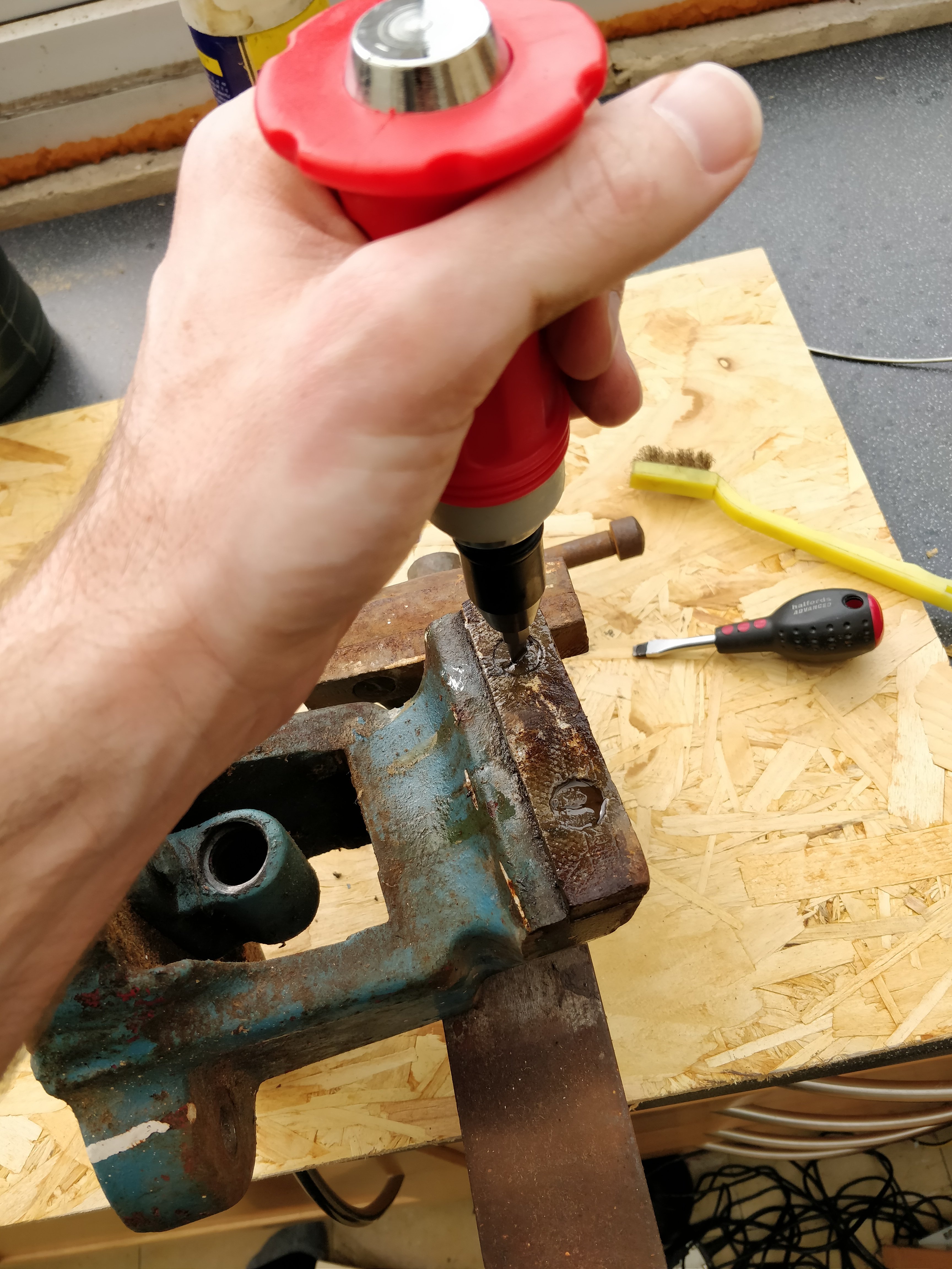

These screws aren't coming out easy 😞
Thankfully I have an impact driver and plusgas 😄
They sure put up a fight, but I'm not easily defeated. I actually broke one of the bits for the impact driver!

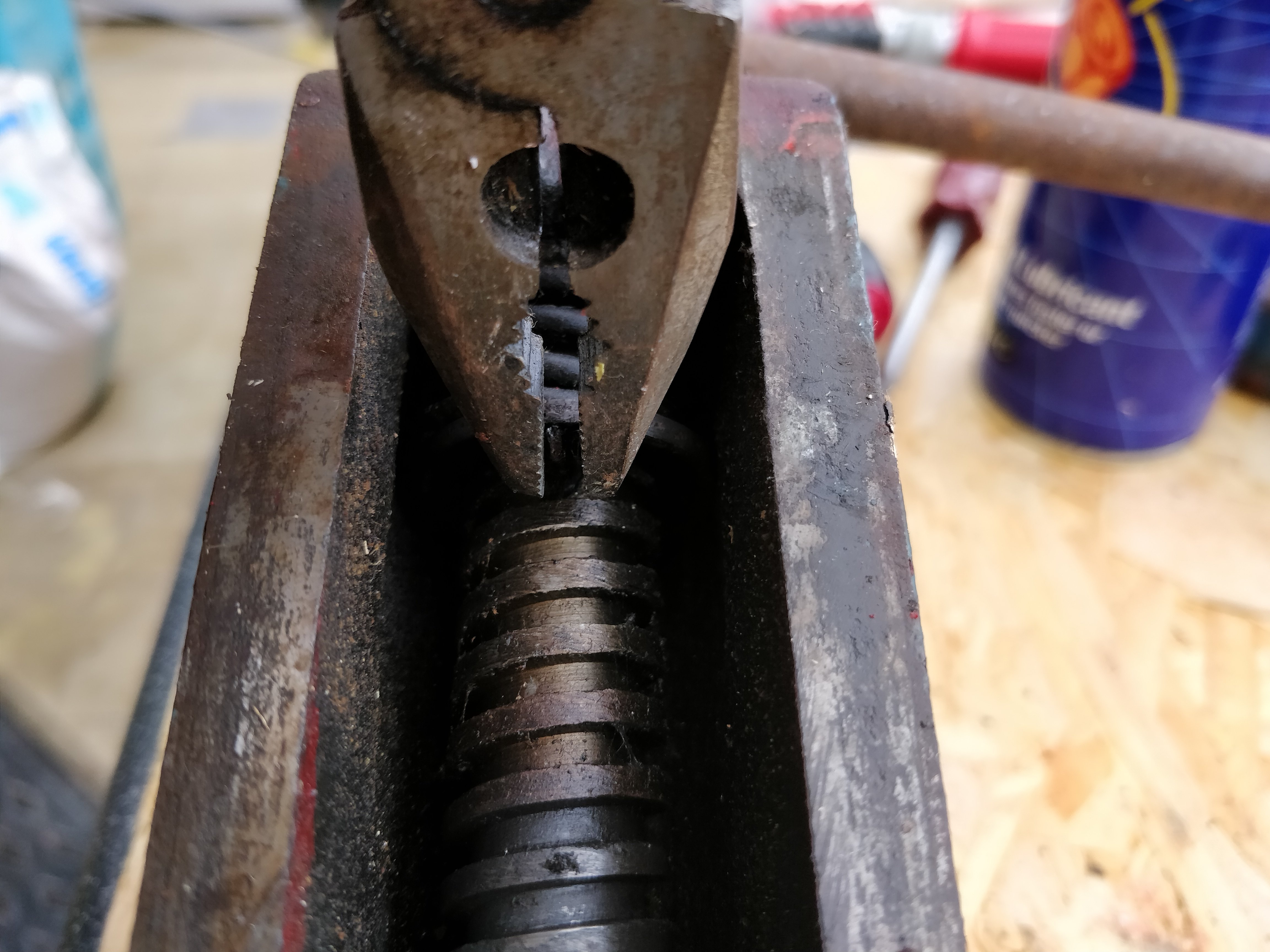

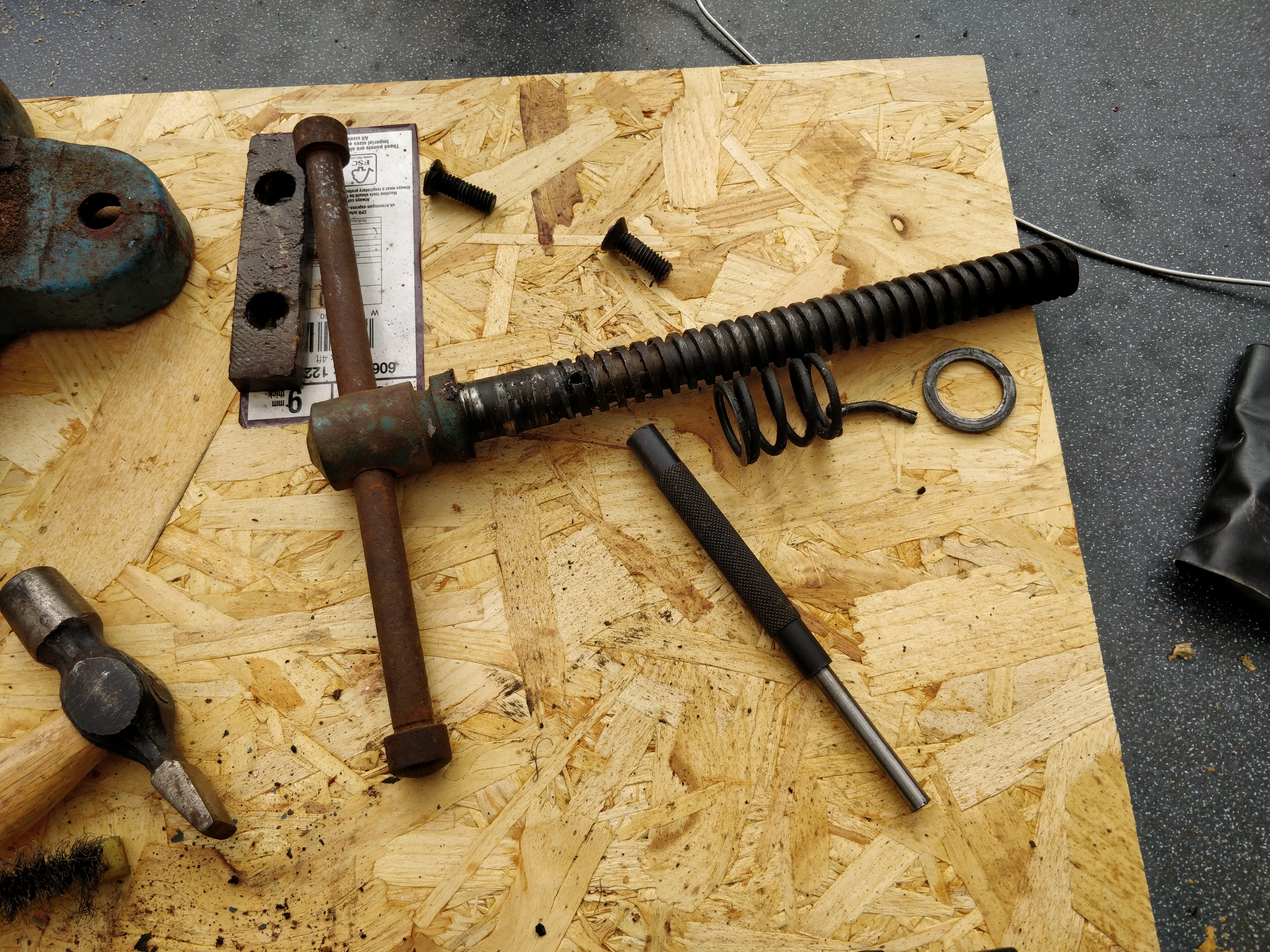

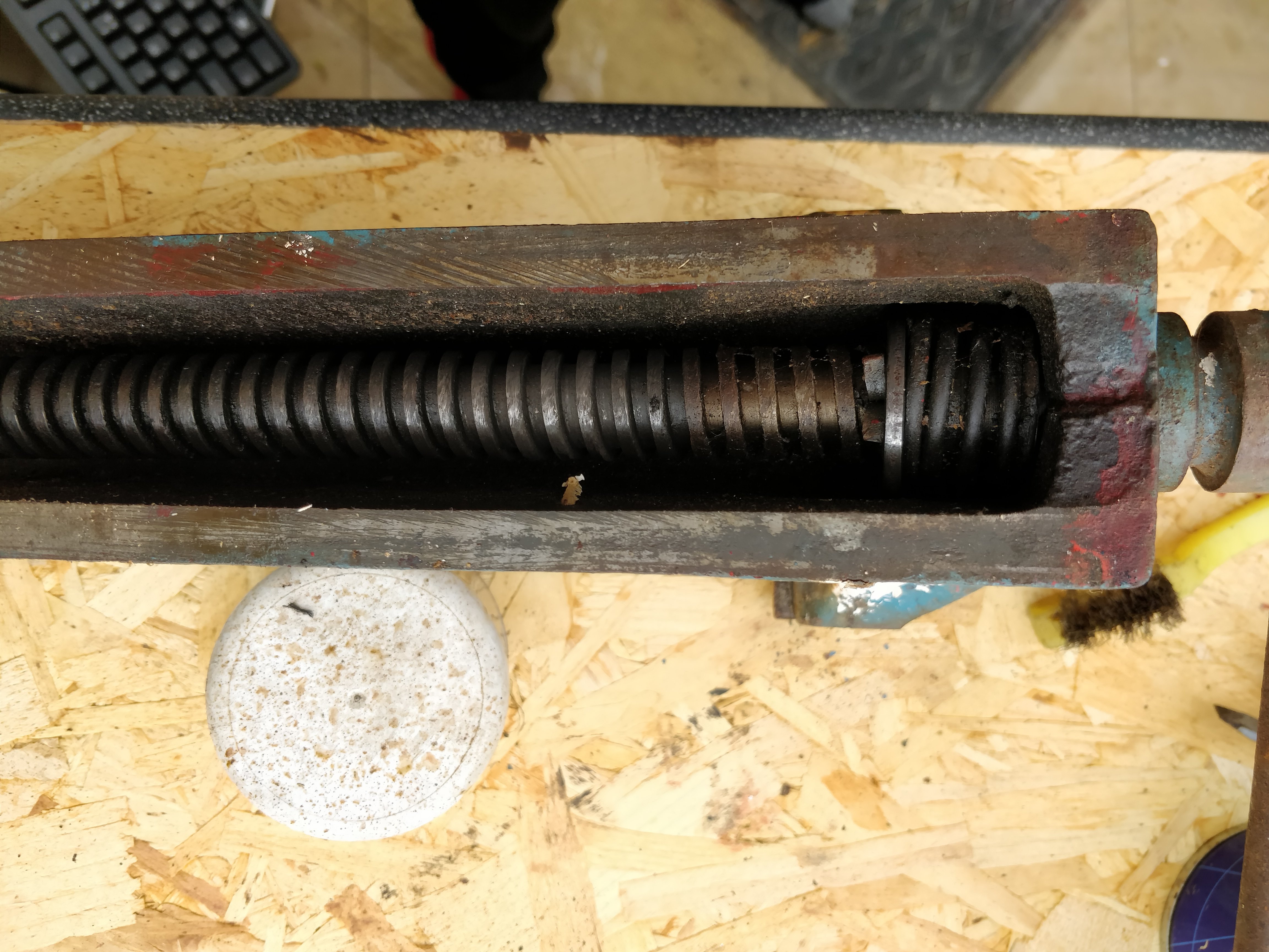

With the jaws off, it's time to get the handle out. This vice has a split pin holding the tension on the spring/washer, last time I took a vice apart it was a roll pin.
Edited by chrisund123
Squeeze the pin together, then take the tension of the spring off the pin with some vice grips, and you can drift the pin out with a punch. This vice has a nice recess for the pin to move into so getting it out was straightforward.IMG_20200328_120522.thumb.jpg.331e363545ae5df48dd4484a3f9a71f5.jpgIMG_20200328_121333.thumb.jpg.dff641ac57528fbb0efb57e274c763bc.jpg

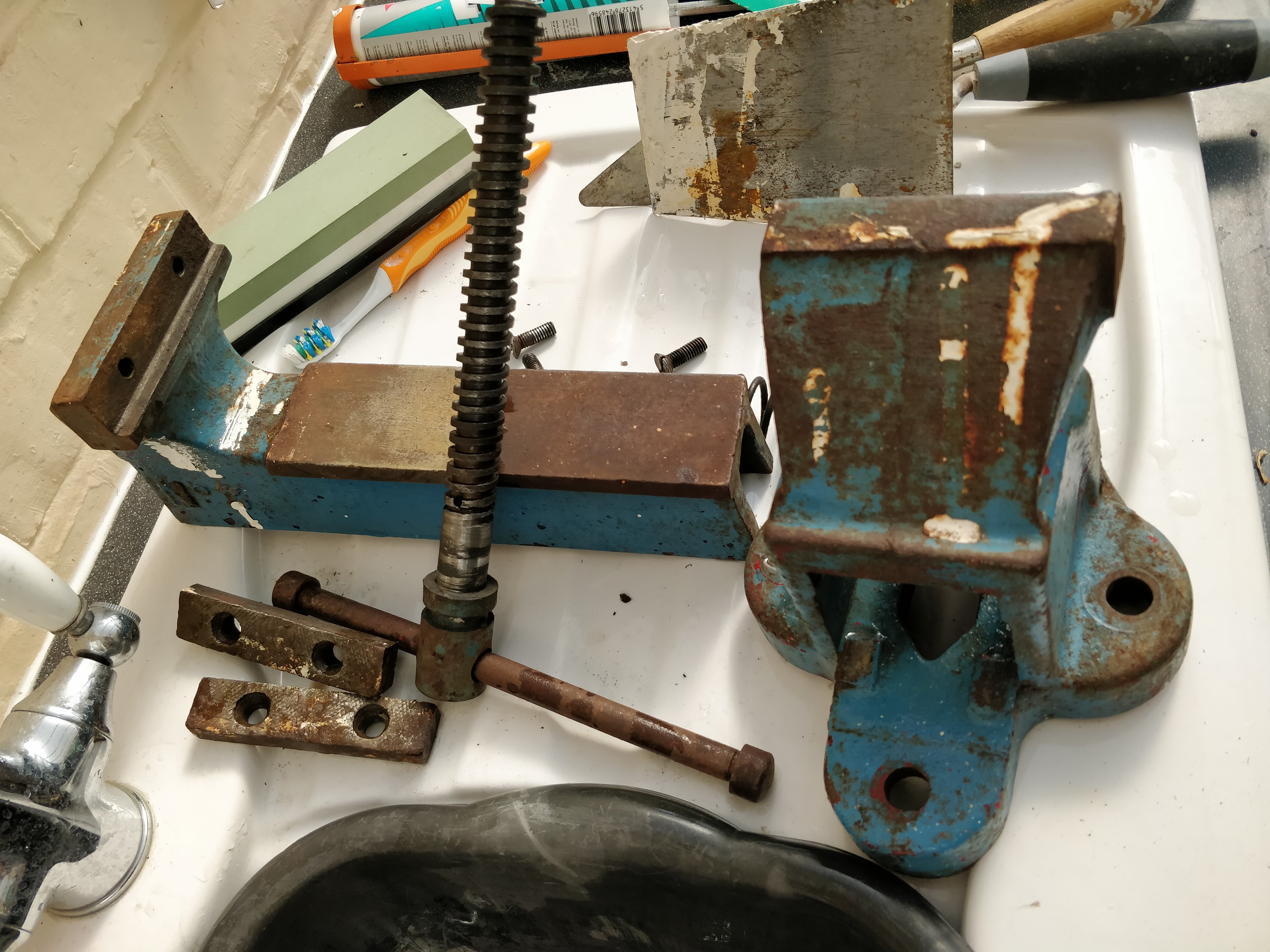

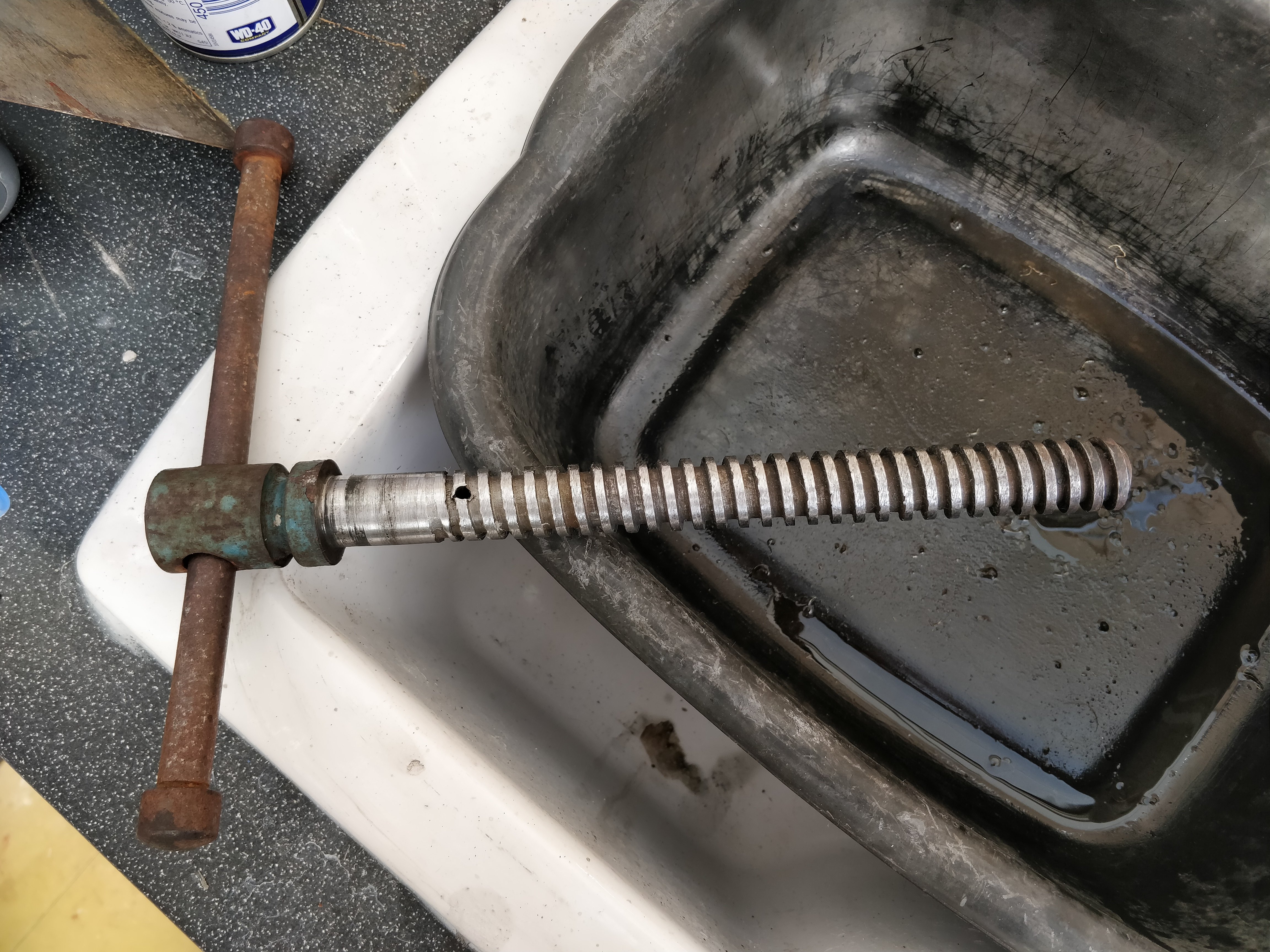

So with the vice reduced to its constituent components, time to give it a quick clean in some hot soapy water. Underneath the crud far more of the original paint is still there than I'd realised. I don't know what make this vice is, but the standard paint for a record vice is "Roundel Blue", and this is close sort of match I think. I guess the vice is a cheap knockoff of a Record, it looks very similar.  Despite being a knockoff it's a pretty hefty bit of kit in it's own right.

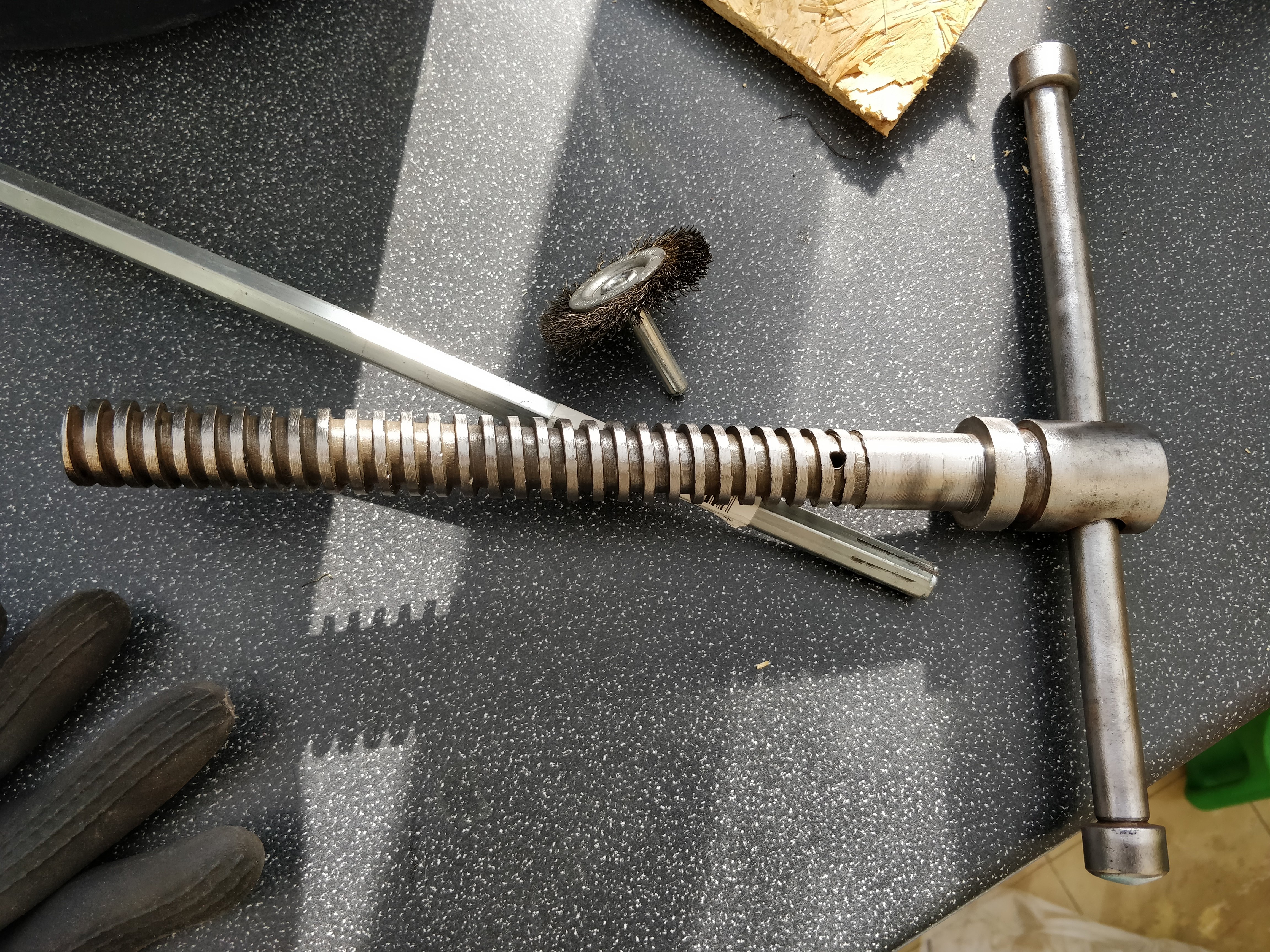

The acme screw cleaned up OK with a bit of sanding and wire brushing, no chunks missing out of the thread and the handle is pretty straight, all signs the vice hasn't been abused too much. The moving jaw, although rusty, doesn't seem to have been used as an anvil either which is a bonus.

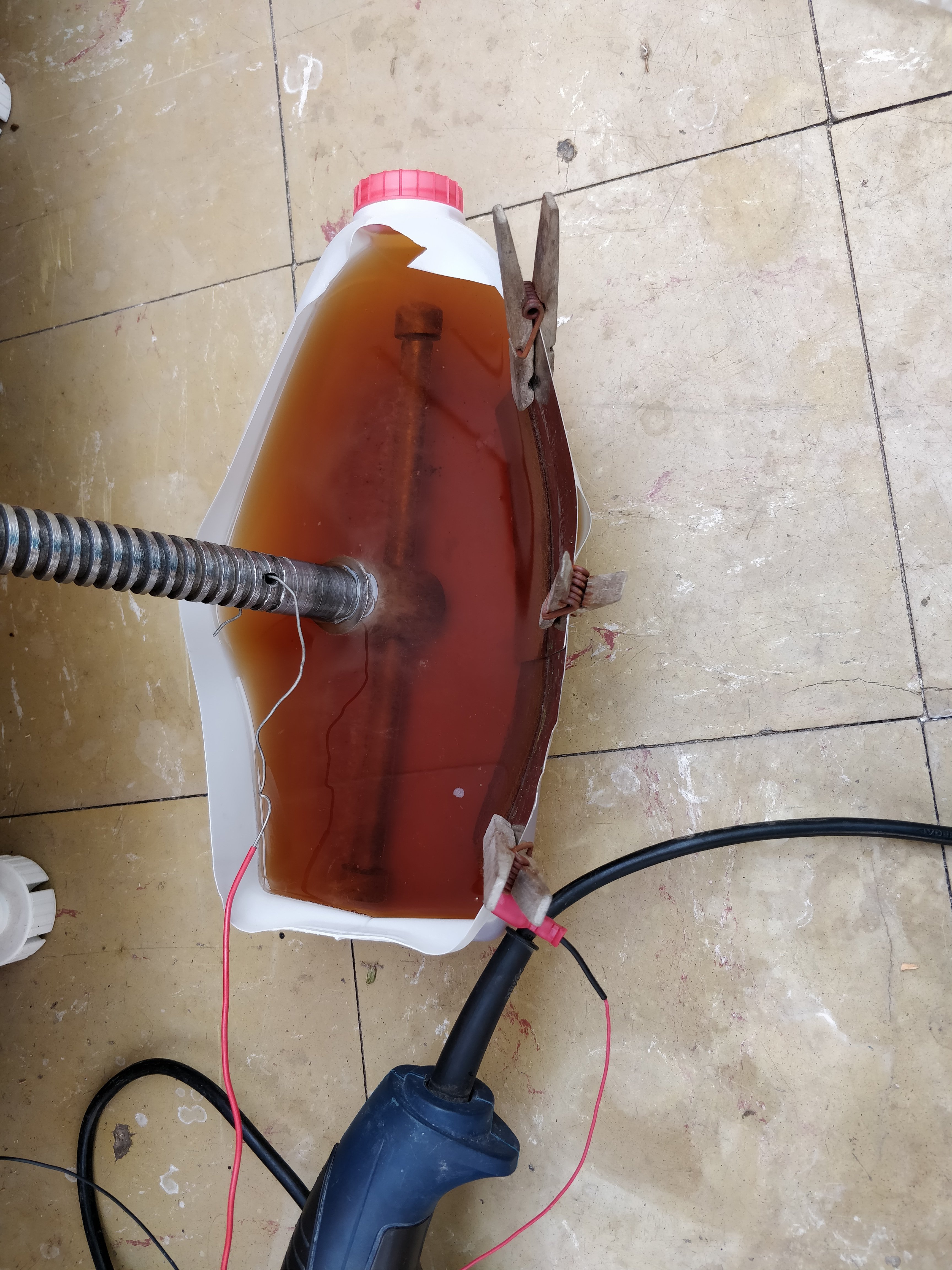

A bit of wire wheeling later and the handle is looking a lot better. I want to stop it getting rusty, as it's a moving part painting it isn't an option, so what shall I do...
Time for some nickel electroplating! This is actually really easy to do at home. Sadly in this case, my electrolyte is contaminated (I tried electroplating some cast iron a while back, which I've since learned isn't a thing) and while the handle has certainly been electroplated with something, it doesn't look very good.
I shall make some more electrolyte in the future, it's quite simple - just white vinegar, salt , nickel and electricity. Usually it's a lovely shade of electric green, not looking like the contents of the toilet that mine looks like. Sadly there's restrictions on buying loads of food items at the moment, so it will have to wait!
While I was waiting for the handle to electroplate, I wire wheeled the vice jaws. Pretty sure these have had it, I shall make some nice smooth soft jaws out of brass bar, and some new screws too. The screws are a strange thread (3/16 BSW I think) and not easy to come by these days. Most cost effective way I found last time was buying them from china on ebay, and putting up with the delay.

You have got them out now but the way to do it is use the impact driver bit in the screw slot but with the jaws clamped on it then release the screw 1/4 of a turn with a spanner on the flats of the bit.
I have restored 2 vices in recent years, very satisfying, one was huge to replace the one on my steel coppersmiths bench that I broke 42 years ago & replaced with a smaller one, never in all those years did I find one the right size but got one locally on e-bay for peanuts because it was collection only, too heavy to package & post.
Thanks for the tip, I'll remember that if I ever take on a 3rd one!
I bought the impact driver for the first vice I did up, a record no.4 with screws in a similar sort of state. Much to my surprise they came out really easily, unlike today!

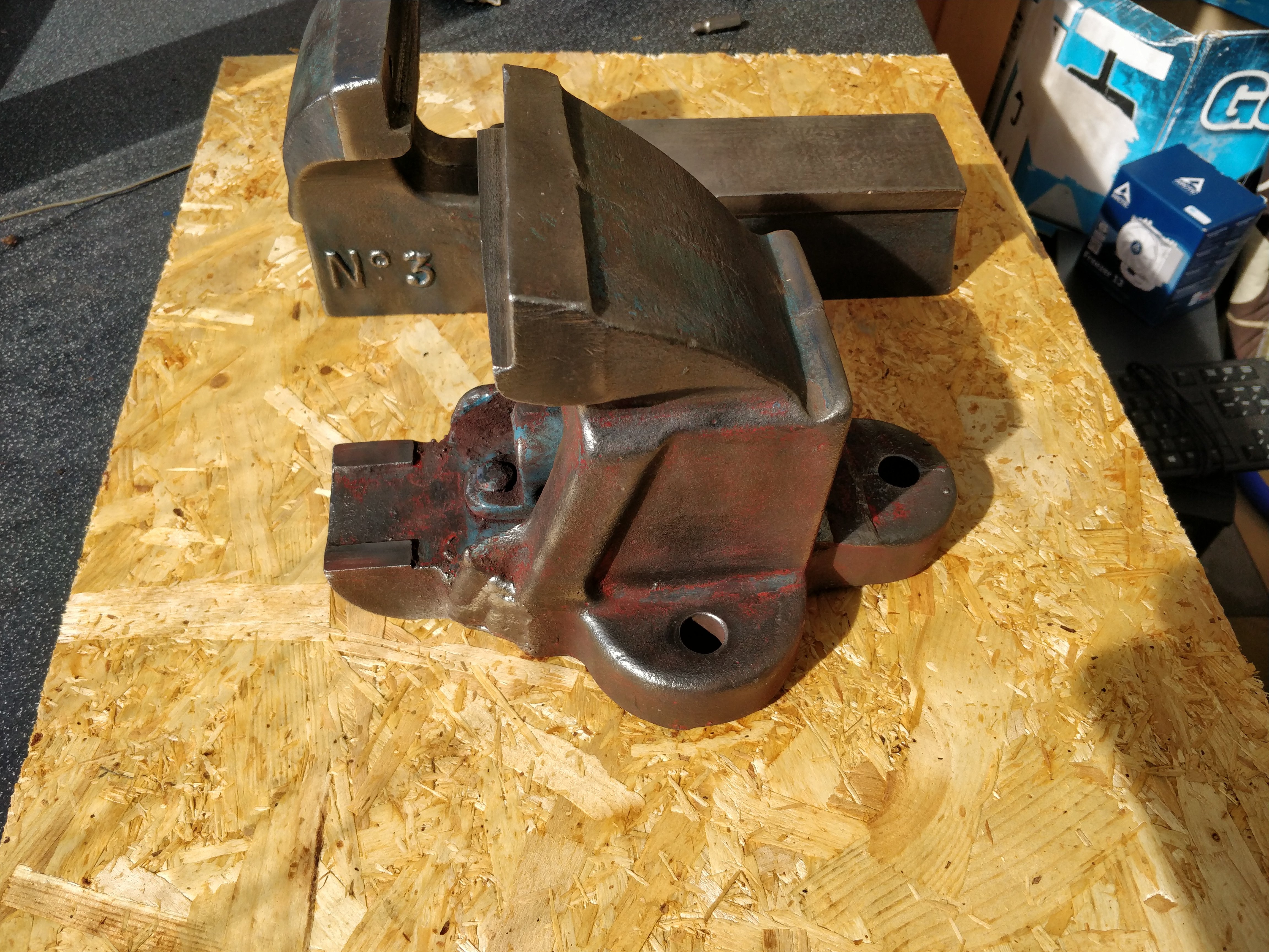

Another day in quarantine, another day of vice restoration :D

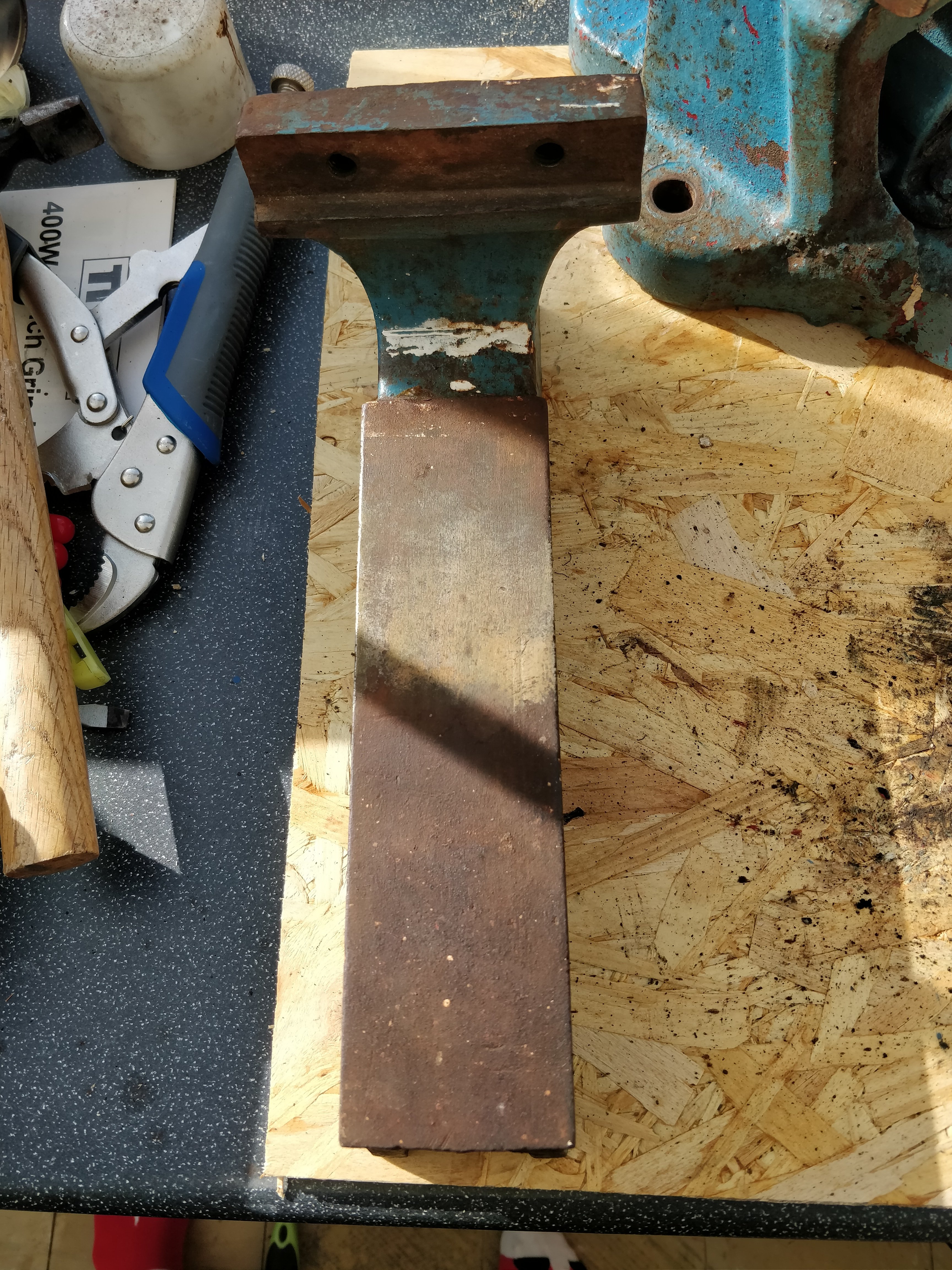

The machined surface of the moving jaw has a "lovely patina", time to rip into it with some 240 grit wet and dry (wet)...
Much better!
I don't like to rub too much away, just enough to make it slide smoothly. I like the way the patina lives on in the nooks and crannies, it's a nice contrast. Once I'm finished painting it I'll no doubt go over the surfaces again, so it will look a bit brighter yet.

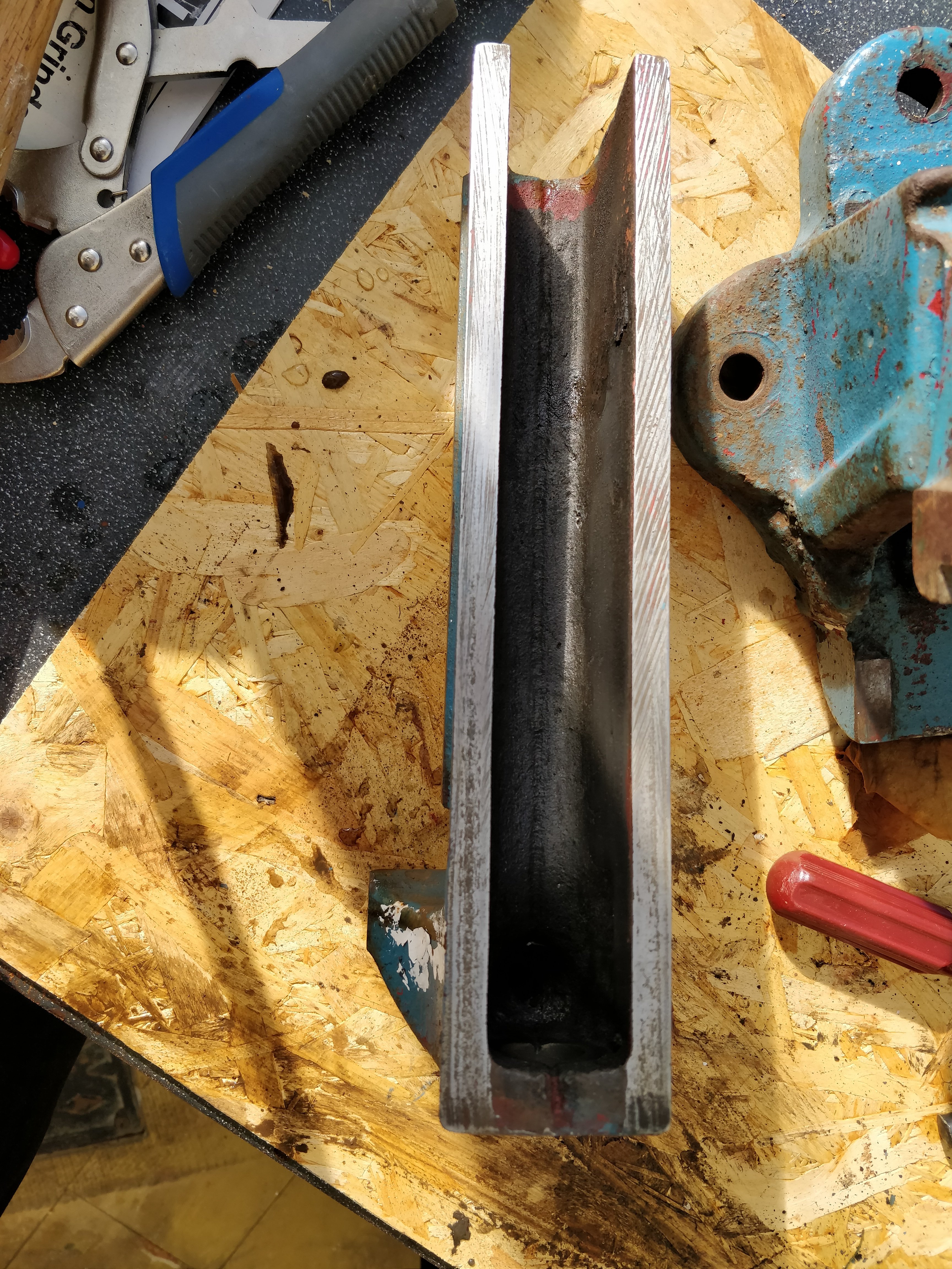

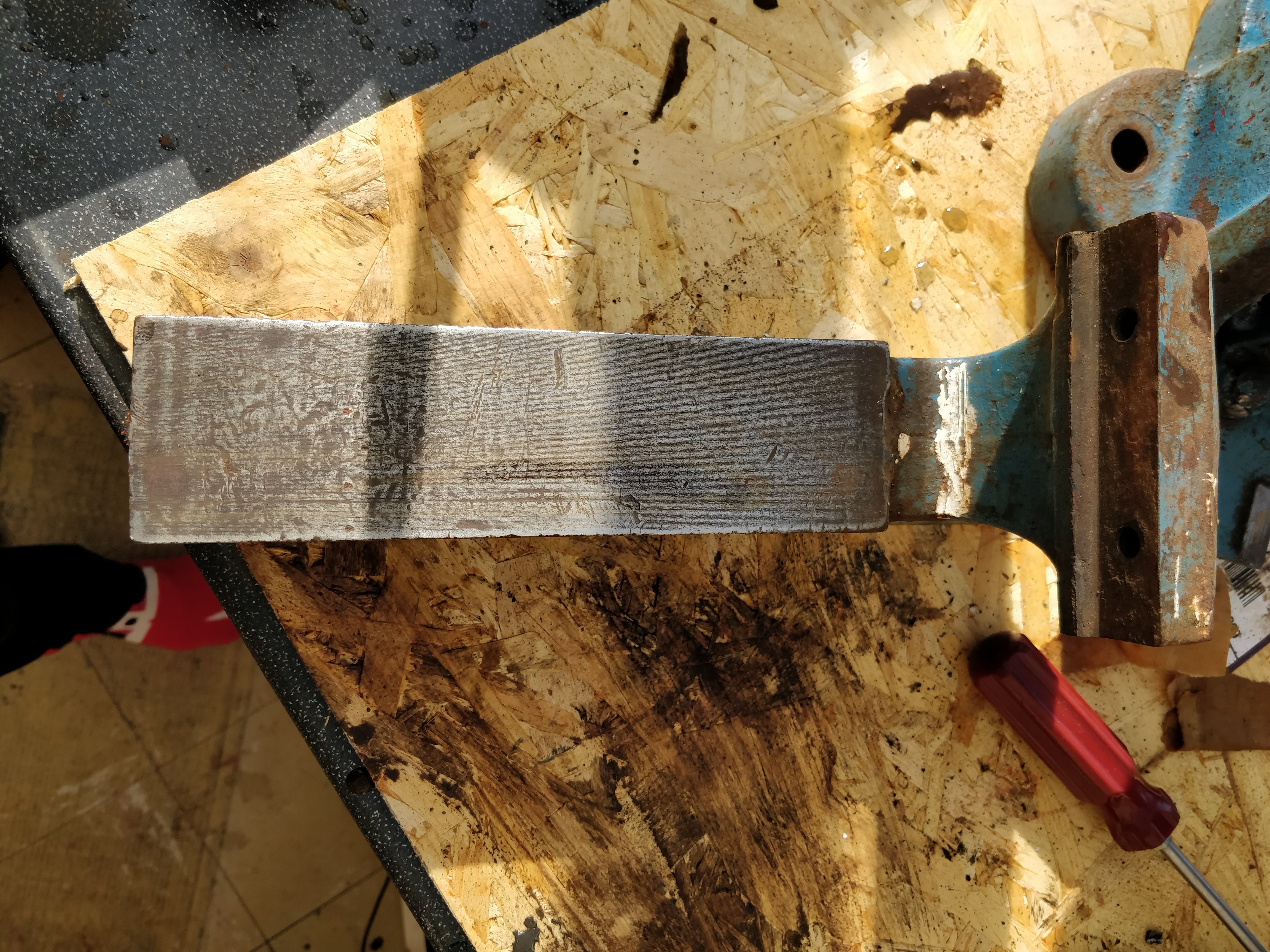

The machining marks on this vice are quite a bit rougher than my slightly more upmarket record no4...
The fixed jaw where the moving jaw slides through is of obviously lower quality, the machined surfaces aren't as good. Plus, it has an obvious weld going on. I suspect this is due to an inferior casting rather than actual damage from being done up too tight. I beleive it's fairly common on cheap vices for imperfections in the casting to be tidied up/filled in with welding.

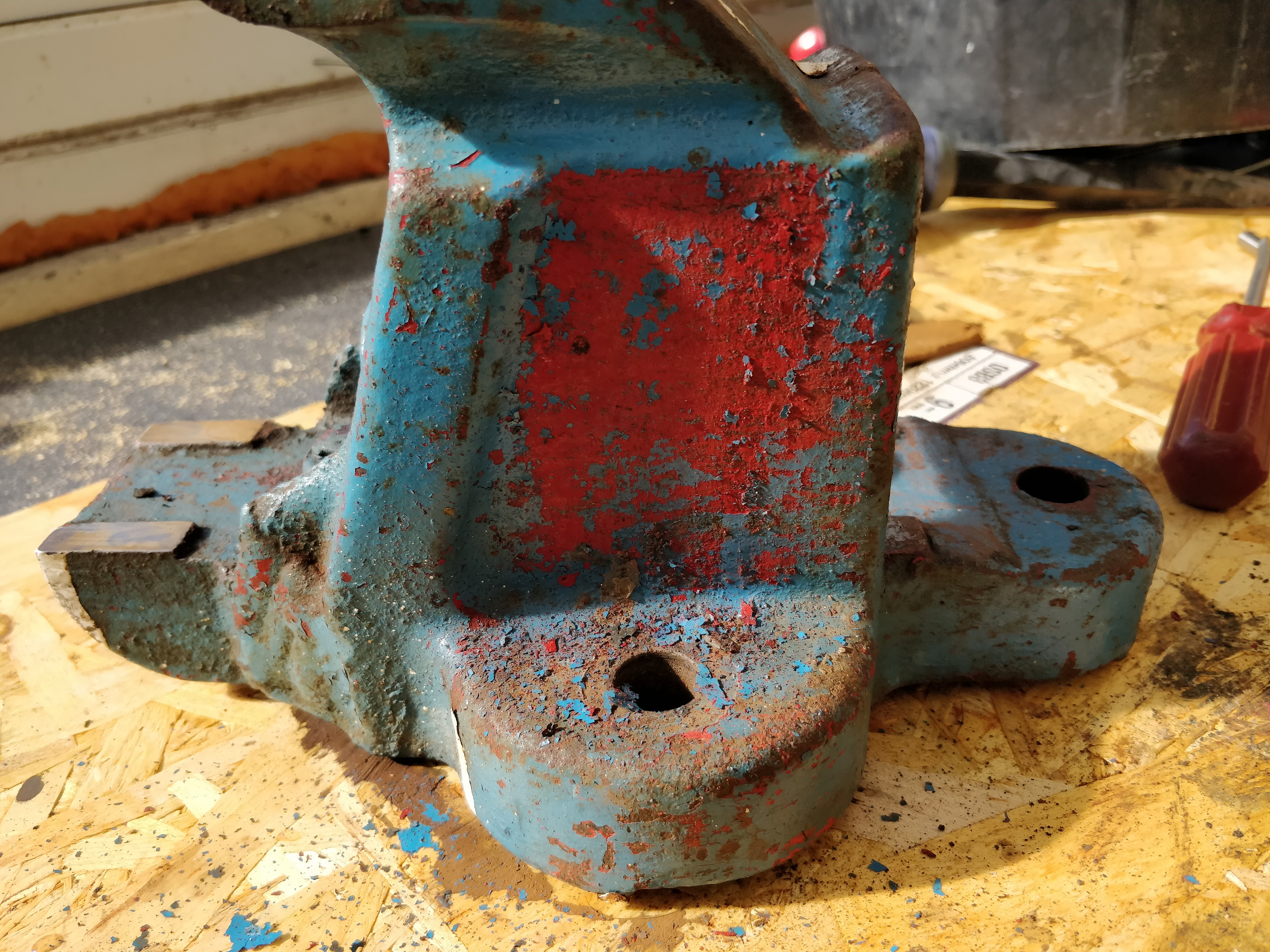

Turns out it used to be red! Explains why there's so much of the blue colour intact, it's been painted over at least once before. There's also traces of a darker blue, although that could just be how it looked where it was being rubbed off.
I guess the original owner wanted a record, but decided the cheap knockoff and a tin of roundel blue paint was better value for money. A man after my own heart! 😆

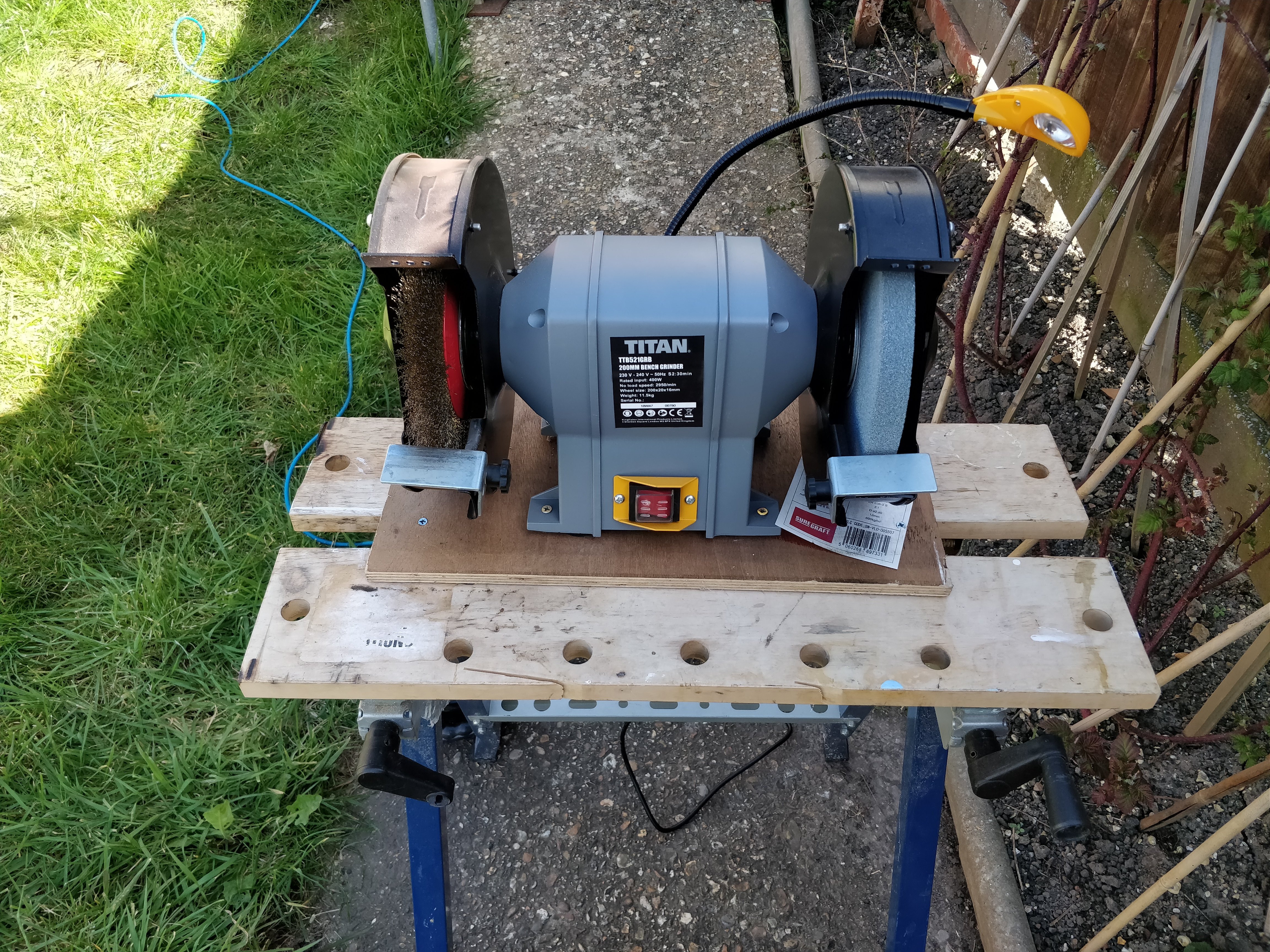

Now for the noisy, messy and tedious bit - cleaning off the old paint. Here is my setup:IMG_20200329_103939.thumb.jpg.ab5a9bd8238254d6bc8dcb579bc7e1c9.jpg
Cheapo screwfix grinder mounted to a bit of ply with a batten of wood underneath, means I can do the messy grinding jobs outside on a sturdy (ish) platform.

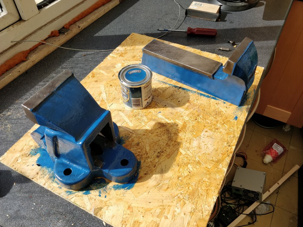

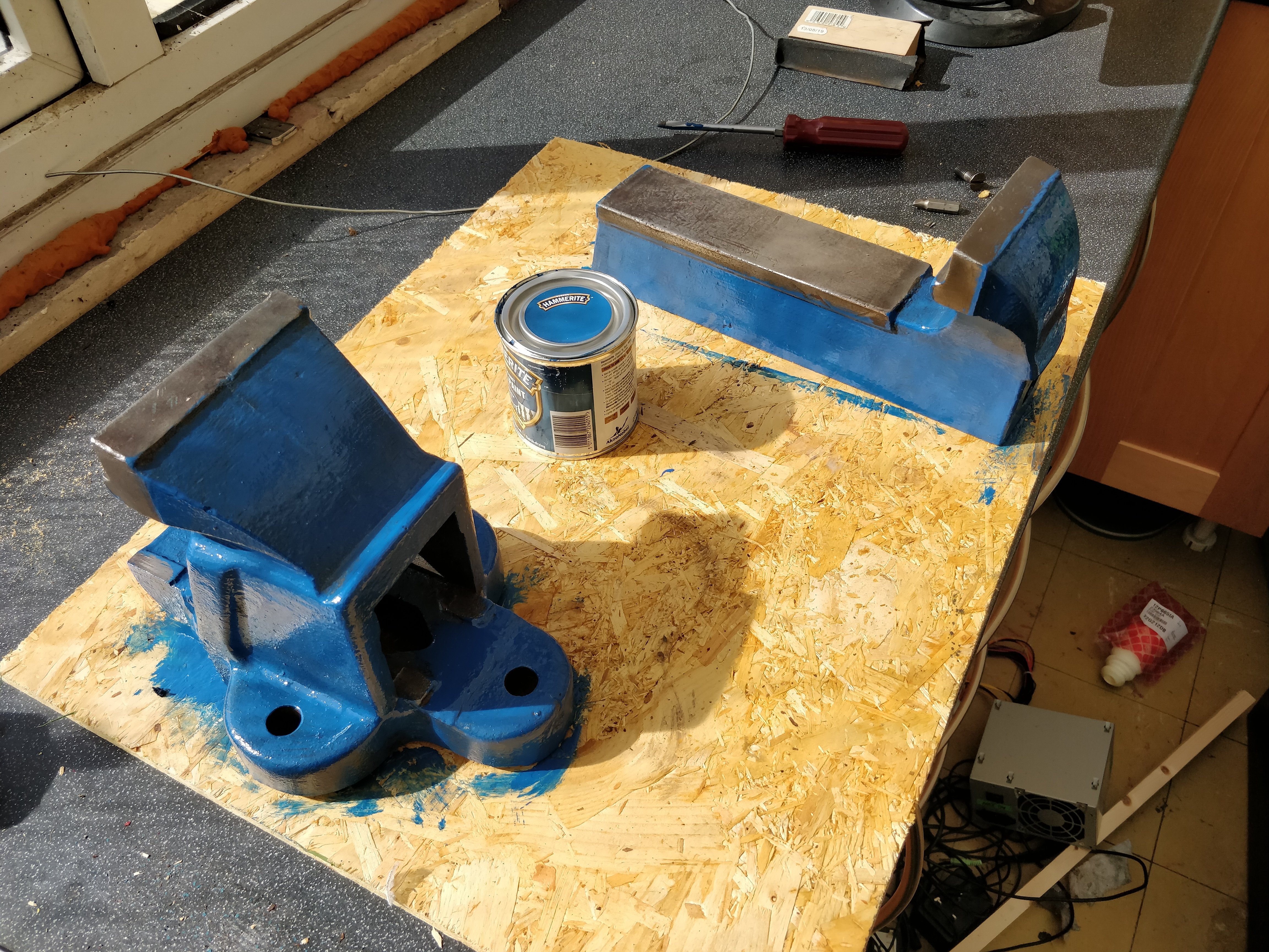

Much to my dismay, after all the hard graft of stripping off the paint, I found I don't actually have any suitable paintbrushes at home. I could have sworn I had plenty, but alas I must have used them more than I'd realised and chucked them out at the end of my last project.
I managed to find a crappy 2" brush, which is no good for getting into the tight spots, but it was OK for slapping on a quick coat and hopefully preventing it from rusting up.
I don't bother with masking it up, I'll sand any paint off the machined surfaces when I'm done and tidying it up.
I'll give it another quick going over tomorrow and touch up any spots I've missed, but I'll save any further painting for when I'm able to get a better brush.
The paint I'm using is hammerite smooth blue, which is less than half the price of the roundel blue I could find online. Thankfully this isn't a Record vice, so feel absolutely no obligation towards what colour I'm painting it.

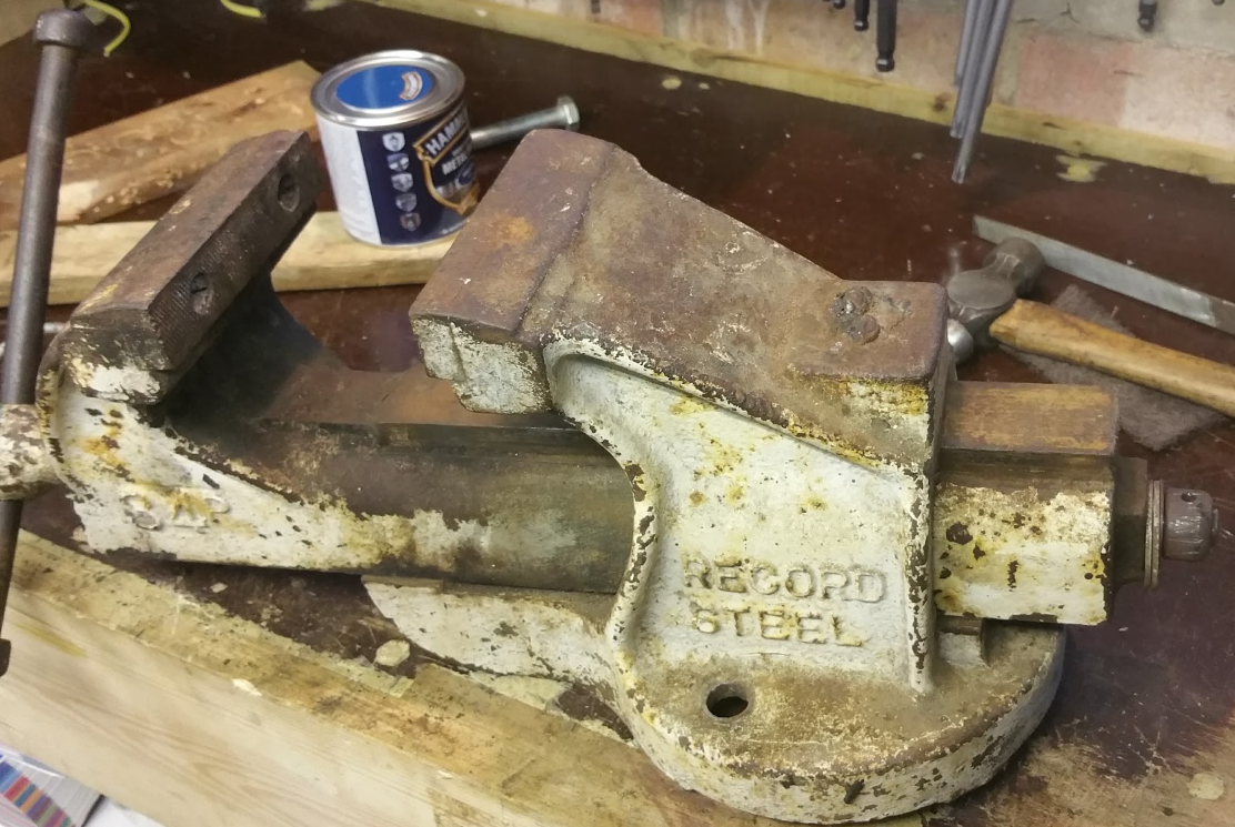

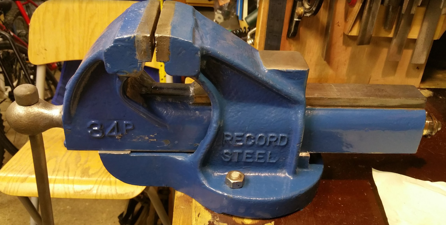

This is my Record 34p (plain, no QR) cast steel.
As bought from ebay:
And this after a bit of work - used the same paint as you!
Such a satisfying job, and cost about the same as an import vice of about the same size. This thing will outlast me, my son and probably his son!
A thing of beauty!
How heavy is it? I hear the steel ones tend to weigh less than their cast iron counterparts due to the additional strength, but can still take a good beating.
