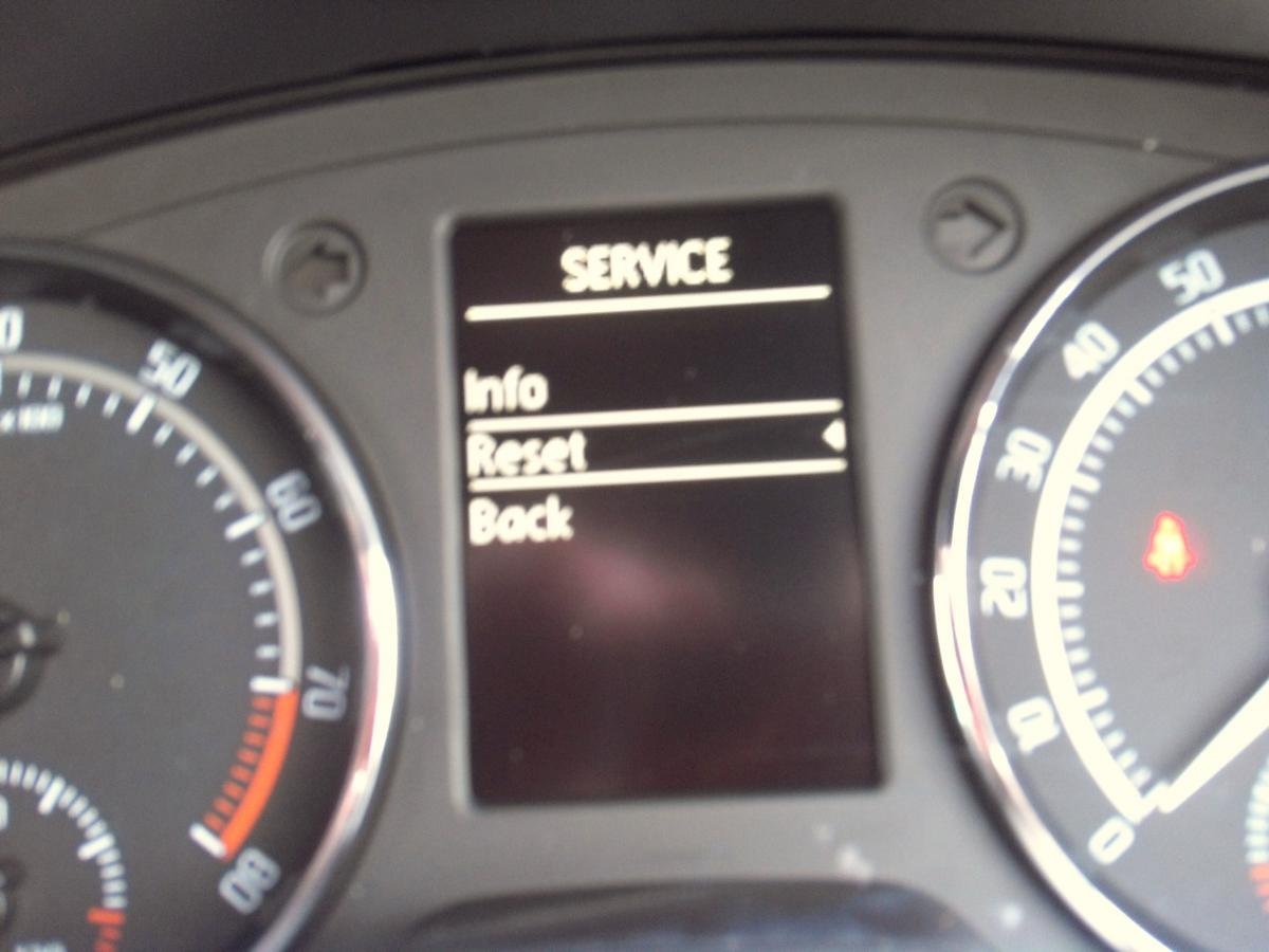

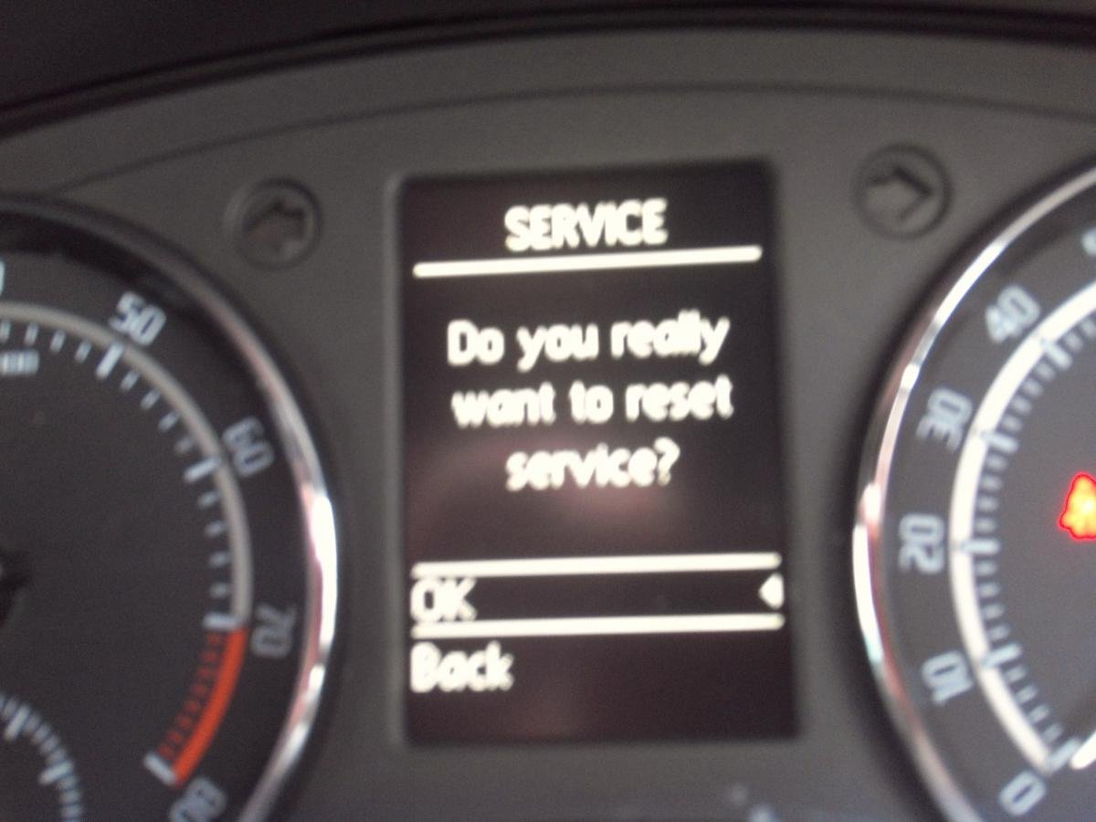

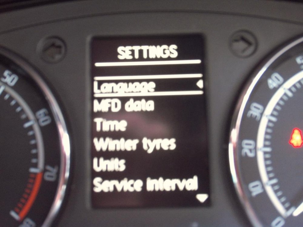

I would have to have a look at my wife's Fabia 3 to check, but on my Octavia you can reset the service display yourself AND in doing so, it also changes it from variable to fixed service. I expect all VAG models are similar.
@pikpilot
Maybe have a check.  You might find that if on fixed you can reset the service to 372 days / 9,400 miles but not from Fixed to Variable or Variable to fixed,
3 hours ago, Roottootemblowinootsoot said:
@pikpilot
On the Octavia and some other models if you reset the service indicator when on variable it forces a reset to fixed miles/time but you need VCDS to go back to variable service.

Just suggesting it may be worth trying the same on the Fabia 111.
It is worth trying.
