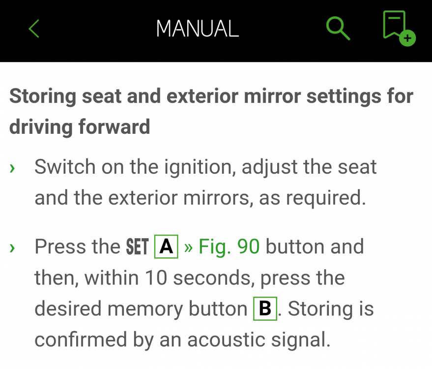

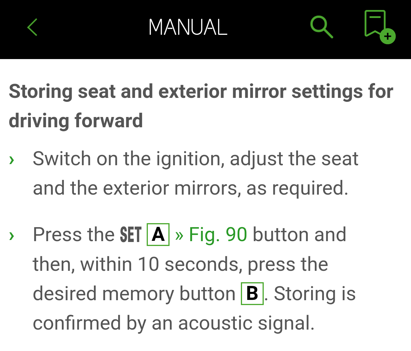

Im sure my manual says hold both together which does not work and i have attached a small video from DM Keith Skoda showing this method.
From the user manual......
Well this is partly where all the confusion is, i got my booklet out this morning and it definitely says "HOLD" not press this is very strange indeed, this is the original 2017 booklet that came with the car, i have attached a picture which confirms what i am saying, owners need to be aware of this as they could be wasting time and money following the booklet and video.
Ah yes, I can see why the confusion @carrswood.
Hopefully they've corrected this in the printed manuals.
The screenshot I showed is from the MySkoda user manual.
