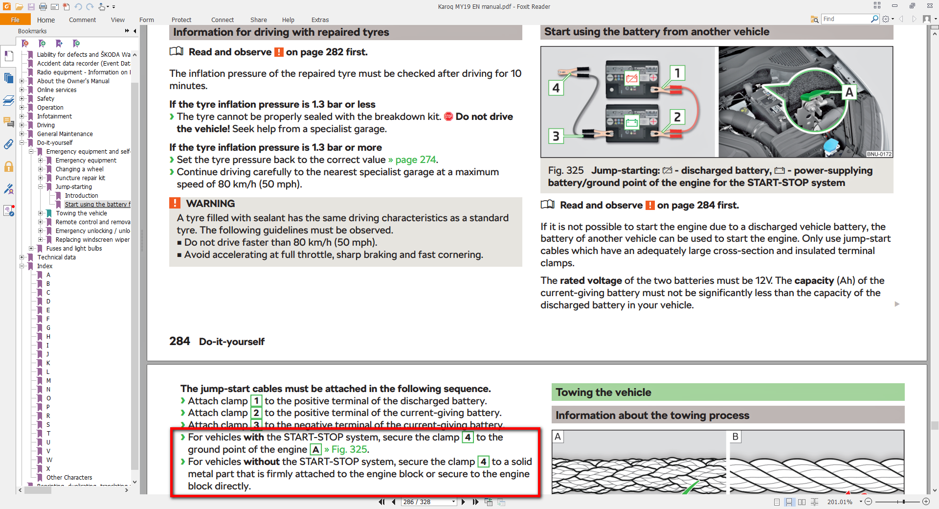

When charging the battery, mind where you connect the negative clamp!
Interesting, does anyone know the logic behind this?

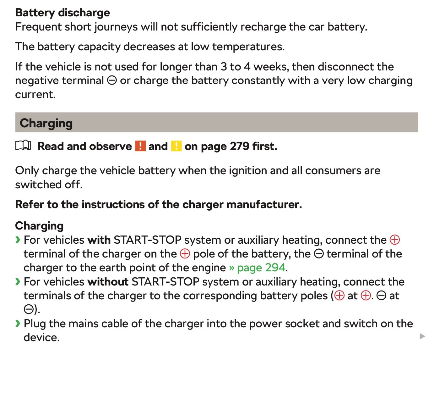

Also, this refers to jump starting, does it also apply to how to connect a battery charger?
tom
Edited by Sanqhar
tom
The BMS is connected to the negative terminal and you risk damaging it if you connect a charger or jump start using this terminal.
As to charging you connect +ve lead to +ve battery terminal and -ve lead to earth point on the bulkhead.

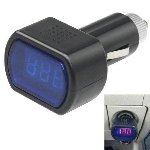

A Battery capacity to hold a charge reduces with age the older the battery the shorter time it can be left before needing a charge to full capacity - buy a plug in voltmeter for the cigar lighter/12 volt socket they are quite cheap and it will tell you when the voltage has dropped to a level that needs a charge.
Best suggestion yet thank you!
