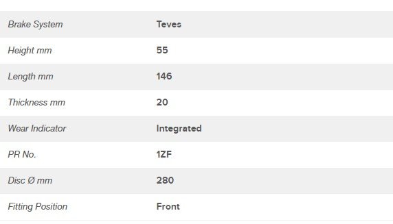

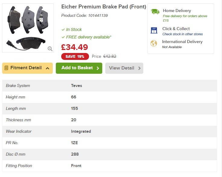

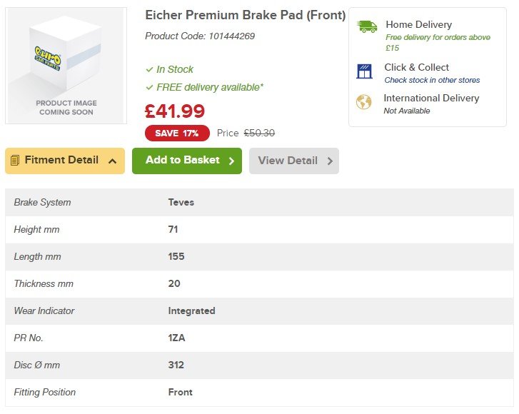

Need new brake pads for my skoda yeti. There are 3 sizes 146mm and 156mm and a different height (see images) for the different vehicle type 1ZF  1ZE  and 1ZA. How can I tell what vehicle type I have and what brake pads I need? I have tried the VIN website which is no use. Car parts online and euro car parts throw up the two types of brake. I guess I will have to measure the size of the brake disc? but is there a quicker way?

Thanks all for replying on my first post. What I did was take off the current brake pads and found that they were 155cm across and 66cm in height but according to the eurocarparts site these pads should be fitted to a 288mm disc and my disc is 312mm across. This car was serviced by Skoda last year when they replaced the pads in a full service. Did they put the wrong pads on?

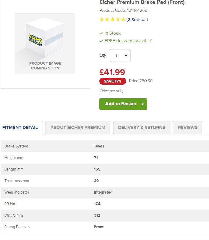

So I went for the brake pads that I assume belong to the 312mm disc. Those that are 155mm in length and instead 71mm in height. Unfortunately due to the coronavirus they can't be delivered for another 2 weeks. We need the car to travel to the shops as we live in the country so we are in a little bit of trouble.

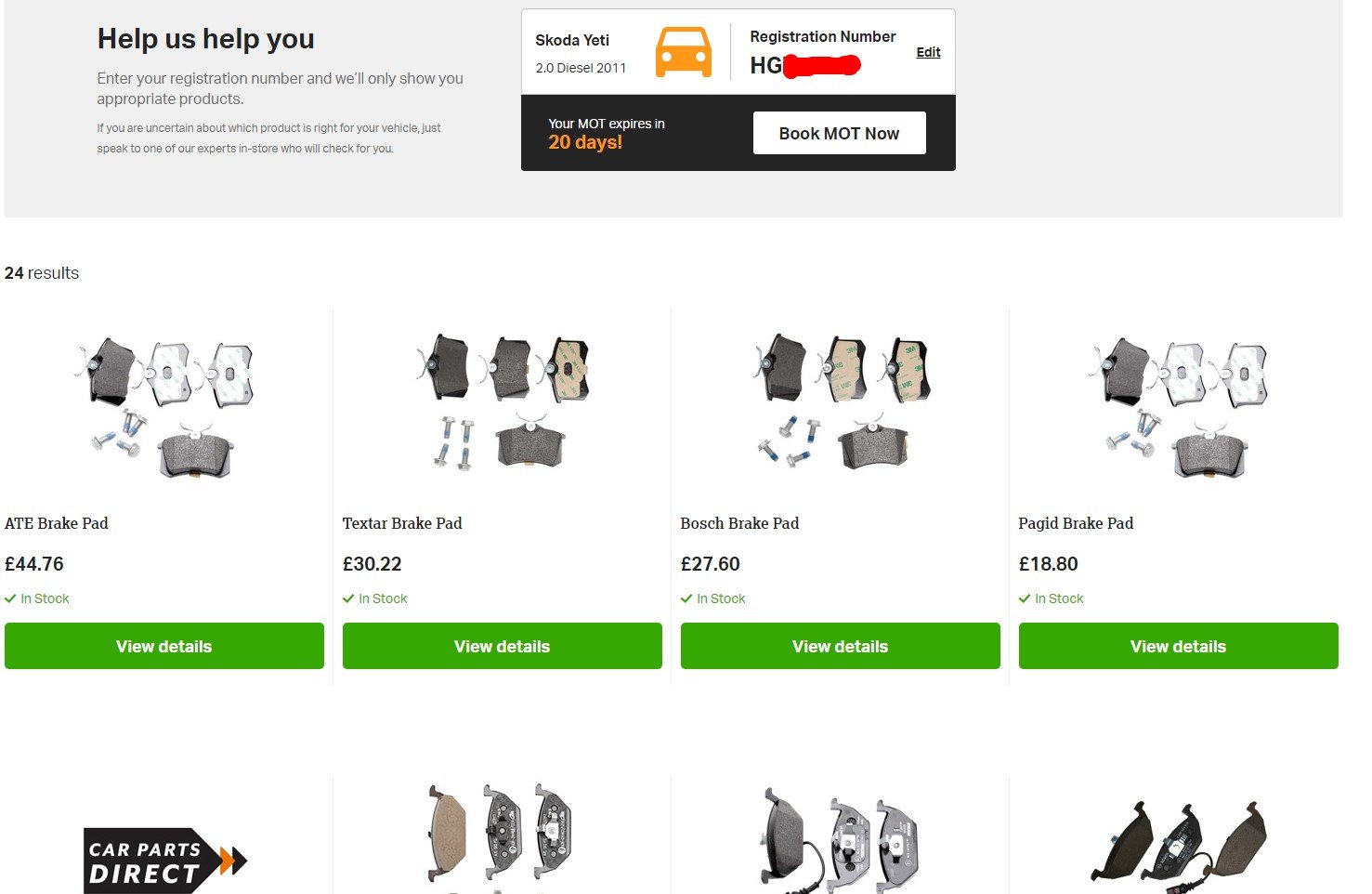

Which still leaves me in the dark as what to get. I looked in the boot as suggested. No stickers. I can't find my PR code anywhere. VIN no on skoda website is useless and no others are working. I even had a look at Halfords website which is even worse than the others. see pic
What I have to go on is 2 things. My brake disc size 312mm on more than one websites suggest I should go for the bigger 155mm length and 71mm height pad. and the Caliper VL581 which is the same as the RIDEX 78B0037 . OEM no OEN 1K0 615 123 E — SKODA

I have just taken a look at the Brembo catalogue, which has more detail than most.  The 312 mm diameter discs are associated with code PR1ZA and a Teves caliper.  The drawing of the matching P85 146 pads shows that they are 155 mm wide, but two of them are 71 mm high (with a "bump" shape at the top) and the other two are 66 mm high, one of which is fitted with an electric wear indicator sensor.  So maybe the pads are slightly different between inner and outer, though I would expect the actual friction parts to be the same size.  If you want to look for yourself check out the online catalogue on the Brembo website.

The pads the dealer put in were for a disc size of 280mm when my disc size is 312mm. So I bought the discs for the 312mm size and they fit. They work. Conclusion. Always double check.

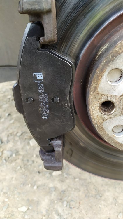

Have you fitted new pads to the existing discs? There is nothing wrong with this, but those discs look a little strange? It might simply be the photo / reflection but the colour of the disc surface looks different across the surface, almost as though they've suffered from overheating in the past? Is that blueing I can see?
You mentioned the brake change was urgent, what was the issue with them?
It also looks as though your calipers have been painted in the past. From the factory they're silver.

Hi and thanks fr your interest. It's not the size of the discs as I have measured them using calipers and they are 312mm. The brake pads that were in them were meant for 280mm discs they were 155mm 67mm and I have purchased the 71mm pads meant for 312mm discs. They fit and they work
The pads had seized up and the wheel would not turn, perhaps because of the incorrect size.
Not sure about the colouring. They look ok to me
