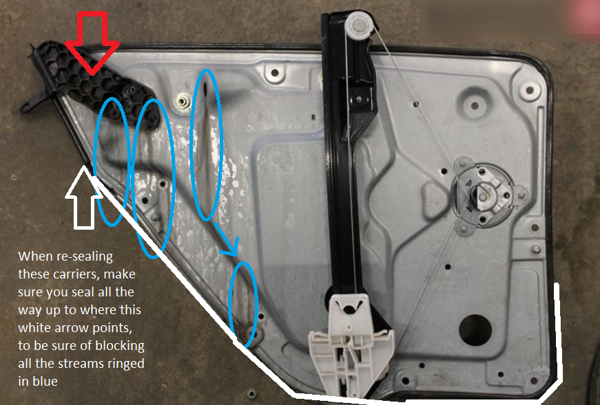

Did you seal up to where the white line shows in this pic?.....
2102605696-Mk1-Fabiareardoorcarrierseali
Hi TMB,  Thanks for the rely. I removed the panel around 6 Months ago and could see somebody had previously tried this repair with silicone. I cleaned off what I could and used a black gutter repair rubber sealant going right up where you’re diagram shows. I’m still getting plenty of water in the passenger rear footwell😩. I might try to remove it all and then try to reseal it but it’s stuck like s@&t to a blanket.
