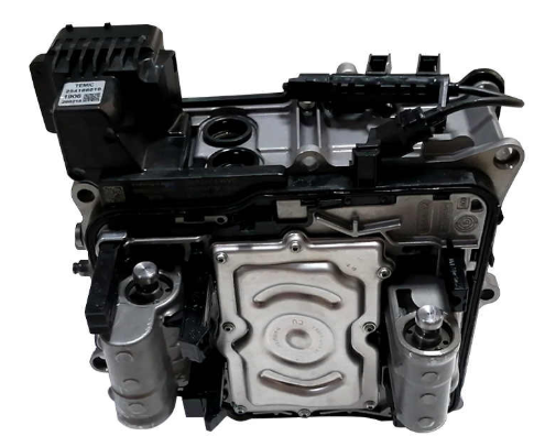

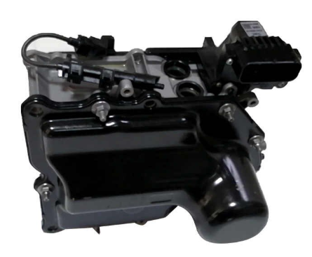

The solution to your problem will depend on the fault codes, but unfortunately the flashing gears on the central display is rarely an easy or cheap fix, and more often than not suggests a faulty mechatronics unit...

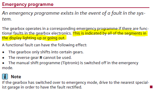

The manual is a little vague, but if your gearbox isn't already in 'emergency programme mode', then it probably soon will be...
