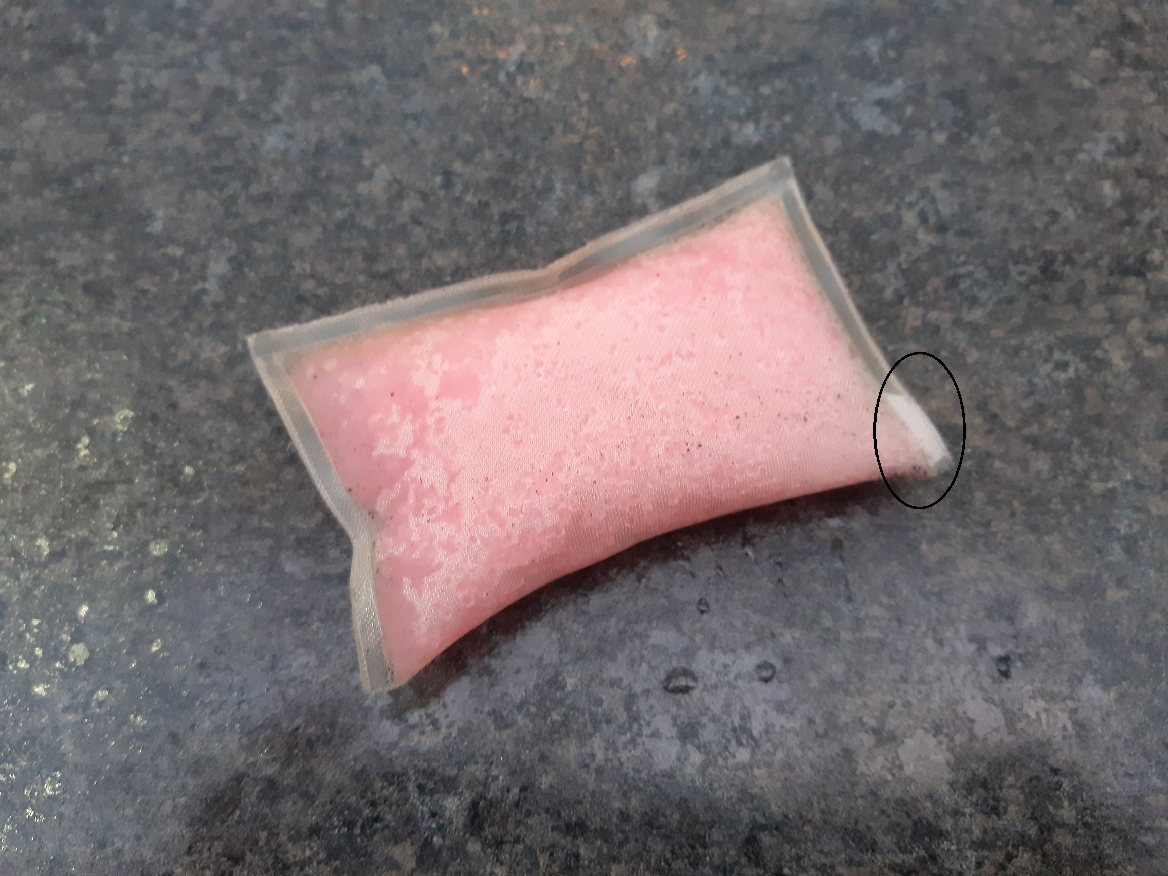

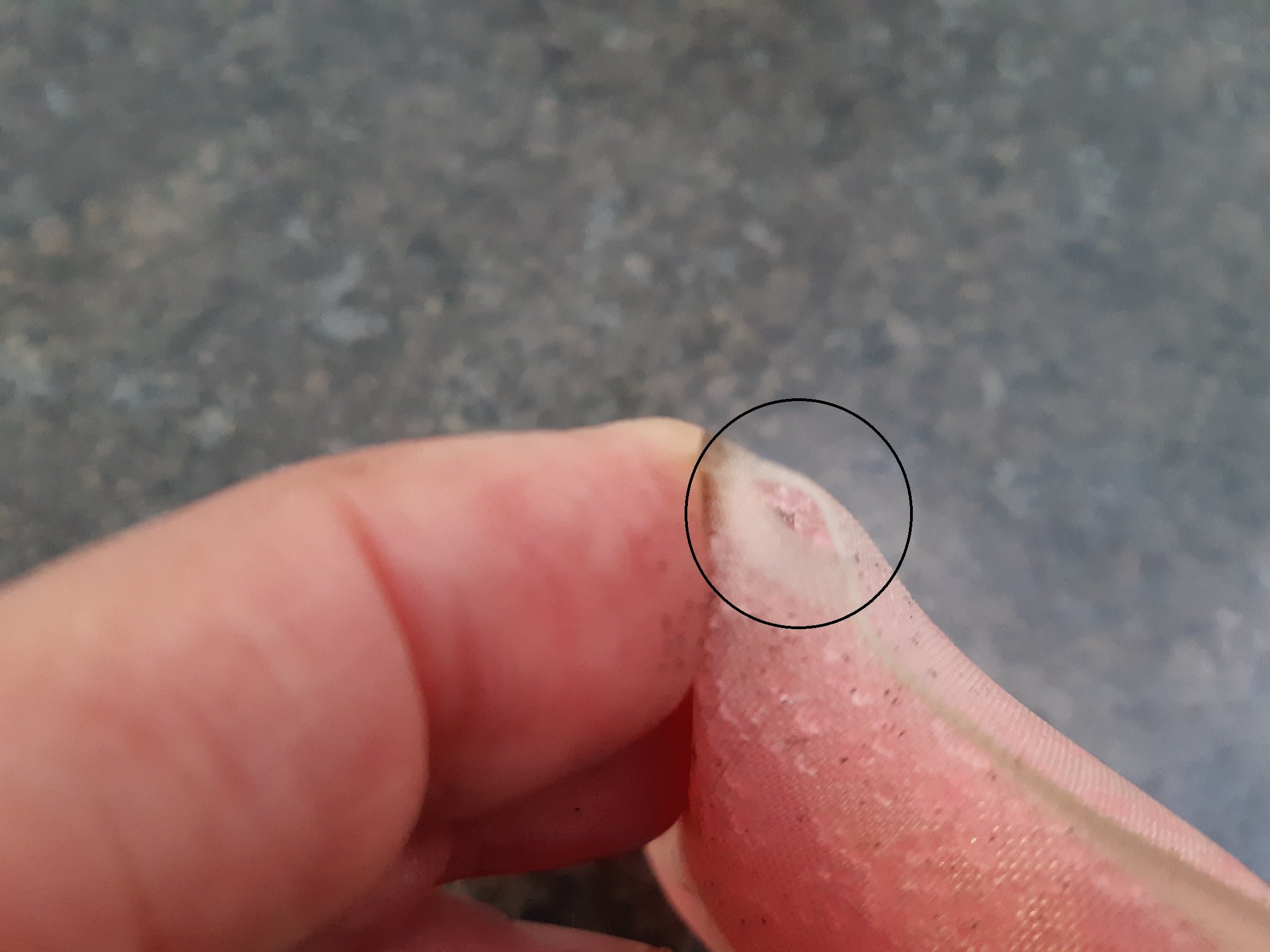

Well that was the best 15 minutes I spent on my car!! Clamped hoses, drained expansion tank, removed from car. Fished out silica bag with fingers, re-fitted expansion tank, put coolant back in it and topped off for the extra space caused by the lack of the silica bag.
But look! My silica bag had a tiny split in a corner! How lucky am I that I caught that!! Best 15 mins in a while :)

I'd at least use my pictures and posts as more evidence that Skoda have an issue. I have done 37k miles in a 2015 1.6 Octavia DSG estate. FSH from Skoda. But thank you for the warning.
I can see what has happened. The bag is pressed shut along its edges. Presumably heat welded or glued. It was either not manufactured properly, or the weld is failing. And if it was to help, you can have my bag as ammo so they can diagnose any manufacturing issue.
