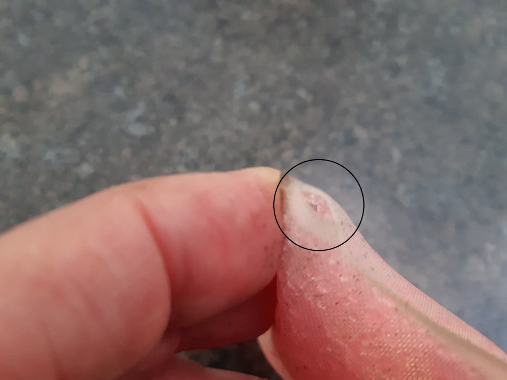

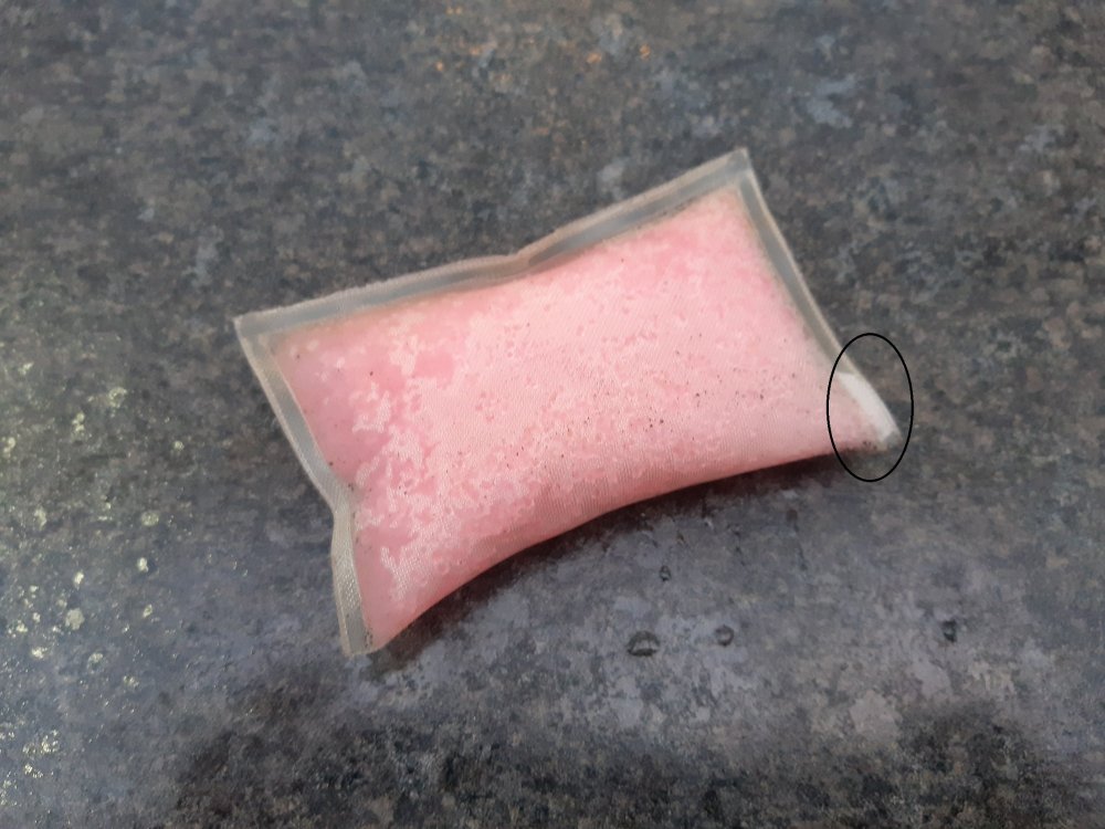

  • Well that was the best 15 minutes I spent on my car!! Clamped hoses, drained expansion tank, removed from car. Fished out silica bag with fingers, re-fitted expansion tank, put coolant back in it and

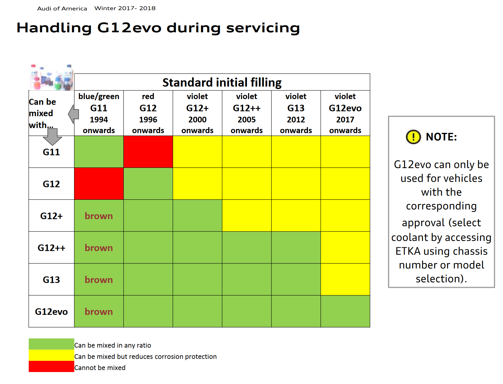

This chart helps explain the VAG coolant timeline, comparability and corrosion protection.
Here's the link to the full presentation:-
https://static.nhtsa.gov/odi/tsbs/2018/MC-10138342-9999.pdf
Edited by EnterName
Link to coolant presentation added
