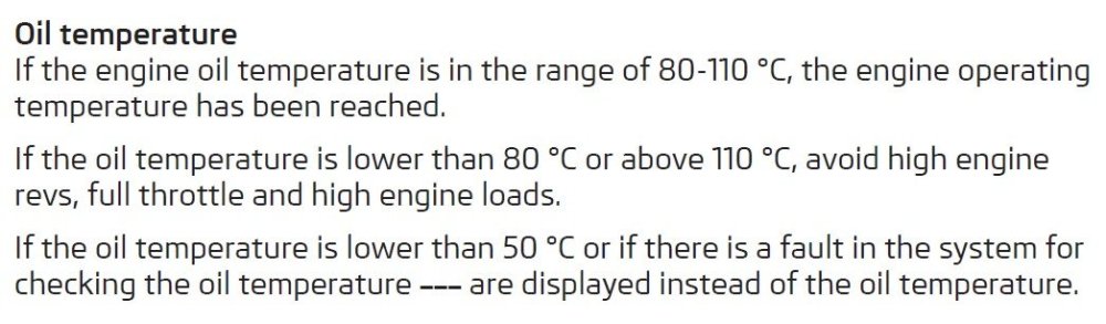

To me that would suggest that when and where it's safe to do so after the engine, and more importantly all of the car's other systems (brake, steering and suspension, all three include tyres, window/mirrors (lights)), have all warmed up then you can be less timid with your revs.  For the turbo to be given a workout it needs to be within probably the torque range as above and nearer the top of that range.
Before giving the turbo a workout you need the engine and its oil fully warmed which is best checked by setting up the multidot screen to show oil temperature, normal running range is not noted in your Owner's Manual but for my wife's 2015 1.2 TSI (90kw) its 80c-110c.  It shows two dashes (- -) up to 50c and numbers from there on.  This gauge might be useful to you to show actually how long the engine takes to warm up rather than looking at the coolant gauge rock steady on 90c.
To give the engine a workout you want to be between 3,000-5,000 rpm for a sustained period of time and/or mileage with certainly  bursts at the higher end of that range, forget any thoughts of economical driving.  Going up a long steep hill is a good time to get the revs up as you will be accelerating rather than lifting off the accelerator pedal.
The revs don't have to be about speed, no need to drive too fast and certainly not for any given conditions, I noted your typo of 80 instead of 60 (unless you meant kph).

Try it, get it warmed by oil temperature, keep the oil temperature setting on display and you can then see how long it takes to register and get to the normal band say 80-95 this time of year.  If I'm doing an oil change I like to see treble digits.

I check my oil temp every time I drive and it is always on 90c. So when it get to 90 put it in neutral and rev it up to between 3000-5000rpm
