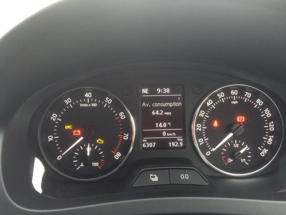

Thanks for your promp respone, really apprecated. The mechanic did struggle at first to unstick that rod from the 1st photo, he managed ot at the end. Then it was being moved by the OBD module you could see it and hear it clicking back-forth. Yes, i had a look as well, like you said its well at the back. It must be well stuck, strage how this is 1st time how it happened (1st time 3 wks into lockdown, but i didnt used the car that much befre that anyway), and now again today (as i said car only did few short journes per week 5miles max). Well disapinting to be honest car is only 3 yrs and 4months (16k on the clock), should this happen at all? I noted on your previous posts that you have seen one turbo with low milage worse than one with higher milage. It apperars that mine is gone bit more clogged up mort this time than the last hence difficulty acheaving higher revs like last time with your "spirited driving" advice :) . this is my 1st Skoda as well 😞

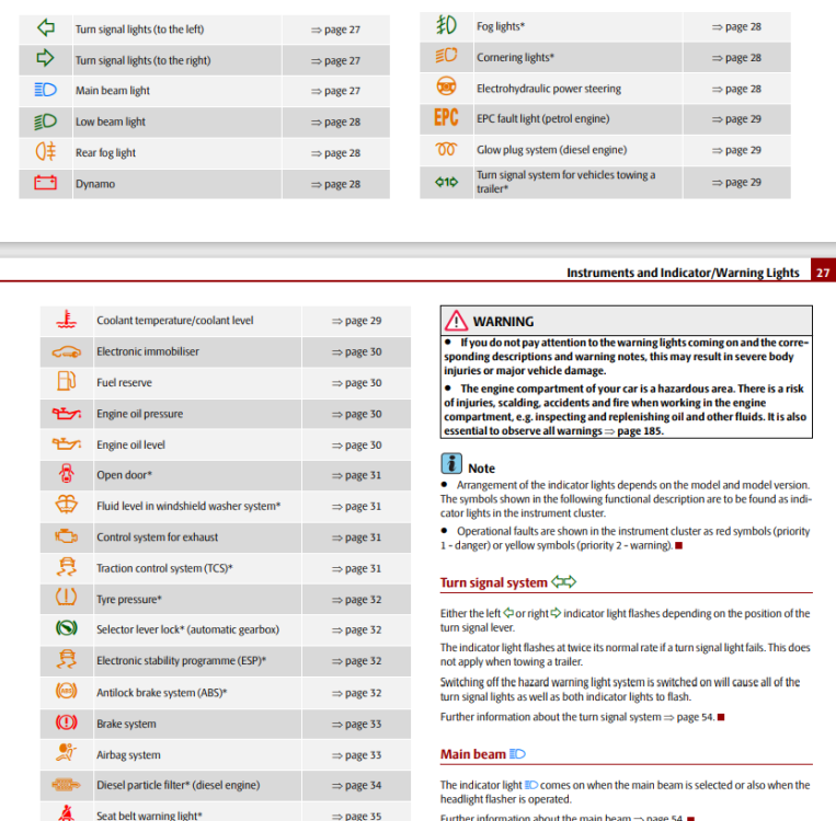

  • Electronic Power Control, I think. And MIL is Malfunction Indicator Lamp. EPC is spelled out in capital letters on cars with that warning light.   Here's a post with an extract fro

Also went for a spirited drive last night again after clearing the fault. Unfortunately the light still comes back after these trials. So we'll see how it develops.. still works normally but of course the light on your dashboard doesn't exactly give confidence.
Quite disappointed as well.. This is actually my first car I bought a year ago although have had licence for 15+ years (so needed to learn to drive again, also as I come from a right-hand side driving country). I knew mileage would be low as we cannot commute by car, and quite frankly I don't want to depend on a car. But it's quite crap that you just cannot have a car for occasional use as it breaks down for not getting enough mileage, as I now keep reading more and more regarding different possible issues. Need to change a battery to a 3yr old car was a bit disappointing, but changing a turbo would be way more than "a bit" disappointing. But let's see. If it continues could still try to find a specialist and give the information I have and ask if they want to check other alternatives than changing the whole thing. I'm an engineer but in electronics and unfortunately cannot do a thing with cars.

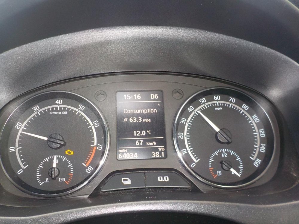

Since I am now doing a little more mileage again (about half  normal but less than 1/4 the actual travel time due to traffic). Finally got round to taking my car ( 2017 1.tsi colour edition) into my local skoda dealer after it also started exhibiting   similar problems when I was only doing 7 miles/fortnight round trip to the supermarket.  Slightly different error code P000AF. The car has only done 12k miles and had done less than 400 miles since last service/mot before fault appeared. If it weren't for the warning lights I would be unaware there was a problem as there's negligible apparent loss in performance or reduction in fuel economy even on the few longer runs I have done.
Their diagnosis - new turbo required cost £1842.50 given the feedback on here I queried the requirement for a new turbo but they are insistent they followed the standard diagnostics process and that is what the solution is. I am waiting for them to get a response back from skoda uk to see what goodwill they might offer given the low mileage and the fact that it is not that long out of standard warranty.
I'm not that hopeful they will come back to me with a satisfactory response - anyone have any recommendations of a suitable alternative garage in the Coventry area  to take it to for a second opinion / cheaper replacement if it really does need replacing?
Just had a call back from the dealer - Skoda UK are prepared to cover 65% of the cost.  Still rather a steep repair bill.
When I again mentioned the feedback on here and I wasn't convinced it needed a new new turbo they then claimed that because the actuator had seized in the turbo they couldn't just replace actuator.and it has to be replaced as a complete unit.
