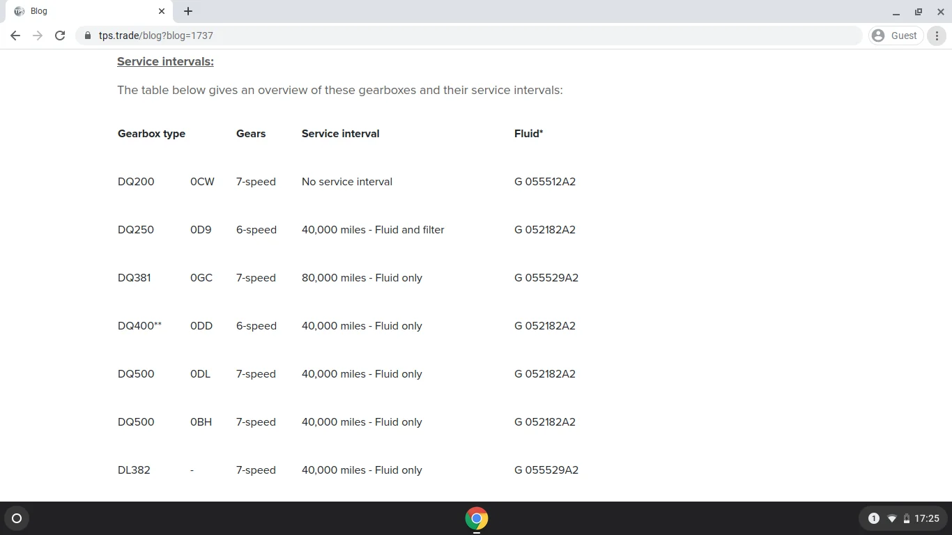

@Mikerp  How much did someone rip you off to service a DQ200 DSG with no Service Schedule / Guidelines for oil changes so no need to service?

This below does not apply to the DQ200 DSG @ 40,000 miles / 4 years as far as an Oil change.
Deal with the Dealer Principal only not the Service Manager or Workshop Manager and ask why they serviced your DSG.
1168293554_37335614_Screenshot2021-09-14at07_38_18(3).webp.ee5b8a609f78b3b2f42441d7532010fa.webp

It was the 40,000 mile service done under the plan, they didn't do the gearbox.
