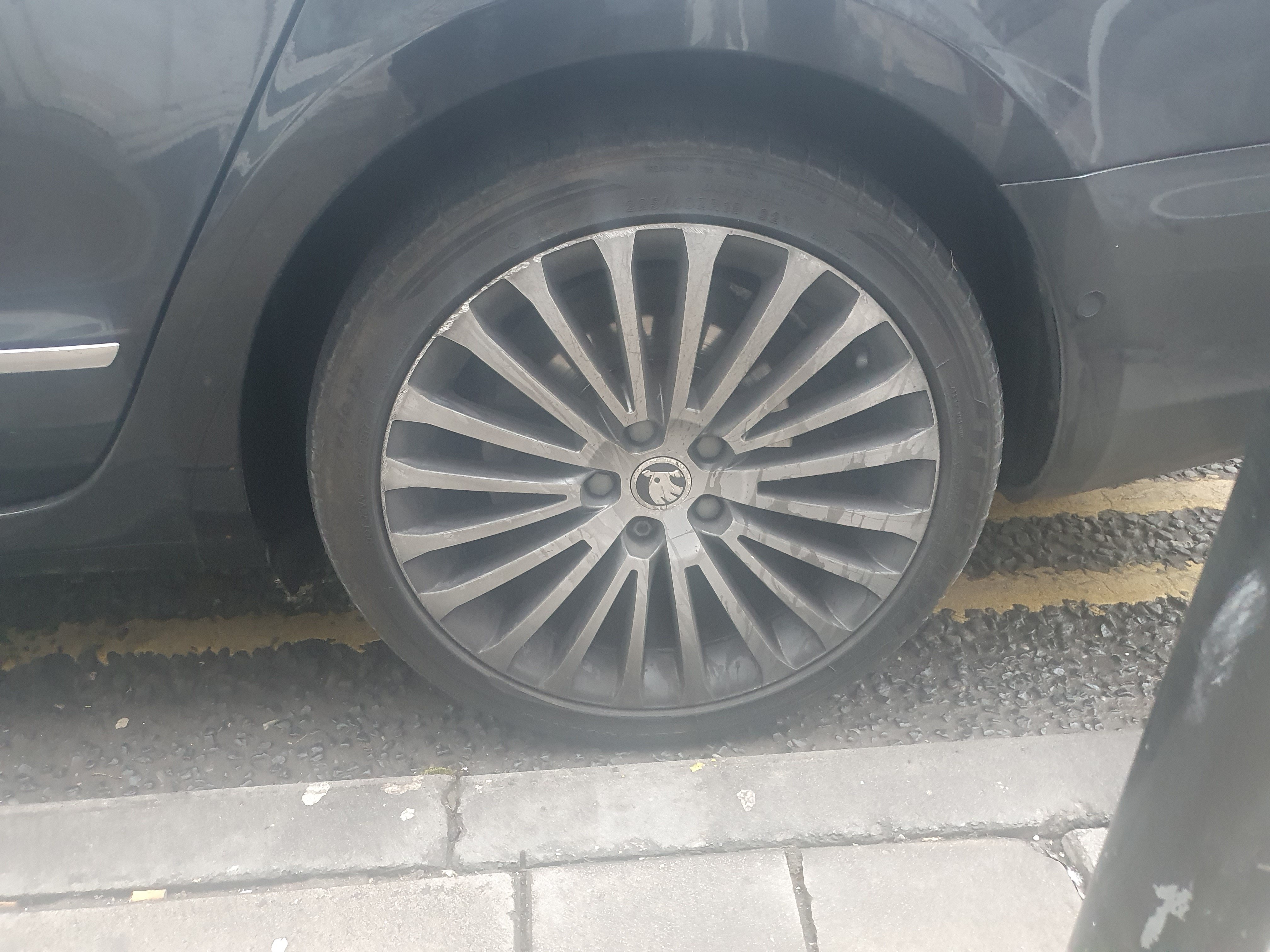

I am looking to get my alloys refurbished but unsure what the difference between powder coated and painted are and the benefit of either

Your original alloys are Diamond cut and painted
Expensive to get done but when they are done correctly looks like a brand new wheel as the face of the wheel is fully recut
I would go to an alloy specialist and get them to show you the difference
You wont get 2 colours by powder coating🤔

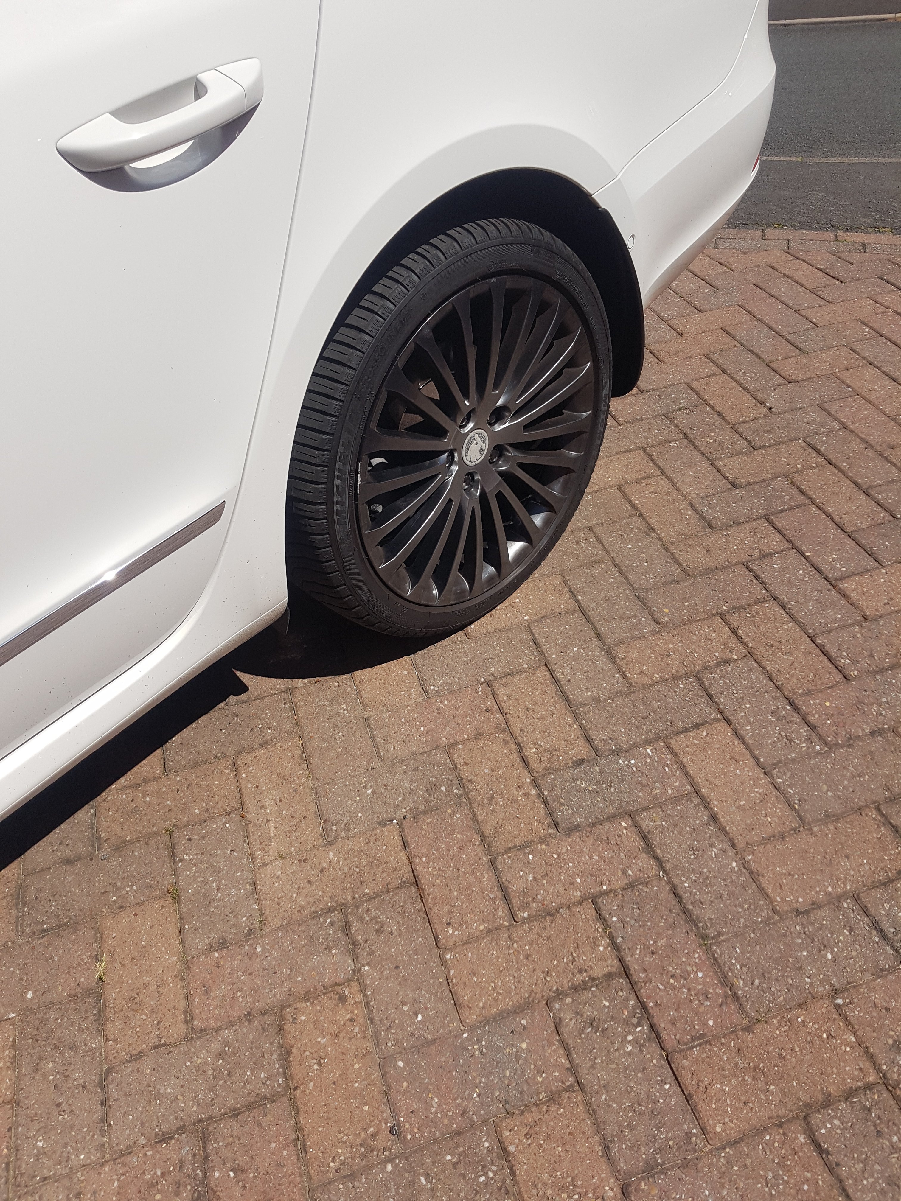

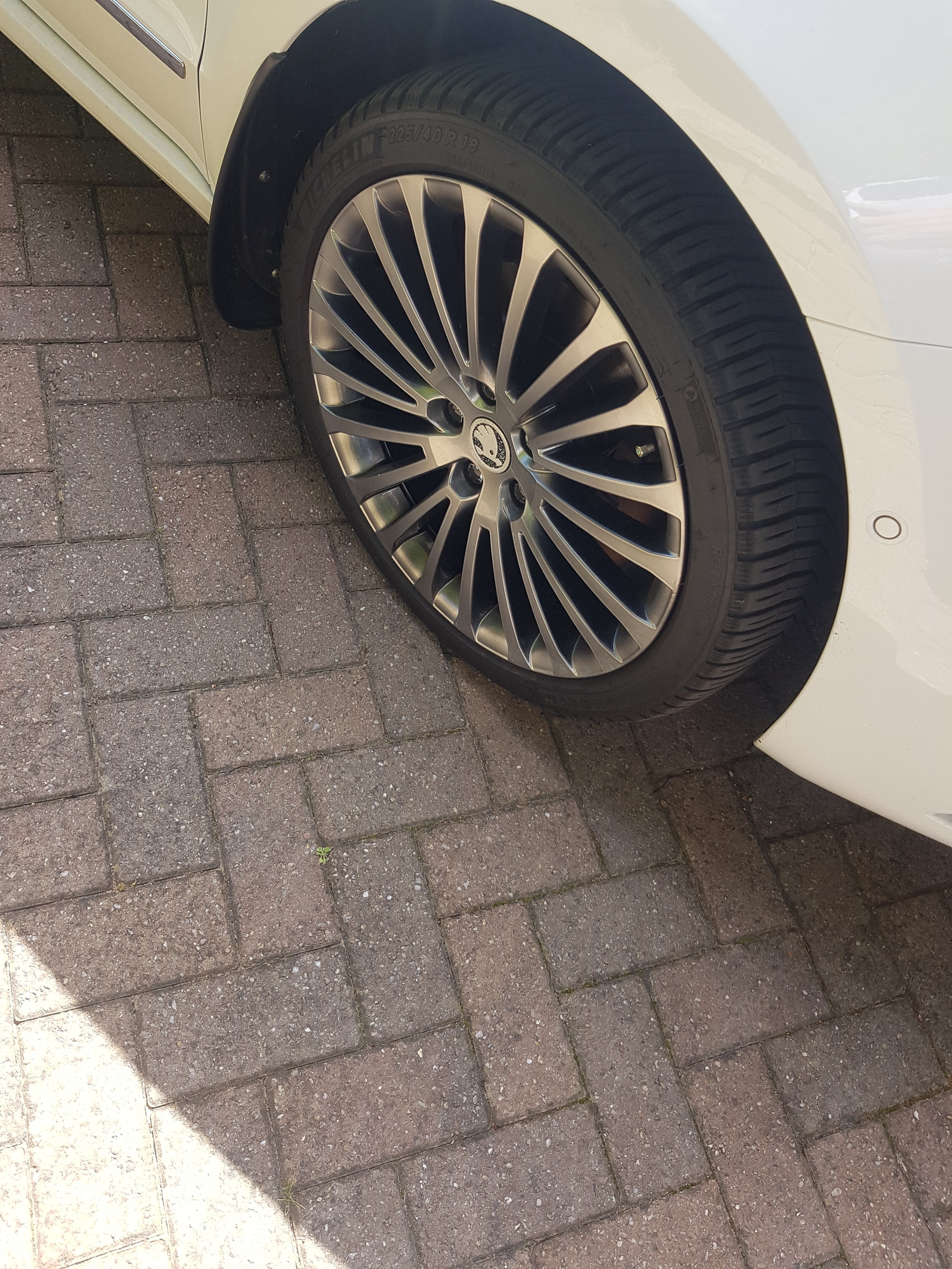

I have a set of 18" Sirius, and along with everyone else I have curbed them. When I originally bought the car and damaged the wheels I bought two replacements from Skoda Parts.
Since then I have had them powder coated with a light "Shadow Chrome" finish.  This looks very much like a chrome finish and the overall appearance is excellent, and very close to the original.
Any pictures?
In need of a bit of a clean, but gives an idea
Much better with the pictures
They look great, they just need finishing off now with the wheel bolt caps...
