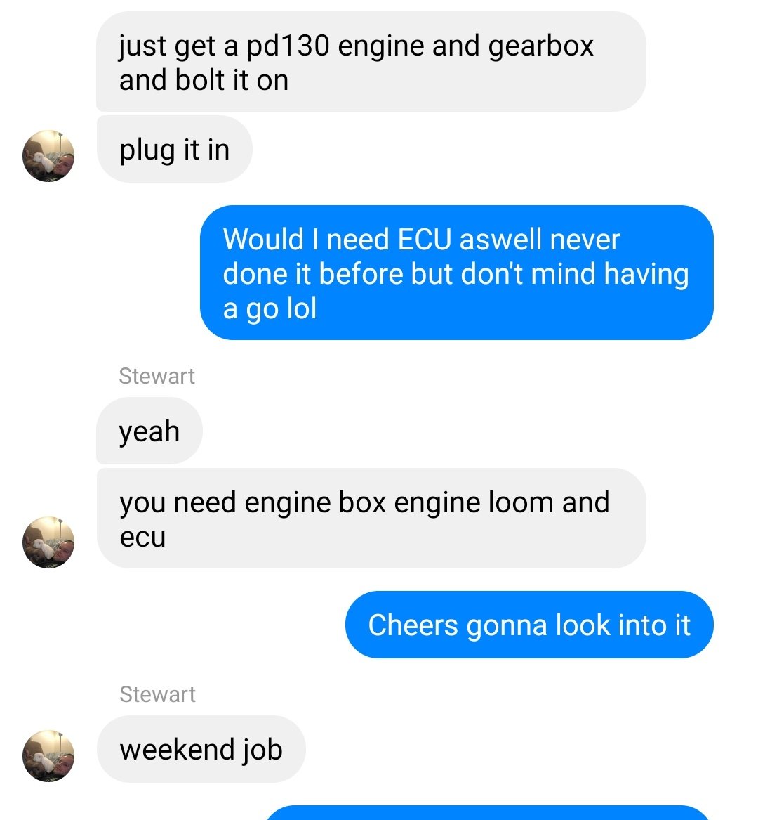

I was speaking to someone earlier who has done it and said this so obviously that's why I've asked on here
