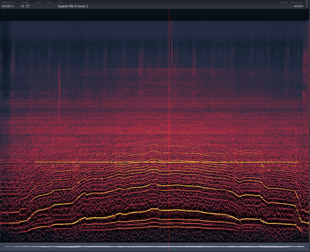

Something to note. It is a constant pitch, as engine RPM changes, so less likely to be anything connected to a belt (water pump, pulley, beatings etc).  Although failing bearings can come on like a switch at their resonant frequency. But this doesn't sound like that.
Although would have been nice to hear it at higher RPM.

I've made a recording in higher rpms. Here it is:
The noise cannot be heard outside, only inside.
Thoughts...
Cooling fan bearing ?
Electric turbo coolant pump bearing ?
Stepper motor noise (dithering) - Electric intake flapper valve?
Edited by digifish
Interesting, in your second video at 11 seconds when you increase revs quickly the sound momentarily stops...which may indicate bearing noise. Resonant. In which case could indeed be a Water Pump bearing.

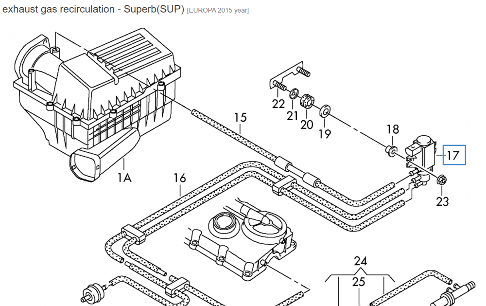

So I know what's causing it. A kind user on different forum found out that the noise is produced by Exhaust Pressure Converter (part number 1K0 906 627 B). It is fasten right to the other side of dashboard. I don't know yet if it caused by the converter itself, or by bad grommet. I've ordered new converter and will let you know.
Thanks for the update. So Item [17]? So this is a vacuum or pressure leak?
Could be a hole in a diaphragm or o'ring leak indeed.
Edited by digifish
I've replaced the pressure converter but the sound still remains. So it must be some part of it's holder that's transferring the sound into the cabin. I've also ordered new grommet, but I don't have it yet.

So today I've changed rubber grommets (part number 20 in the diagram a few posts above) and the noise disappeared :)
The part number is 046 131 887 if anyone would be interested.

Thanks for the update, so it was a vibration isolation failure? I assume the grommet is for NVH?
Edited by digifish
No it wasn't. It was old rubber rings that were passing vibrations further into the cabin trough body. They're part of the bracket that holds the valve.
Edited by pr0digi
@digifish Ignore my last post, I must have misread your post. You are right about vibration isolation failure.
