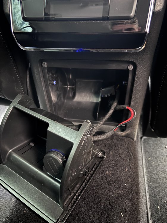

  • Some pics of the installation:

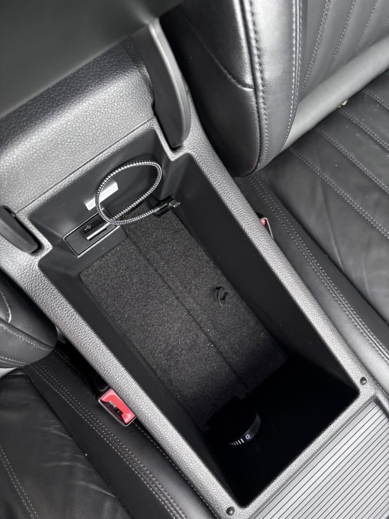

  • A while ago I researched into this - adding additional USB ports inside the under armrest storage as there is already a blanking plate there for the USB port holder. But I ended up passing as it
  • this shows the install in the Superb under the armrest, and the power connection at the rear power outlet.

For the rear charger you can still open and close the ashtray with it all in situ. If you take the ashtray out you can follow the existing cables and there are holes under the felt in the armrest for the cable to come out of. The shape of the cable also allows rear seat passengers to still use the usb A port on the charger too. And you can open and close the ashtray with it all in situ.

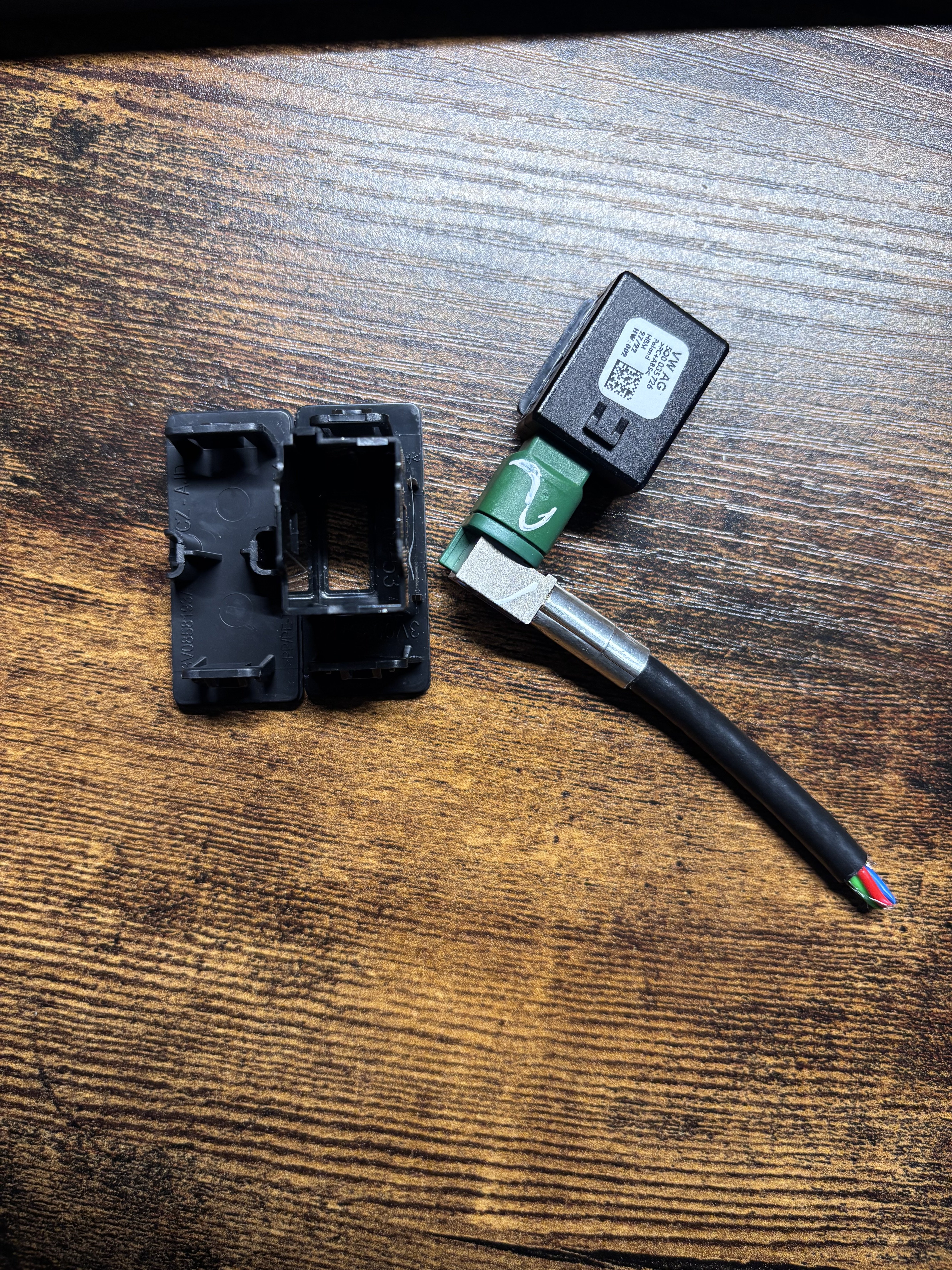

The single USB socket plate and USB has arrived today, its a Skoda unit so is a Skoda direct replacement for the blanking plate but only the a single USB port.
The unit came with a tail from the round 4 pin connector, but I have removed the USB unit from the mounting plate, will then mount in the Single usb with in line power adaptor and should be golden.
Will post pictures when the rest comes etc
Edited by tombee
Does anyone know if the Red and Black cables in the round cable above is all you need for just powering/charging USB.
It has Green and Blue as well but only wanting to charge, the Amazon usb in line adaptor USB QC arrived to do but the end's not the same and so doesn't connect
I’ll see if I can find the wiring diagram.

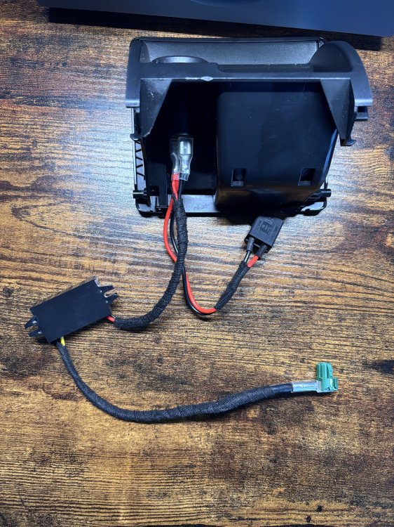

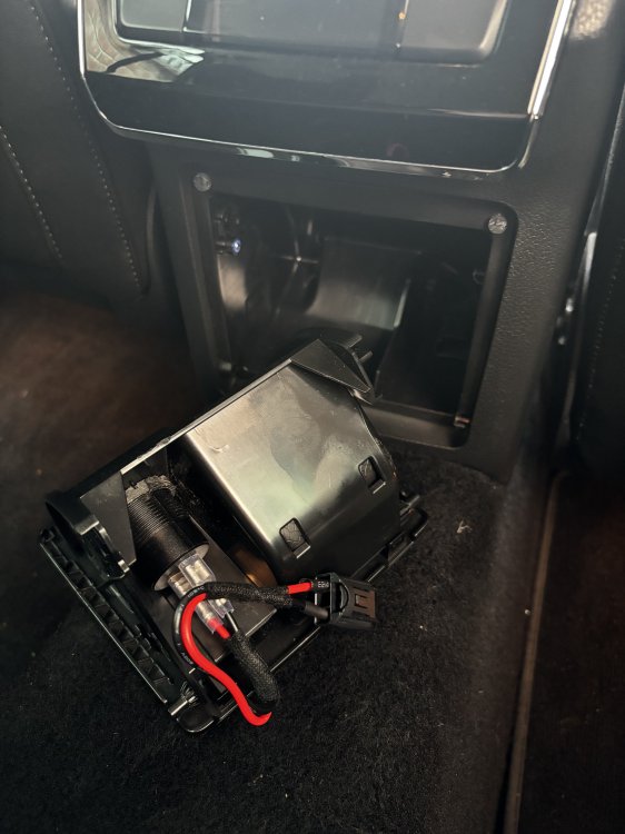

Been able to this today, thanks to @Binx1310 about the wiring etc.
Able to use the tail from the socket I picked up off ebay and use the step down to connect to this and then the other end to USB socket that I had installed last year.
Just had to route it in the car but wasn't too bad using a bit of cable to route from the back of the ash tray up to the inner of the arm rest.
What the unit looks like with it all connected, USB socket, step down and connection to the car.
That looks really neat.
