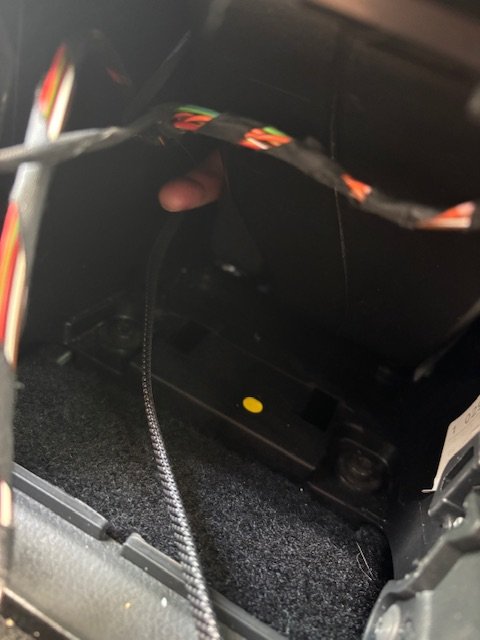

Only removed the ash tray and then used a brake cable outer off a bike to help route it, a little fiddly but got there.

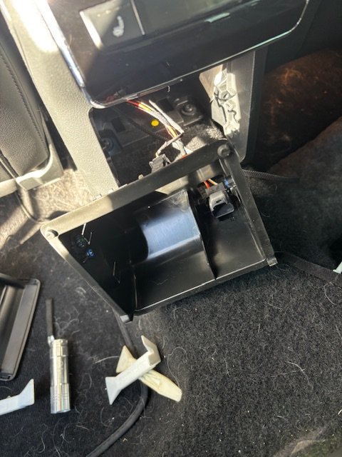

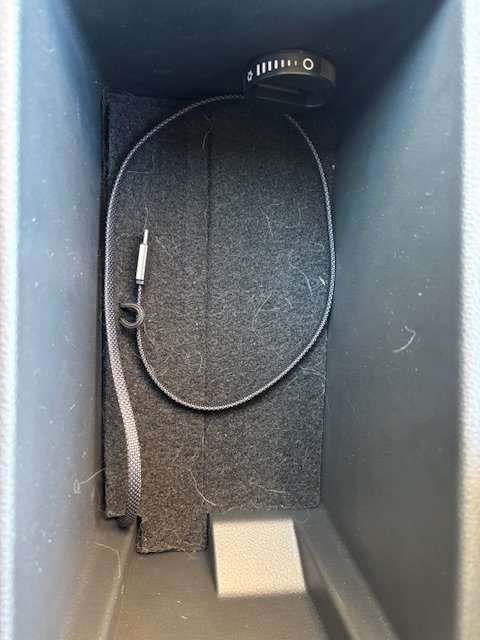

  • Some pics of the installation:
  • A while ago I researched into this - adding additional USB ports inside the under armrest storage as there is already a blanking plate there for the USB port holder. But I ended up passing as it
  • this shows the install in the Superb under the armrest, and the power connection at the rear power outlet.
Ohh that sounds promising, I have a habit of breaking things so removing as little as possible is best for me.
Did you buy the 2m usb c cable?
Also how do you remove the ashtray?
Think I’ll be following your way as looks best for me
I haven't bought a 2m USB C cable for this, just using the shorter one that I use at the front ash tray.
You open the ash tray as normal and then at the top push in (does take a little force) and it drops down and some out from the bottom, the right side pops upwards at the bottom with the left side retains so when putting back put the left side in first.

Yes does seem to, only for charging anyway
Fitted this today with what @tombee bought
I gave up trying to route the cable with just the ashtray out so I removed the inner “cage” then easy peasy, but that wasn’t exactly easy to remove the inner cage but bit of persuasion and jobs a goodun

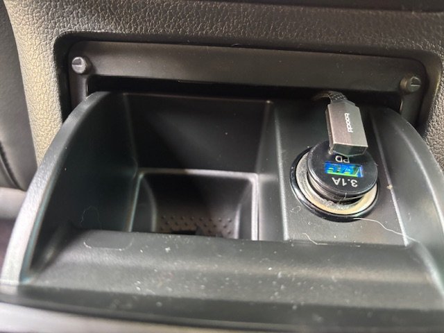

Keep an eye on this @Danoid I’ve worked out today that these usb adaptors (or possibly the cables) are the source of my DAB interference meaning the radio drops out when charging phone. I’ve used a different charger and wire with no issue.

I rarely do too, but it annoyed me that it wasnt working! New adaptors arriving today to try a different one.
Probably doesnt help that I have 2 of these installed!

I got these ones and DAB now working!
https://www.amazon.co.uk/dp/B0BS3TPC6B
Not quite as slimline as the others but they JUST fit under the front sliding cover and ashtray can close.

Yes. They are borderline too big but just about closes. Have to press on the top of the plug slightly to close the rear ashtray. I might end up changing them for surface mount sockets, but they work for now!
