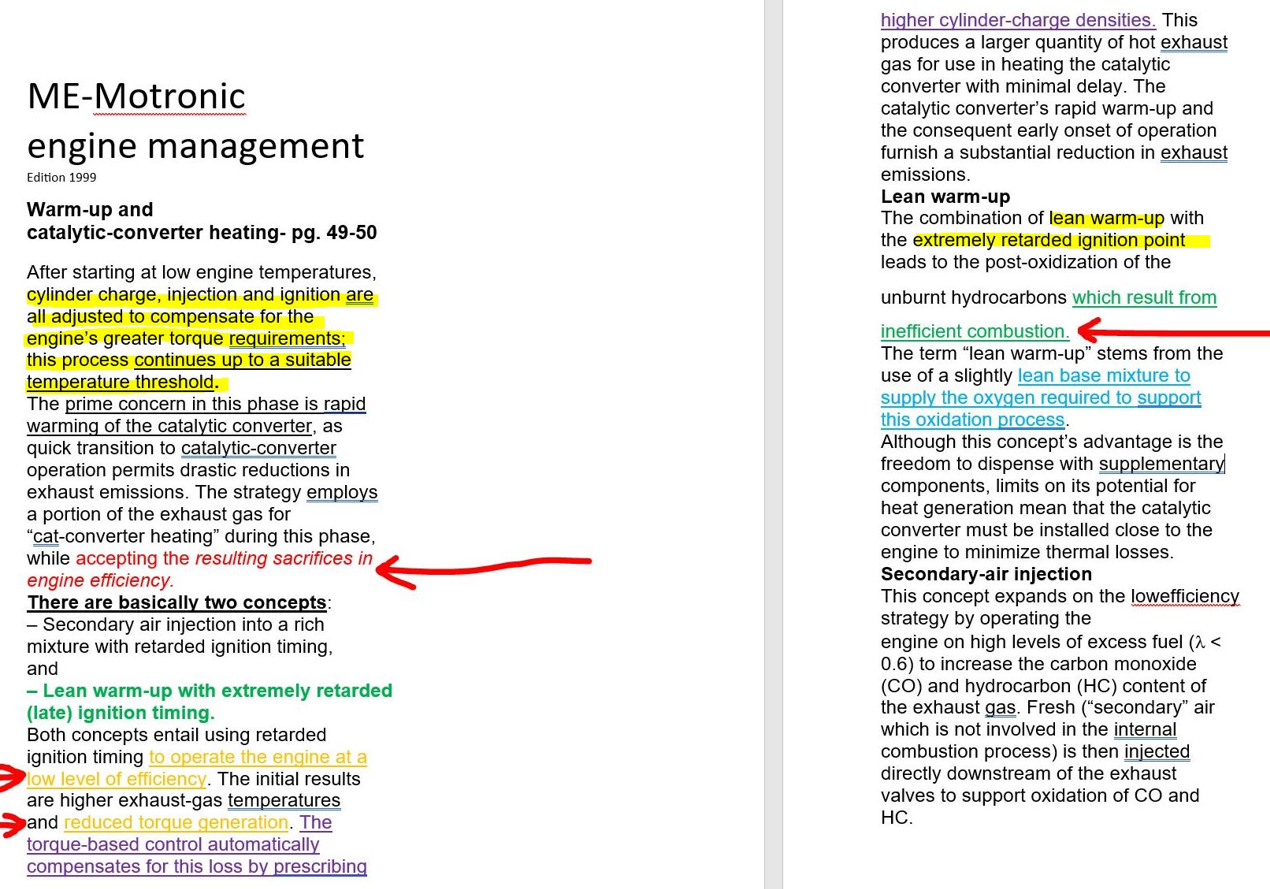

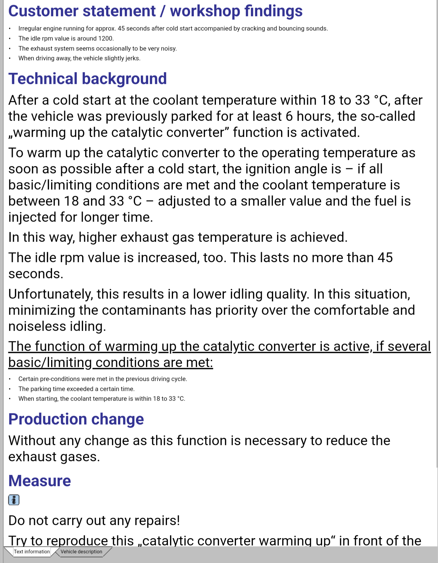

Update:
Hi, found that Kangaroo is related to the exhaust camshaft advance/retard when the engine is cold/when preheating the catalitic converter.
It is because the ea211evo does not have a physical EGR, everything was made with the inlet/exhaust valve overlap in order to decrease NOx.
So don't ask for the usual power remap (with the lambda and timing advance, like all do), ask instead for the exhaust camshaft tweak at low RPM and low driver demand (for less overlap with the inlet).
SSP-253 info there, you can also check by yourself with a tester.

On 29/02/2024 at 09:39, cri1410sti said:
Update:
attached 1 file with the exhaust retard, sorry for the language
Kangaroo-15tsi-dpca-ecu-v1910.pdf
