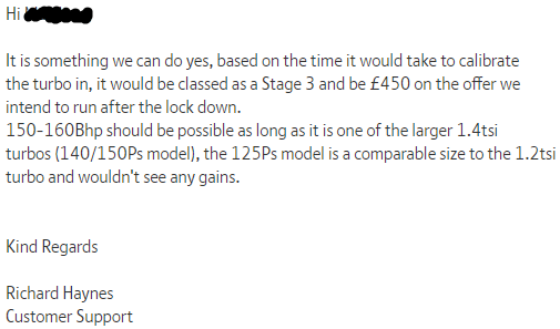

This was my response from JBS Auto Designs:
I later asked about hybriding the 1.4, he mentioned it would probably achieve similar power to their stage-2 hybrid from the old 1.2, about 200bhp, but lag becomes noticable as at that point, the exhaust turbine needs to be enlarged to reduce backpressure.
Though he cannot give any solid figures as it's all theoretical, they haven't actually built anything  for the new versions (yet).
The actuator is a non-issue, someone else on here already has the 1.4 turbo installed, and it worked without issue (hadn't mapped it at that point).
That little bird is correct! I do indeed have a 1.4 turbo, it's waiting to go in next monday once i have time.

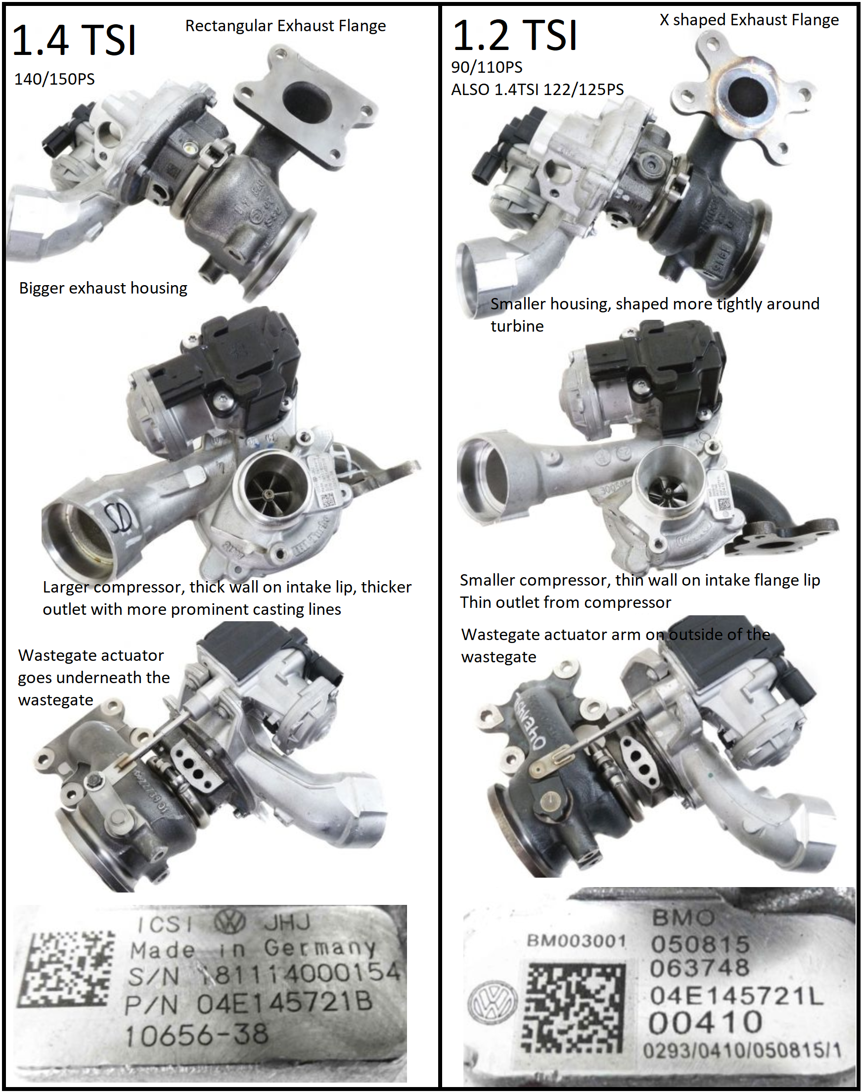

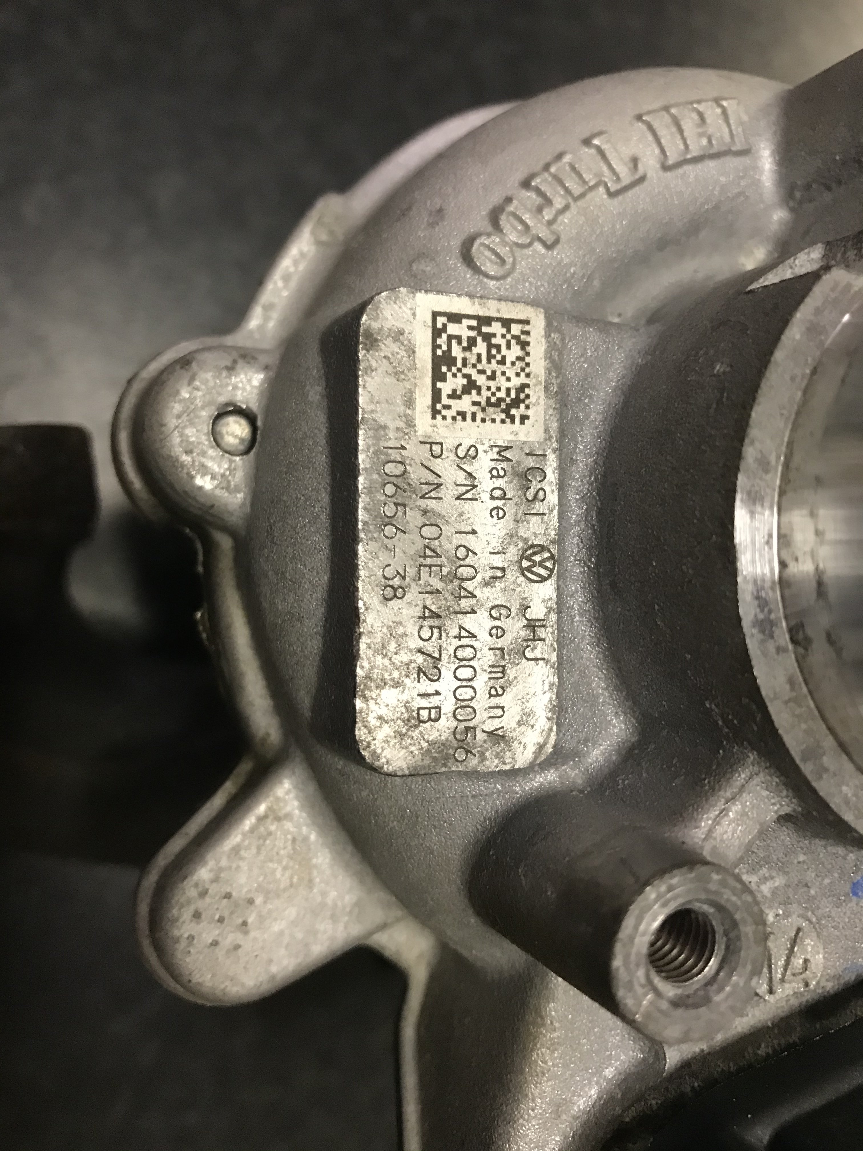

Check its part number, if it's 04E 145 721 B, you're in luck, if it's something else, gi'z a shout and post the part number on here, either myself or someone out will tell you (i'm off to bed now :D ).
Just made this as a quick comparison between the two pointing out a few differences between the large and small turbos

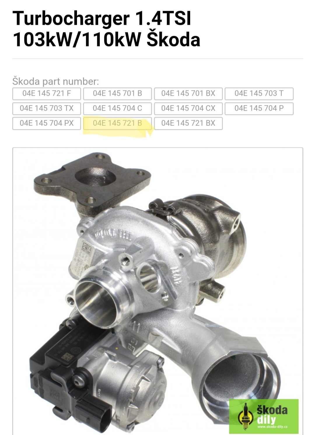

its a 04E 145 721 T , it also has x shaped exhaust flange. will it go?
I can't find much information on that one oddly, though given that Octavias have only 140/150ps flavours of the 1.4TSI, so it should.
Couldn't find any images of that particular part, but compatible alternative part numbers bring up other turbos of the correct, larger type.
Best off giving jbs a bell and seeing what they say.
You can just go simple hybrid 1.4 turbo without doing any other mods and get around the 200bhp mark. For 270 bhp you'll want to rebuild with new pistons and rods etc, and probably also go stage2 hybrid (gonna say 270 is most likely not achievable from just a normal hybrid 1.4 turbo), which will start to see much more turbo lag and probably impact the low-end torque in a negative way.
I mean, look at the JBS-IMS650 Turbo Kit for the 2.0TSI, that gets anywhere from 490-780bhp depending on which other mods you do beyond just the turbo.
For long term reliability (and cost) like i mentioned in a previous reply, without any further mods, there's really 4 main options;
stock 1.2 turbo for ~130 ish depending on where you go
stock 1.4 turbo for ~160 ish (with a small cost associated with getting hold of such turbo - or no cost if you're lucky)
hybrid 1.2 turbo for ~180 ish (with the much larger cost of getting the turbo hybrided)
hybrid 1.4 turbo for ~200 ish (small cost of getting hold of the turbo + the much larger cost of getting the it hybrided)
Exhaust/intake will gain usually around 10bhp on top of that. Depending on how the map and turbo responds to it.
You may get more or less depending on how happy the tuner feels that day and which tuner you go to, plus some extra from an exhaust+intake.
Some tuners go balls to the wall squeezing every ounce of power they can from it, some like to play it safe and have a more reliable engine. Unless you're mostly just racing, a reliable engine is what you want.
For a cost/gain perspective, the stock 1.4 turbo is really great. over 50% more power and torque from stock, moreso coming from 90bhp model!
The 200bhp mark is where i'd stop personally, on stock internals anyway. And that would be with a hyrid 1.4 on its own with no other mods, just at the 200bhp mark. Saves on doing exhaust and stuff too.
The cost effectiveness of a 1.2 hybrid just isn't there, considering how close a standard 1.4 gets to it with much much lower cost, and how the hybrid 1.4 gets even more with only minor cost increase vs the 1.2 hybrid (though the 1.4 hybrid comes at the expense of slightly more lag).
so this is the one that will fit 2015 fabia and take it from 110 hp and will give me 170hp  -ish mapped correct? if so i am buying.
Yep, any of those part numbers should be fine, but that one appears to be the most common. It's the same as the one which i have.

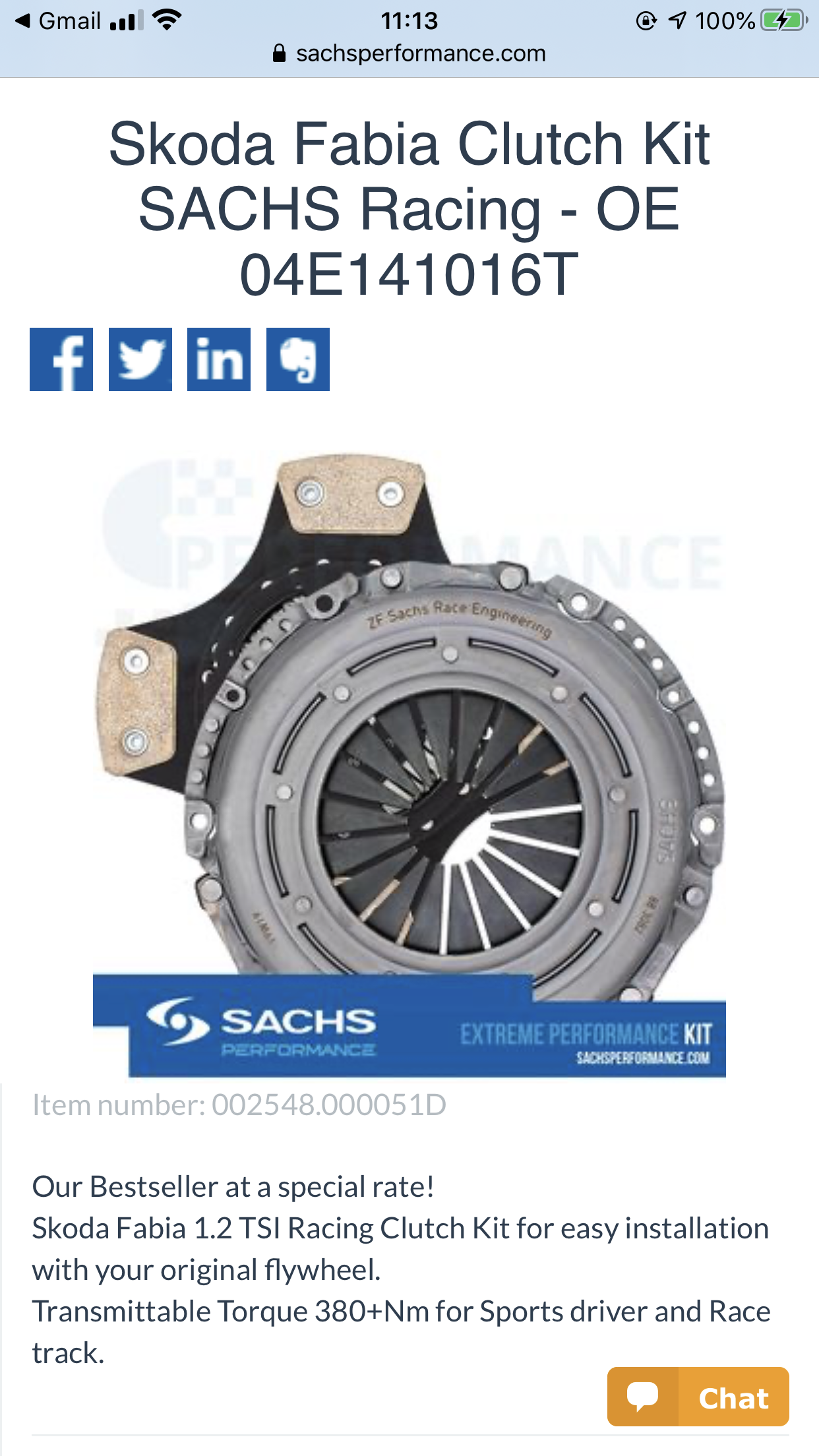

I've found these boxes are both DQ200 (5&6spd) and are supposedly rated for 200nm, from what i've seen this seems to point to the clutch they are paired with moreso than the box itself. The standard clutch is a 200+ one, and can be uprated to a 280+ or even one rated for over 300 (might have been 380+ cant remember off hand, sachs website is a bit rubbish for finding info.
I don't think the 1.2 will put out a whole lot more than 240nm torque even if you tried. Any dyno graph ive seen thats where torque peaks at, bigger turbos just alter the power curve, holding the torque to higher rpms resulting in more power. Maybe a tad more but not a whole lot.
edit: it is 380+ for their big boi clutch0F49DD9B-8BFA-4FE1-89E3-0F93441EB4D0.thumb.png.34d58a6d58fa8639875c1bc62c73fe18.png
Edited by FabiaGonzales
thank you very mach for the info. I think it would be best to fit the higher rated clutch, before adding more power
The intermediate one would probably be more suitable than the paddle type 380+ one pictured above
