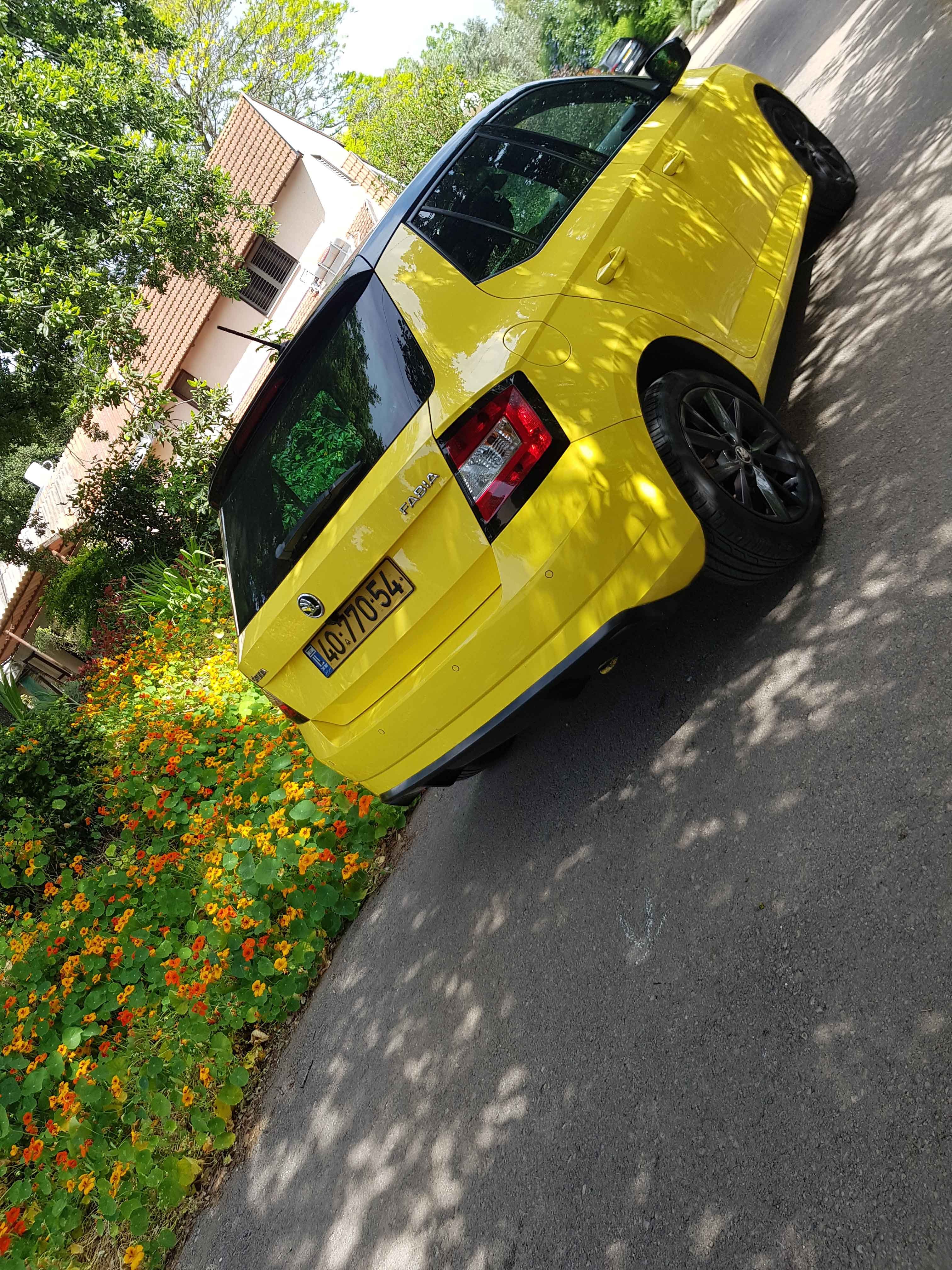

Have Just obtained the Turbo and found a nice spot so took a pic 20200515_093003.thumb.jpg.5ae9dd172b159304da19c9ae2fbf8834.jpg
That's a brilliant spot, not often to see a yellow car nowadays either, contrasts well with the black roof & wheels though, really nice!
Mine needs a really really good clean and wax before i take another picture haha, the best it's had since january is a few blasts with a pressure washer
