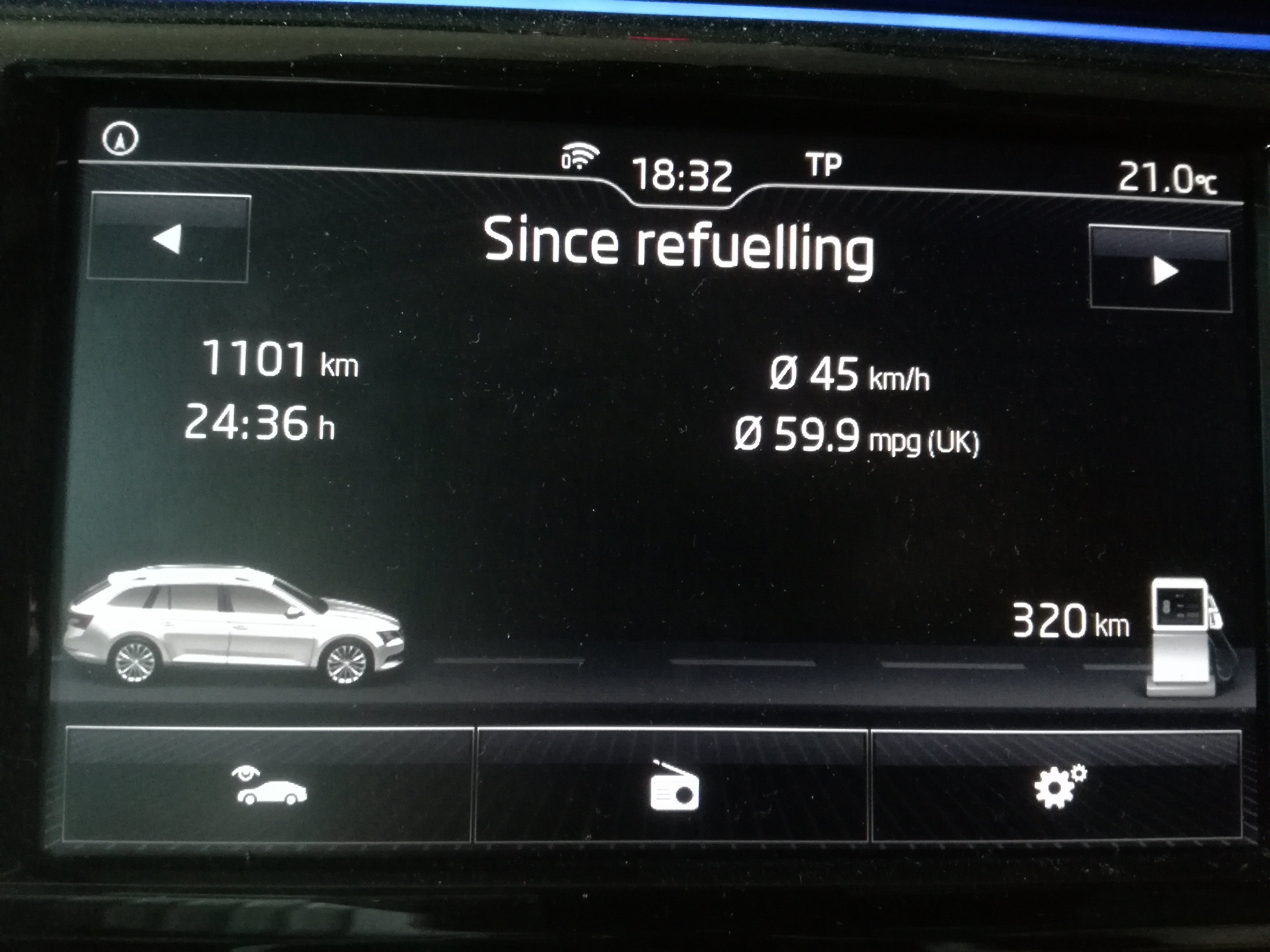

On the return from Mansfield to Kent (after the remap) my Superb was showing 60 MPG... at NSL with a few blasts from standstill to see how she went.
I’m sure if I could be bother to look at the average MPG over 2 miles @ a steady 30 MPH it would be stupidly high (the faster you go the more fuel you use), however as that would be pointless I don’t bother.
Just demonstrating petrol engines get to peak efficiency much quicker than a diesel. Owned a 1.4TSi ACT Superb in 2016 and best on my 27 mile commute was 64.6mpg and best tank was 800 miles just commuting, no long journeys. It consistently gave an average of 50mpg.
