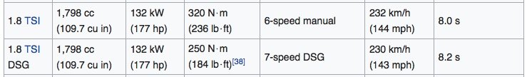

It looks like it'll be a 7 speed DSG:
And without knowing for sure, I'd think it likely to be the DQ200 dry clutch unit.  The DQ381 wet clutch from around that time, was, so far as I'm aware, destined for the more powerful vRS & GTI's - happy to be corrected on this though, as I'm not 100% certain.

I have no idea about the 1.8 TSI Superb with 132kw,
but the DQ200 was used on VW Polo 1.8TSI GTI's with 132 kW in 2015.
