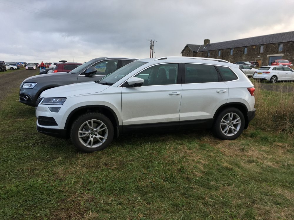

Or you could get yourself another set of wheels with winter tyres.  I think I paid £350 for these Audi Q3 alloys complete with good Pirelli Sottozero M+S from a guy on the Facebook sales page. I believe he'd paid about £1300 for them, supplied by his Audi dealer. The Pirellis weren't great and they've now been replaced by Dunlop Winter Sport D5 as seen here. In my experience, albeit on our previous Tiguans, these make the car pretty unstoppable in anything up to 12"of snow.

I did that with my Golf Plus, and kept them to use with my Golf SV. (They're too small of course for the Karoq). But I switched to all-season last year after I did my back in changing them over, and the Conti winter tyres became time-expired rather than worn out.

I know that feeling.  I put a set of new Michelin Crossclimate+ on the Yeti which I bought earlier this year.  Those Audi Q3 wheels had already seen service on my wife's previous Tiguan and there's still a set of old, 16" aftermarket alloys with Tiguan size D4 Winter Sports on them sitting in the garage.  Then there are two sets of alloys for my Golf; the original 17's and a set of Audi A3 16's with Kumho winter tyres on them plus another spare set of Audi 17's that need refubished.
My next door neighbour who tunes and competes in Subarus was good enough to swap over the wheels on the Karoq and the Golf a few weeks ago in deference to my ageing back.
